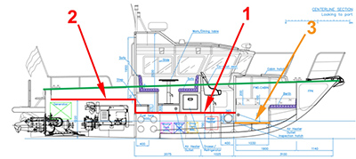

    For those lovers of classification societies, and those who believe that they always improve safety. My favorite sample - 10m patrol boat under RS class (class was required by the tender, otherwise we would never go there).
    On the centerline section, once can see aft deck level (2), saloon deck level (1). While reviewing the design, senior RS surveyor treated saloon deck as 'watertight deck' and requested us in writing (attention!) to provide draining ports from saloon deck level (1) to overboard. Note where saloon level is, and where the waterline is.
    I am sure someone here will explain that this is 'statuary requirement', in another lengthy post. But actually, this is unsafe and dangerous. Only idiot (or senior idiot?) could require such rubbish. Classification society should have common sense, not operate with rulebooks only. So, what happens if we follow this requirement and do this?? Increased safety??
    Unfortunately, I saw quite a few surveyors like this, thus do not have much trust in classification :)
