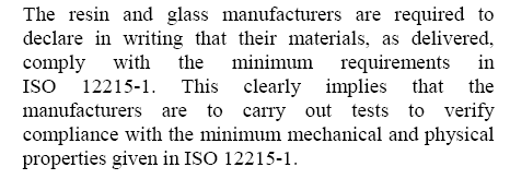

    2AdHoc:
    OK if so yes I agree, the administration is very different. Classification Societies are actually making profit on certification of everything, some of them will certify every screw that goes into the boat. The same refers to the materials. The more calcs and tests they require, the money they get - very simple. It is not directly related to safety but more on increase of income. Tell me what responsibility classification society takes :)
    In ISO, they declare minimum properties to which the material should comply. It is the responsibility of designer/builder to use materials according to specifications of the manufactures.
    On other side, ISO standards are much better in terms of usability, as they are written by practicing specialists, in collaborated way. Rules of Classification Societies are often written by narrow groups of theoreticians, with a lot of errors, omissions and impractical design approaches.
    So, my opinion, to tell it straight: class rules are developed to screw shipbuilders; ISO are developed to help boatbuilders :)

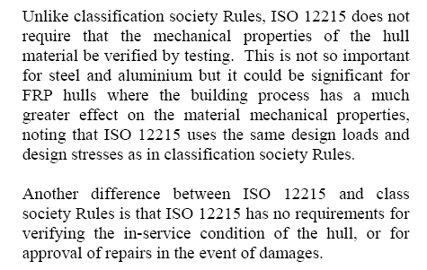

    Indeed, and that is exactly the point. Just like when you buy a car say like a Ferrari, if something goes wrong, you want a genuine part fitted, rather than a cheap knock off alternative.
    But who says the cheap one won't work...and that's the point....it's cheap, take your pick, and accept the consequences. But if the cheap one fails and causes even more damage, that's when it gets expensive, as Ferrari will walk away and say you fitted a non genuine part.
    That!
    They ensure that type approved means just that. So, take an M25 Class 70 S/Steel bolt that is made in a mill which has been checked audited an approved that the metals are what they say they are, the processes to make them and the testing to ensure quality and minimum properties are satisfied. But you could buy a shiny looking M25 bolt down your local shop where the owner says he buys in bulk from China and has no idea what grade they are. So, when you buy that more expensive bolt...it comes with the seal of approval that it does what it says, or buy the cheaper one..and you have no idea if when you torque it up...it'll fail or not. Everything in life costs.
    So does Class.
    But they also make sure you buy from type approved sources to guarantee those mechanical properties.
    ISO does not, as noted above in the quote from ISO, and your comment too:
    So, Joe Bloggs can cut corners to make his 5m RIB, because he bought knock off ally from some bloke down the road. It is shiny it is ally, what more do you need to know? No one checks it for compliance...as that is not ISO's role!
    Just use the rules, oh yeah, the rules you have to pay for too.....whereas most Class rules are now free.
    Where only 70% agreement between all those bodies is required...and can be altered by local authorities too. Hardly common agreement.
    Nope, they are written from feedback from inservice vessels and R&D spent to refine and improve the rules, where needed. And, like LR, have a group of non-LR staff to independently review the rules to ensure it makes sense and has industry feedback prior to being issued.
    ISO as I said from the ouset, is for small boat builders not wishing to use Class, which requires far more compliance to ensure traceability and adherence to standards from the drawing board to the final product and everything in between. Just like a car.
    If you haven't seen the 12215-2018 rules yet, it is getting even worse and trying to muscle into the Workboat side...and it is a mess.

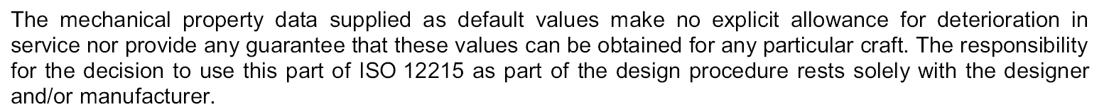

    That's for you as the designer to establish. If you don't know the behaviour of your design and what it can or can't do...who does?
    As noted from ISO, also above but with the emphasis highlighted:
    The structural design rest solely with the designer, not the rules per se.

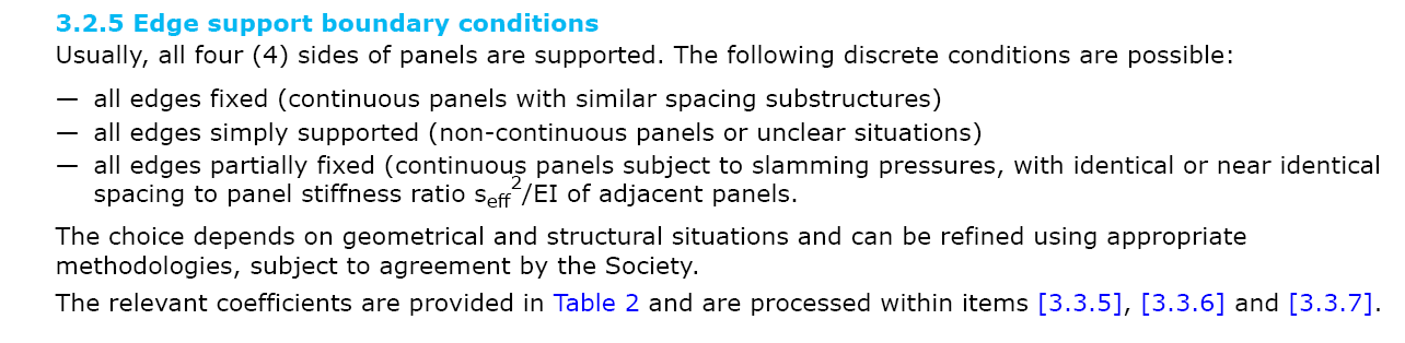

    No, I am talking about design pressures in DNVGL.

    Regarding Your references that ISO12215 does not require validation of mechanical properties, and classification society do. This is not true.
    ISO has 3 methods of establishing structural properties of materials: method a) is testing, method b) is testing of glass content only, method c) is no testing, but 20% margin to structural properties established by empirical formulas in ISO12215-5 Annex. So the designer can choose any, if it fits in project's budget. Regarding classification societies, not all of them require testing. Say, we just did composite project to LR without any testing, using formulas for structural properties from their Rule book (besides all, those formulas are almost same as ISO). Another example: GL HSC2012 rules is using CLT method for structural properties of composites, without mandatory testing.
    This is all described in my paper published by SNAME/CPBS2014. Those on RINA meeting probably should read it :)

    It is not a pressure.
    It is, as noted, just a more representative way of showing/establishing end fixity of a panel/structure. That's all. It has always been there, just presented in a different way in the new rules.
    For ref, Pt.3 Ch.4 Sec.6:
