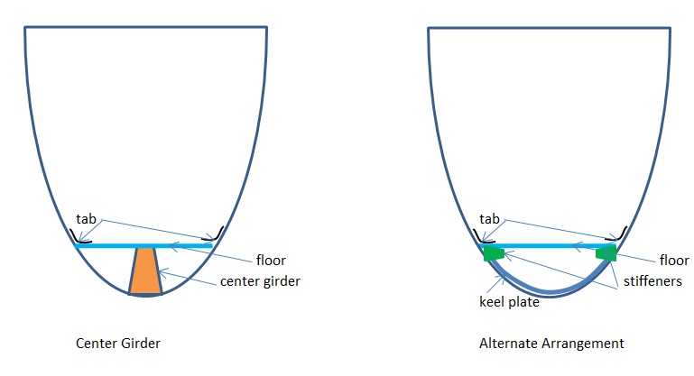

    The primary structural arrangement is as shown attached. The crossbeams are supported by bulkheads/web frames, inboard/outboard girders (or primary longitudinals), and center girder (note that center girder can be eliminated in small boat provided an alternative structural arrangement is made). Following LR rule, the primaries must be supported by a bulkhead/webframes spaced no more than 6 meter apart. These are primary structures and is sized such that its effective length is the distance between the bulkheads. Where it ends, discontinued, or terminated, it must be bracketed (soft toe or hard).
    The side longitudinals (secondaries) are to be continous and supported by bulkhead/webframes/ringframes. It is sized by the distances of the supporting transverse, not more than 2 meters. It must be tabbed to the supporting transverses and bracketed ONLY when it is terminated. LR rule, others may vary.

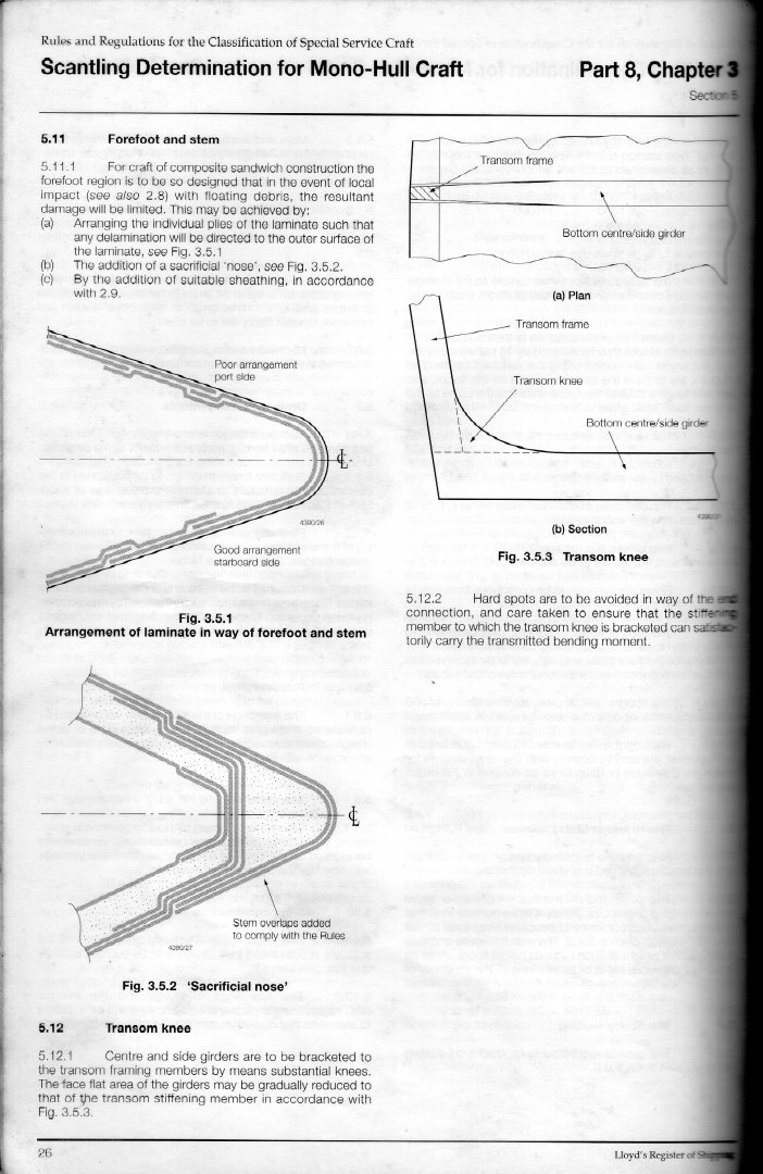

    The sacrificial nose can treated in a variety of way provided it can withstand the slamming effect;
    1. Using a solid foam cored laminate.
    2. Using a honeycomb core so that it disintegrate on a normal (horizontal) impact.
    3. Arranging the laminate in a single skin layup so that it spreads outward on impact.
    4, A combination of any.

    Rules vary. Stiffeners are secondary elements that is meant to stiffen or provide support to a plate. There are rules that apply and defines it as "intercostal" or broken. The primary use is when it is used to stiffen the top of a hatch cover where it stops before the bend of the plate. If used as a side longitudinal, LR defines it as continous and connected to the transverse(s). Perhaps there are other uses of the term "intercostal" that I am not aware of.

    It just means it is not "connected" to the primary supporting structure.
    As such, structurally, it changes the bending moment and thus end conditions.
    So it goes from a built-in at both ends, M = q.L/12 to a simple-support M=q.L/8...so the BMt is greater and as such the longitudinal must be stiffer.
    Then you just need to ensure the dfelections are not greater, mid-span, and also at the ends, the terminates are not stress concentrations.

    I'll start with the conditions: worstcase is a collision with a heavy object on one of the hulls in such a way that the boat is not able to shed collision energy in turning. Eg the other hulls crashes into the same object. In this case it is necessary to limit the load to keep the essential boat structure intact. The question what load this should be is not answered yet. I worked the other way around: because of the length of my workshop I have to build the hulls in two parts one being the nose of 1,5 meter. Because of this structure it is reasonably easy to sacrifice the nose. 1,5 meter if necessary, 0,75 meter is another option. The deceleration from 20 knots to 0 in 1,5 meter leads to a force of about 72 kN.
    Ofcourse I do not want to break the nose in normal conditions. The design side load is 23,4 kN/m2 (ISO, I started reading Larsson! Should have done that a year ago :$). The most forward weak spot should be at 20 cm from the nosetip as this has the least width. When it breaks at this point the unsupported plates will break until the next bulkhead (or further). The load on this 20 cm tip is 4,7 kN. The next bulkhead is 75 cm from the nosetip. With a weak spot at 80 cm the load on this section is 10 kN. The bulkhead after this is at 150 cm and is a double one.
    Breaking is dependant on the angle of the collision as combined bending/ kink (is this the right word?). I wanted to calculate the necessary moment of inertia for both situations but the numbers don't make sense yet... TBC in short term now!.
    Another aspect is that I partly finished the nose. Inside laminate is 800 gr triax. My idea was to cut a groove in it and make the total sandwich thinner. Which is another method as the method proposed by RX based on laminate shear. Would that work? Ofcourse cutting sections of the nose is no problem.

    Once you have calculated the strength of the forward hull, you now can analyze the impact of collision/horizontal shear and design it if you want to shear at the connection or allow it to disintegrate. Most sacrificial nose is only 5% of the length of the hull or starting from a collision bulkhead. Note my previous post by LR.
