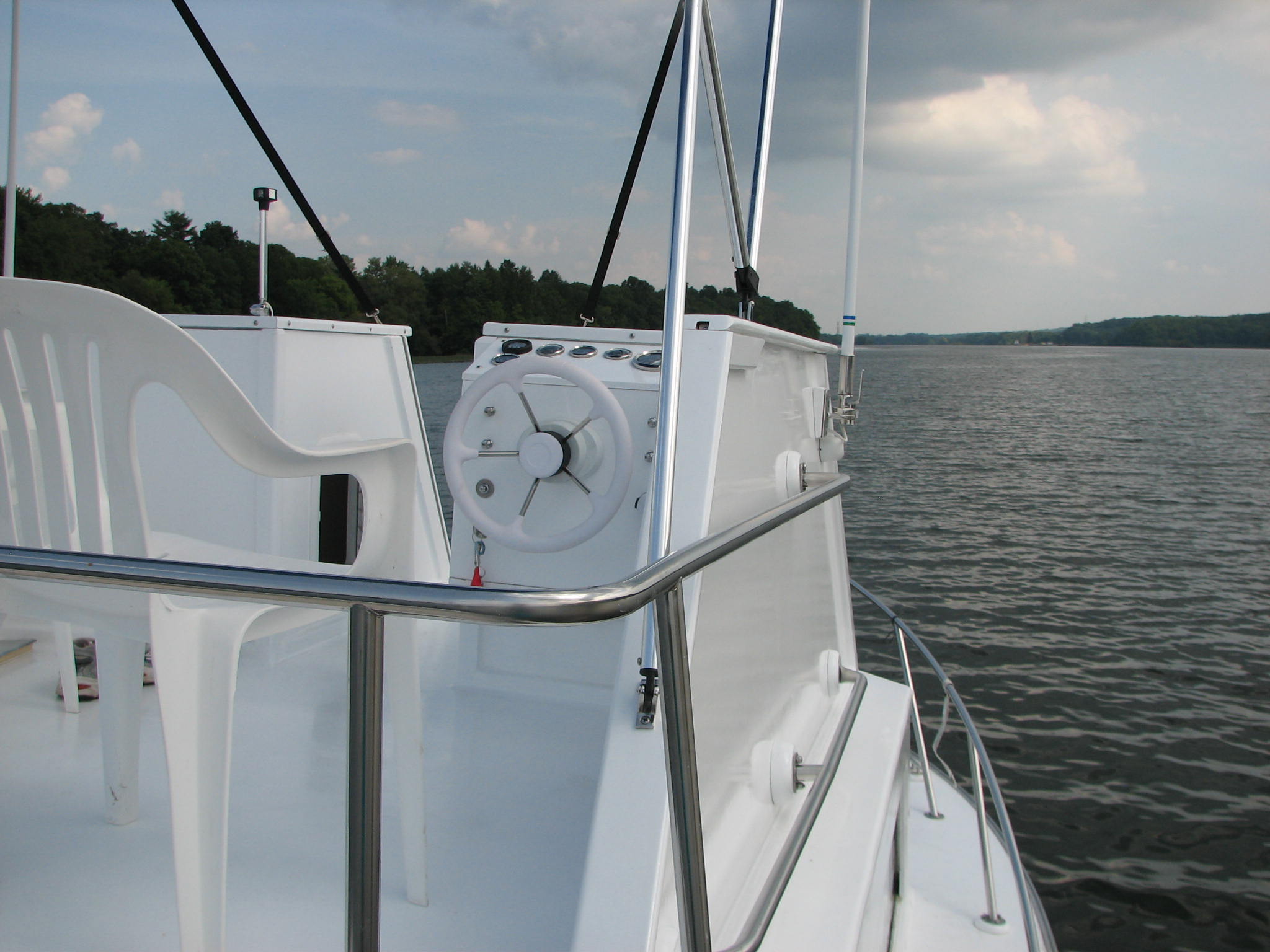

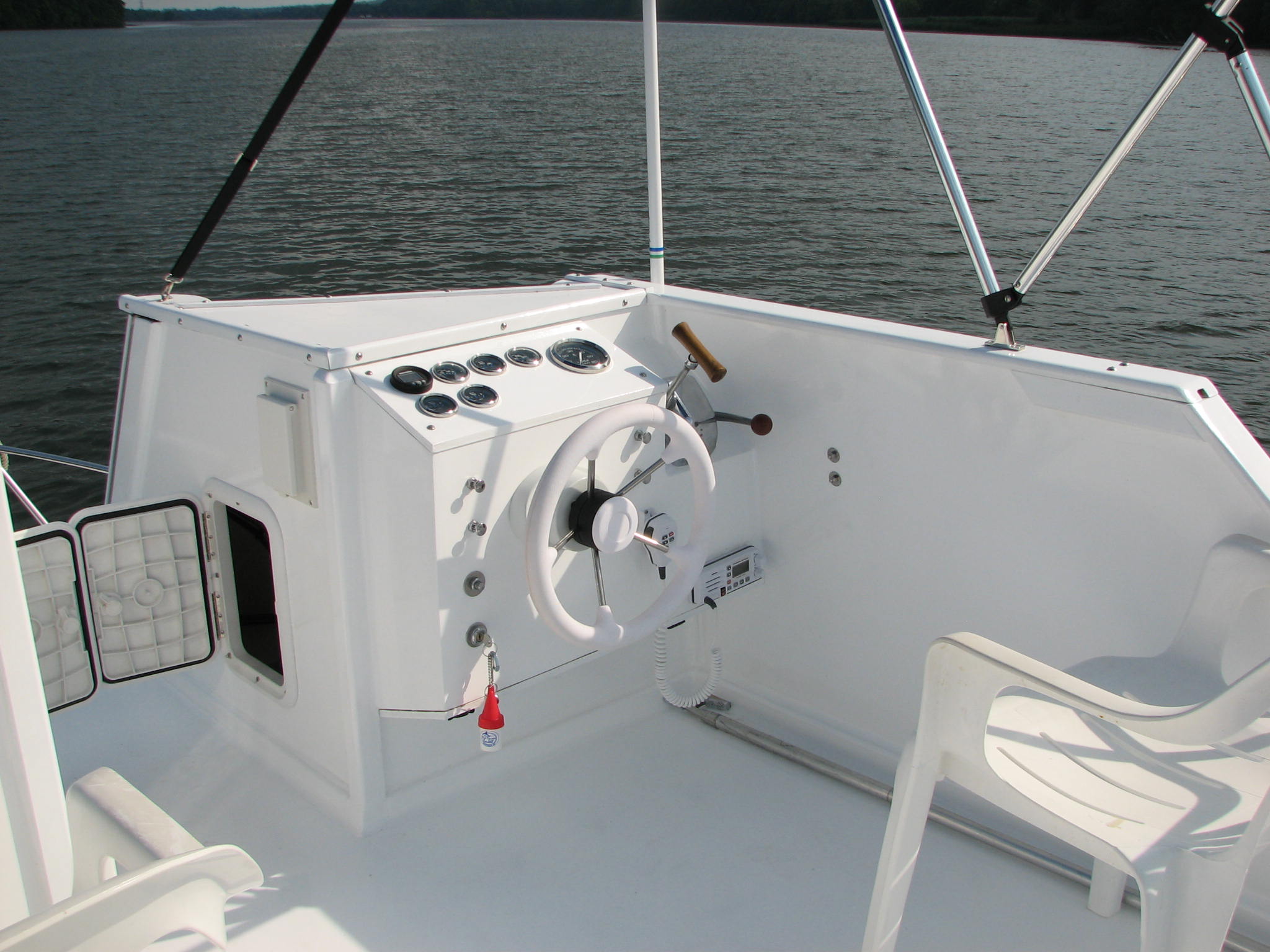

    I cannot speak to the longevity of the water based LPU's. I played around with a sample from System 3 years ago but didn't end up using it.
    I've used solvent based LPU's (Interlux Perfection) exclusively on my boat and am very peased with the results.
    If you use white or light colors you will get great results with the solvent based LPU's without any tipping, they level out very nicely. As for non skid I've always used Interlux Intergrip non-skid additive. A little 1/2 pint can goes a loooong way, just put it in an old salt shaker and sprinkle onto wet Perfection and you're good to go.
    I understand your concerns regarding the solvents but my understanding is that it's the isocyanates that you need to be concerned about and they do not become airborne when you roll the paint on.
    Read up, follow the instructions to the letter (especially surface prep and priming) and you'll get a great finish. I hear horror stories about these paints often. I always find that people don't prep properly, don't follow the instructions and especially try to apply the paint too heavily or thin the paint too much. The expression "less is more" is true with these paints. Thin coats are best.
    Wear a decent 1/2 mask respirator and gloves and work carefully. You'll be fine.
    I'm strictly an amateur but swear by these paints. Pricey? Sure, but they hold up. More time boating less time painting. I understand that they're not for everyone but you really do get what you pay for.
    In the pictures below all you see is Snow White Perfection. Rolled and brushed along the trim. Not tipped and not sprayed. The boat was painted outside under an a-frame type cover (tarps).
