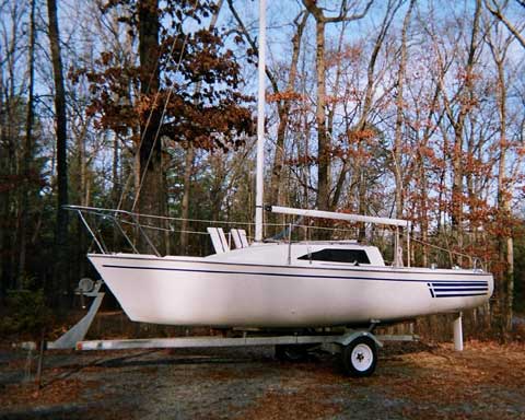

    Near the beginning You mention that the boat you sailed, kept rounding up. If you look at what looks like a publicity photo for the boat, were you seated like that? If you study that photo, you can see antifouling at the bow and see the stern is low and dragging.
    You should sail that boat, like most small cruisers, by sitting as far forward as possible, getting your weight as near over the keel as you can. This will tilt the mast forward (or rather, less backwards) and reduce weather helm. If you intend to race I'd definitely remove the outboard when finished with and stow it up in the bows, as I used to do racing an 18 footer.
    Don't be tempted to store heavy materials in stern lockers either!!
    Deciding to tilt the mast forward and sitting as per the photo will destroy your windward ability.
