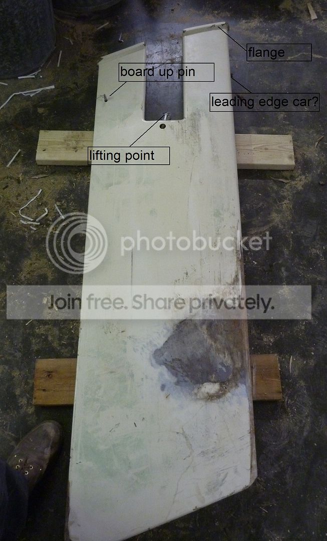

  6. Bigfork
    Joined: Dec 2009
    Posts: 77
    Likes: 10, Points: 8, Legacy Rep: 17
    Location: Montana, USA
    Bigfork Junior Member
    Canracer,
    Some dagger pics...I realize there is a lot of dagger work to be done as well (ignore the ground and glassed bit in the lower middle, among other things...if you can. I'd like to fiddle with that later). I imagine that the dagger doesn't touch the upper 2/3rds of the sleeve, aside from the top flange which centers the upper section by riding on the fore and aft skids. Once the dagger is in deep enough, reaching the lower tight 1/3 of the sleeve (which it never really exits unless being fully removed), it is constantly held by two forces, the lower 1/3 of the sleeve and the top flange which rides the skids in the upper 2/3rds of the sleeve. When retracted fully, there is still 10" showing through the bottom so during normal use (up to trailer and down to sail) the bottom never leaves the lower snug 1/3 while the top flange rides the skids...
    In the pic of the dagger in but up, you can tell the hole is over sized (the dimension of the top 2/3rds of the sleeve), allowing the flange to descend.

  7. Canracer
    Joined: Aug 2009
    Posts: 620
    Location: Florida
    Canracer Senior Member
    It looks like the dagger rides along those rails using only that one little "car" at the top of the leading edge. Wow, is that right?
    You might have some missing pieces (cars.)

  9. Bigfork
    Joined: Dec 2009
    Posts: 77
    By "car" you must mean some sort of wheel/bearing (fore and aft) that guides the flange down the skids...? As visible in the pictures, the flange has seen some dings and previous owner grinding attempts. The aft edge of the flange (trailing edge) shows a notch where it has had to fight over the mismatch proud screw in the sleeve's skid.
    Some sort of bearing or car seems logical, but I don't think there ever has been one there. As far a I know, the flange's fit must be tight enough to offer the guidance needed...too much guidance as the leading corner has been ground back in a past "fix".

  11. Canracer
    Joined: Aug 2009
    Posts: 620
    Location: Florida
    Here is what I think I see.
  12. Bigfork
    Joined: Dec 2009
    Posts: 77
    indeed errant floor debris. No cars. Both the leading edge and trailing edge are straight shots aside from the flange.
    Silly question, should the out dagger be sitting in a scribed form in two or more places or is it ok to live on donnage on the ground as pic shows? Funny, I can pick up the top end solo, but two grown men can just barely budge the bottom...That things got some lead in it!
    thanks for the advice canracer! What do you think about the aforementioned sleeve skids? Do I try and tap stripped screws/remove them?

  13. SukiSolo
    Joined: Dec 2012
    Posts: 1,269
    Likes: 27, Points: 0, Legacy Rep: 271
    Location: Hampshire UK
    SukiSolo Senior Member
    It might be brutal, but possibly the best way to get the skid rail screws out is lever the skids with a 'jemmy' or crowbar. Even if it destroys the skids. It will either remove the screws, or pull the heads through the skids - better access to screw shaft for removal. The screw holes can then be repaired and reused or new spots used and good high quality fasteners used.
    I see you have discovered how awkward moving a ballasted daggerboard is...;)
    It won't come to any harm sitting on it's side, or if it does the layup is too light for sailing anyway. If you look how some other craft, admittedly much lighter, line their cases, you might see otherways to eliminate play. The 49'er uses velcro and some weighted daggerboard craft, carpet. I would not be surprised to see short astro turf being used. One consideration is sand and small stones along with weed. If it can get in there, it will, and it's best to let it get out as well. Worth considering the front edge (of board) condition is pretty important for decent performance so damage on it should be minimised.
    The skids you have should be either acetal or nylon, both are self lube polymers to a reasonable degree. They (above plastics) should also be available in section form from good plastic stockholders. Possible to machine on woodworking tools with non ferrous blade (saw) and drill and rout. You will get a small ammount of 'spring back' so be aware of that ie drilled holes in deep material will in fact be slightly tapered.
  14. Canracer
    Joined: Aug 2009
    Posts: 620
    Location: Florida
    I see that large wear spot on the side of the dagger and I'm very surprised that there is not some corresponding damage on the inside of the trunk.
    If you can see an obvious problem with the skid, and the damage it caused to the foil, then you have to fix that spot on the skid. It's probably not important to replace the whole thing.
    I might be tempted to remove that bad fastener from the inside of the boat. Yep, drill it out from the pointy end. What does the inside of that trunk look like?
    It might be easy enough to cut a 1/2 inch piece of plywood to the same for and aft size as the foil and try moving it past the skids. Know what I mean? Try to confirm that the section of rail that looks bad, really is causing the trouble.
  15. bruceb
    Joined: Nov 2008
    Posts: 1,280
    Likes: 59, Points: 48, Legacy Rep: 214
    Location: atlanta,ga
    bruceb Senior Member
    Ideas
    I like the idea of the trial piece of ply, and take careful measurements of the board to determine where it is really sticking. The rails are better than many boats have, but I wonder if the rear of the board is somehow wedging between the aft rail and the trunk. The worn area at the lower back of the board looks strange. I sort of wonder if the rear rail is even necessary- a contact pad right at the bottom of the trunk might be all that is needed. All the weight is on the front of the board when it is sliding up and down, or at least it should be.
    As I remember, (but I am old :mad:), those were built with about 200 lbs (or more, latter) of ballast low down in the board, but it might not have been solid lead. US yachts mostly used cast iron in their regular keels, and board boats from that time often used steel or lead shot mixed with resin to pour in the hollow board. The boards would then swell a bit down low and cause all sorts of problems. I remember having to grind down several on other brands of boats.
