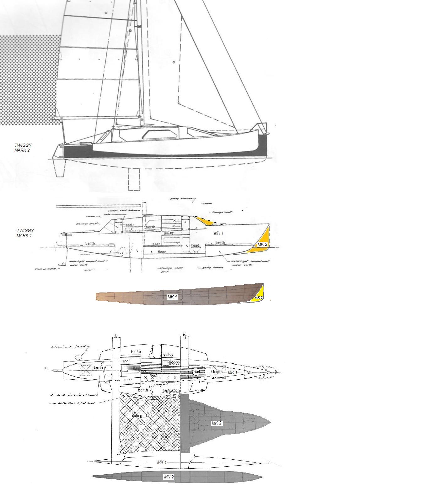

    Took me a while but here it is :)
  4. Twiggyman
    Joined: Jan 2013
    Posts: 14
    Likes: 1, Points: 0, Legacy Rep: 13
    Location: Vancouver Island BC Canada
    Twiggyman Junior Member
    Twiggy Mk 2 vs Mk 1
    You may find the modifications Lock made to generate a Mk 2 Twiggy informative.
    He changed to plumb bows, topside flare, cold molded round bilge which gives more volume down low, and he added more volume forward in both the floats and the mainhull.
    I did takeoffs of float frame areas for both versions and calculated volumes for comparison.
    Float displacement: Mk1= 4010 lb, Mk2 = 4950 lb. , a 125% increase.
    also
    float displacement forward of the front beam: Mk1 = 1800 lb, Mk2 = 2500 lb.
    So quite a bit more stability up front.
    If you compare the plan view shape of the hulls you can see the forward shift in volume, and the additional forward deck width in the float and mainhull.
    Using the design racing displacement of 3200 lb, the % displacement of the floats is: Mk1 = 125% , Mk2 = 155% .
    The Mk1 version was intended to fit a Jester class racing rule for max waterline length, and the overhanging bow would have added forward stability to that length. The Mk2 was not intended to fit this rule - so the longer waterline and greater volume forward were included for more stability.
    If you want to modify your Mk1 Twiggy the changes Lock made in the Mk2 indicate how he thought the performance and stability could be improved.
