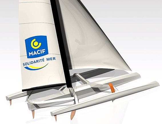

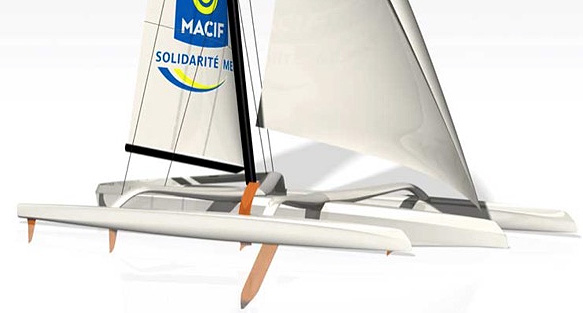

    Take a look at foil and rig positions on the new, soon to be launched maxi trimaran VPLP Macif.

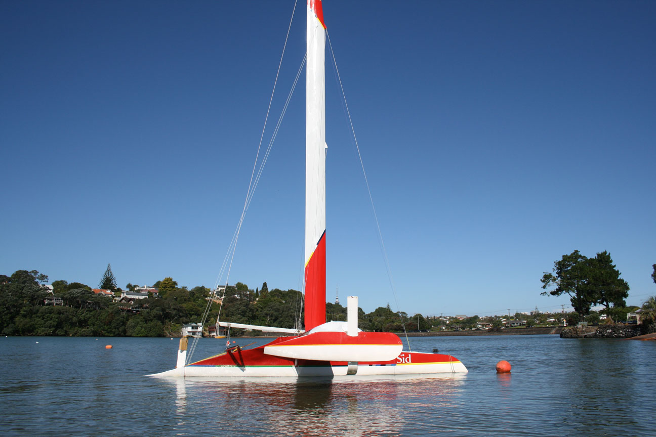

    I'd love to see which picture you refer to rogerf and dated if you have that info
    Ian and Cathy Johnstone sailed long distances to get to race venues, so a heavily laden boat under some conditions would hardly be a surprise -- and is hardly a basis for evaluating the as built weight of the boats.
    My Mk1 (NOT built by me and clearly built from best materials and very carefully as could be seen from her unpainted interior) sat in flat water with one ama more than 18" clear of the surface. That was with Gougeon B-section, 6 bags sails, galley & nav gear, outboard, ground tackle - but no food stores. waters, or fuel. To me that implied the boat was near the 2200# bare weight expected.

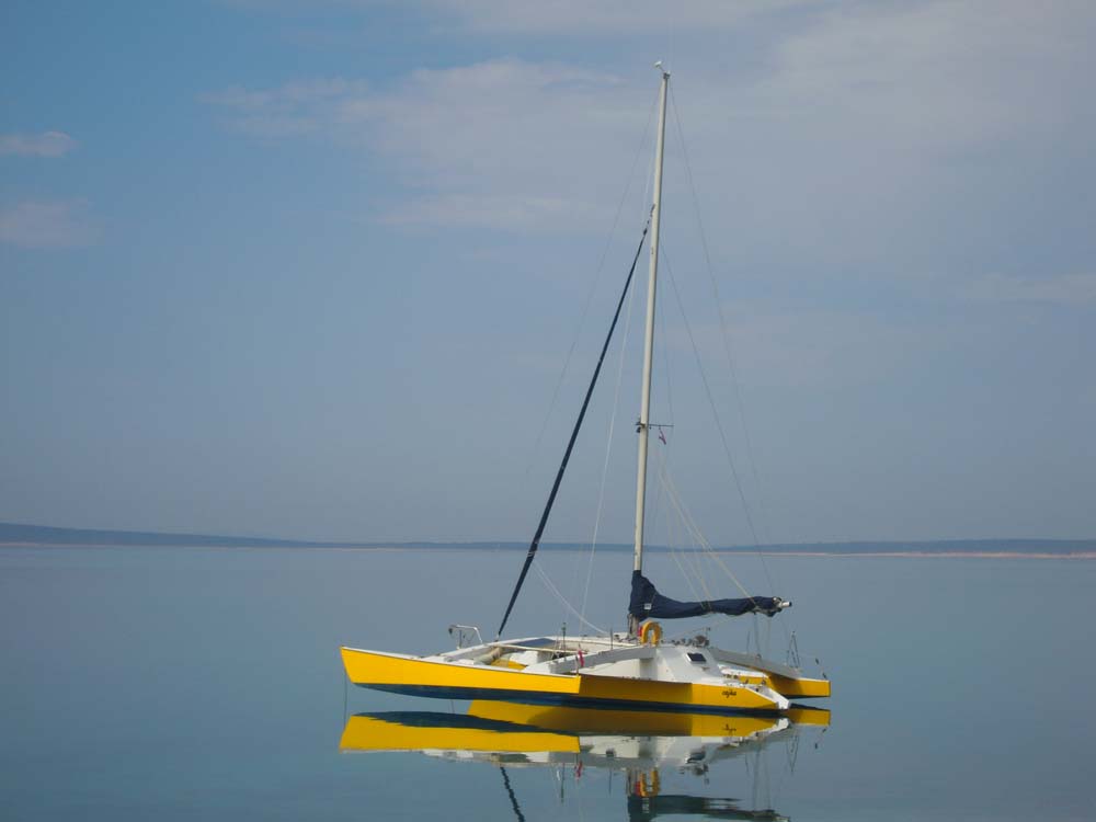

    I just bought a Twiggy Mk 1. I was aware of the aft volume issue but I have a few questions that may be some of you could answer.
    Is an extension of the volume of the amas at the bow making sense ? It will stay marginal en terms of %. The owner of the "Multisailing" Twiggy told me that he once had to throw his Twiggy sideways down some steep 4 m deep, short and violent waves, as he trusted the lateral stability better than the fore/aft stability. His Twiggy has been modified with longer floats, with vertical bow offering more volume but it doesn't seem to really solve the problem.
    May be some of you know of some successfull amas extensions ?
    Keeping the amas as they are, could you advice on sail reduction related to wind speed in a downwind situation ?
    Thanks in advance
    Jean Marc

    I have not owned a Twiggy for 17 years but I will give you a few tips from what I learnt sailing a great boat.
    The Mk1 has a low prismatic hull. It was designed in 1977 when designers were trying to reduce drag rather than cope with power as they did later. As such Twiggy has what today's designers would call fine bow shapes. Lock put on a large rig and tried to get around the problems of having a large rig on a fine boat by moving the rig aft. This gave more forward stability.
    Lock also designed the Twiggy after playing around with some simple computer models. He worked out that if you tacked the boat downwind then the thrust from the rig would always be over the ama - around where the front beam joins the ama. So he put a lot of volume there. You will notice the ama is deep under the front beam.
    Two Australian Twiggys capzized in the 80s. Twiggy went over twice in Europe and Sailmaker went over on the Australian East coast. All times when racing. What is more important is that in all times they were square running under kite and then ran down a large wave.
    Mono sailors will learn quickly to bear away when hit by a squall. When hit by a large squall you may bear away onto a square run - this is when all the Twiggies pitchpoled. I found out something similar when hit by a large front and ran downwind. I was scooping up the waves with the foredeck and filling up the cockpit IN THE HARBOUR. The bows were driven down by the pressure of the mainsail - the jib was blanketed.
    When I came up in the wind to pull down the main as soon as I turned onto a broad reach the boat was well balanced, even and easy to handle. Lesson 1 - never square run a Twiggy when heavily pressed.
    Adding volume to the ama bows is not as important as adding it to the main hull bow if you want to change something. The Twiggy's Achilles Heel is the volume up front and not diagonally. So volume in the main hull bow will assist more than the ama bows.
    That being said - Twiggys being cruised around suffer few effects and I have not heard of any flipping in the last 30 years. Square running is fine if done without an enormous press of sail and the boats love a beam reach in any wind. They are enormously stable sideways. Once we rounded up, rare in a Twiggy as we were under headsail only, and a very large swell tipped us over so that my friend slipped from the windward seat and fell onto my head as I ducked down to help the autopilot from the leeward seat. Then we straightened up and headed off again. I don't know how far we went over but I was glad of the wide beam and easily permeable nets.
