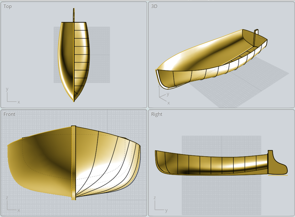

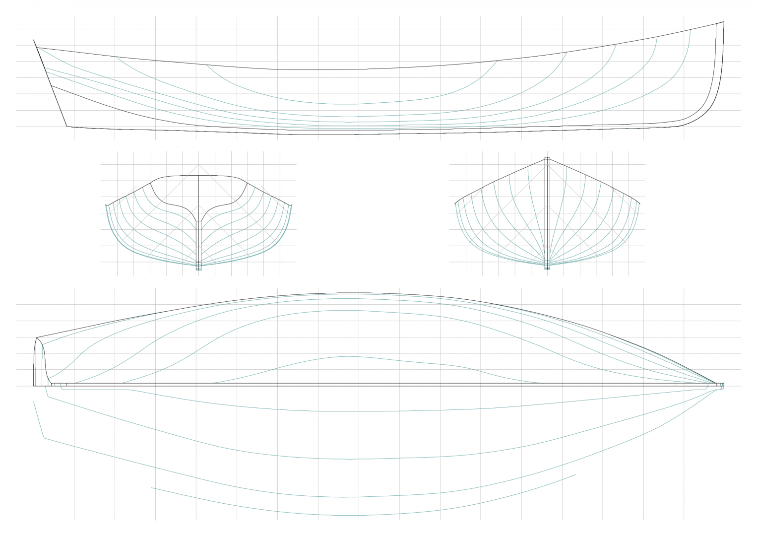

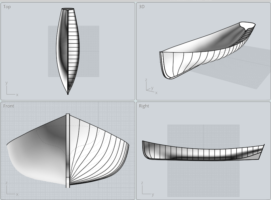

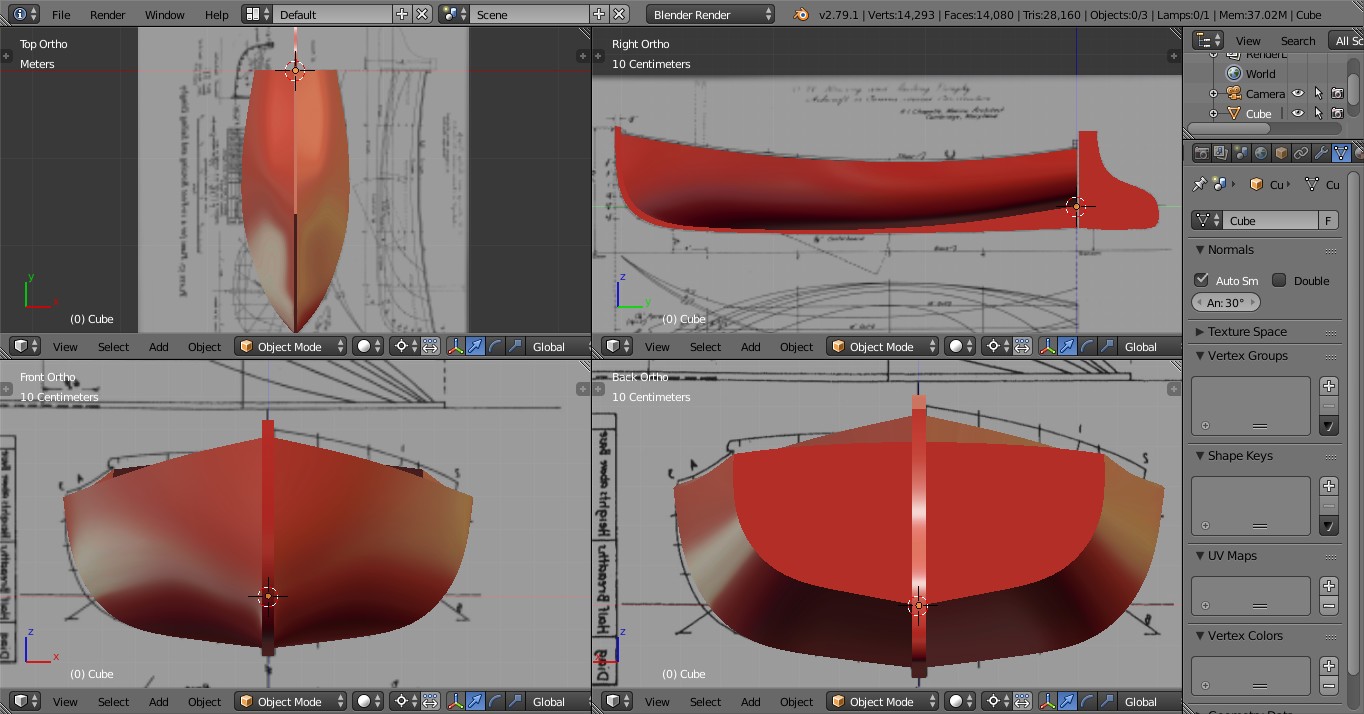

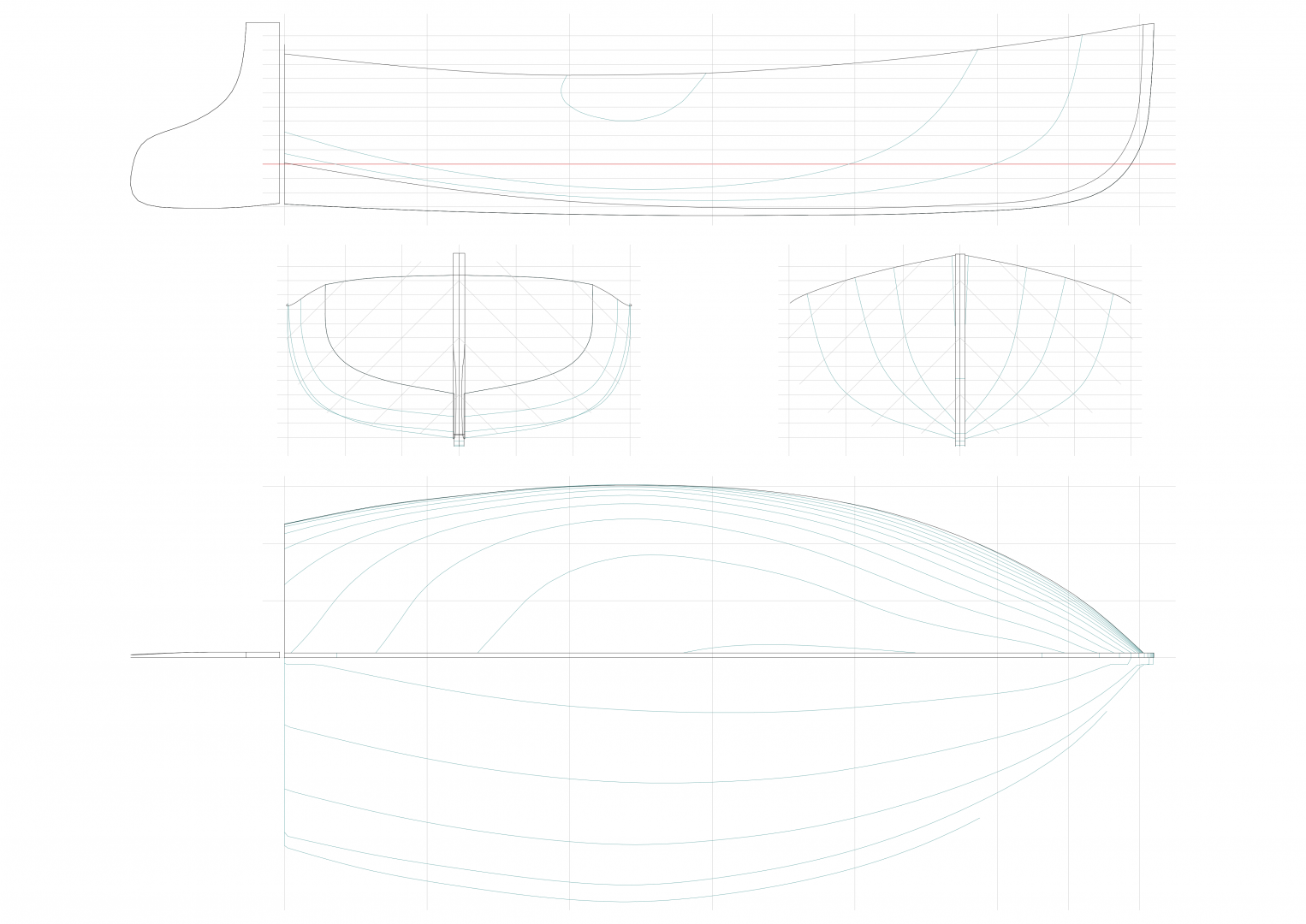

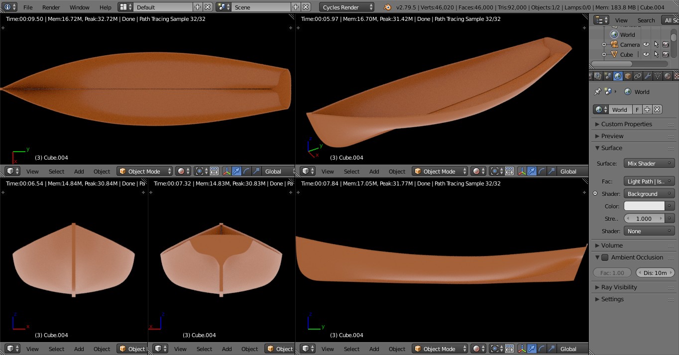

    Hi regarding your question here two examples basically the workflow is with lofting tools but in some cases there the necessity to use surfaces trimming with blending tools or Gordon or even the sweep 2rail it depend from hulls shape, but the problematic of NURBS is understanding them rules, and limits, Rhino isn't an advanced NURBS tools such as for Alias or ICEMSurf, now only in CATIA. but is best in the market at this price.
    The files is old and they aren't without errors, but can help you because in these two there are the curves used for lofting, and these at the moment they are the only that i remade with Nurbs with Moi3D my Nurbs tool for advanced works when I need but I use sometimes.
    Because a feel better for my story with Blender, and these was made before with Blender.
    Chappelle 10ft Dingh
    y <-- link to the files for others app and FreeShip
    Chappelle_dingy_hull.jpg Chappelle-Dinghy.png Istantanea_2020-05-19_10-01-35.png
    Whitehall14ft <-- link to the files for others app and FreeShip
    In files for FreeShip there is some mistake in positioning the on works space, something that understood recently.
    And for other question I suggest to look on manuals of software, there is no magic but only understanding the tools available
