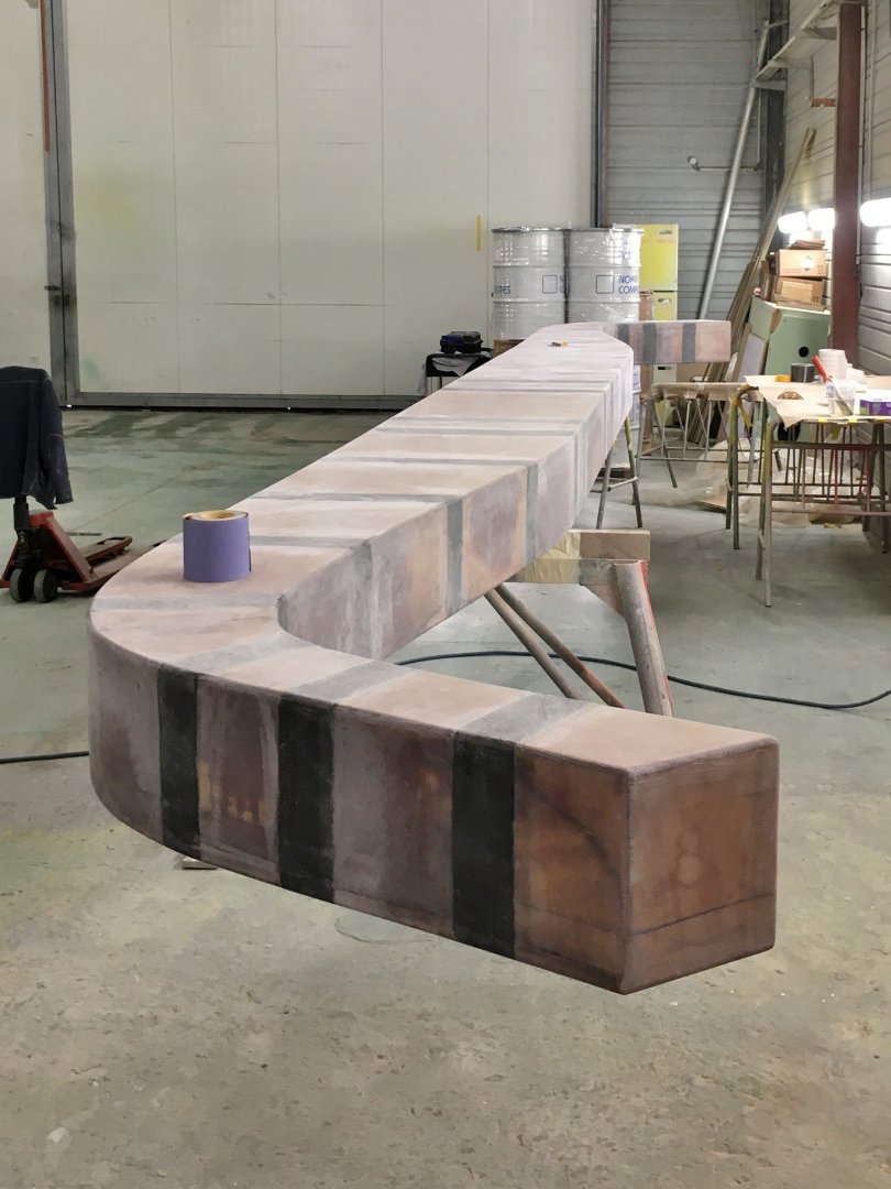

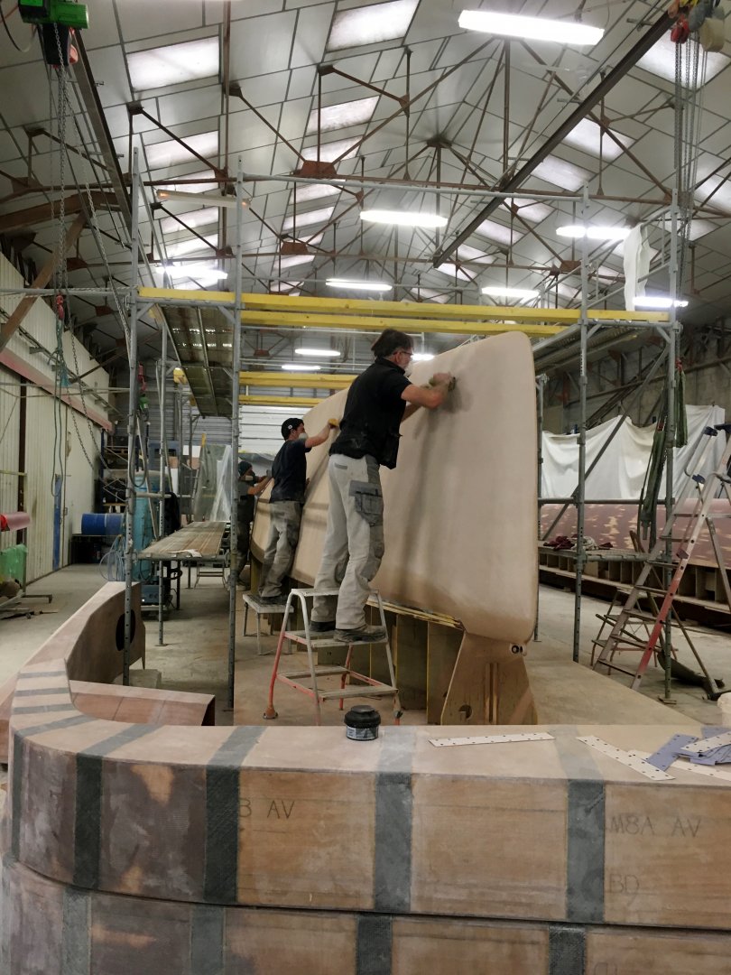

    Pose des lattes du bordé de la coque centrale

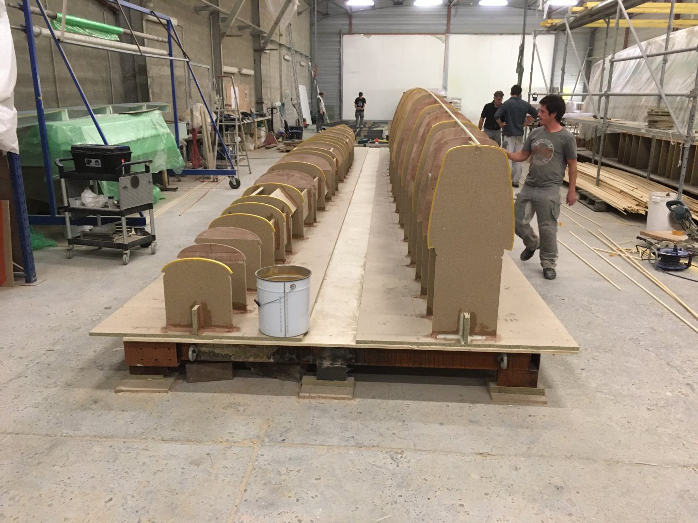

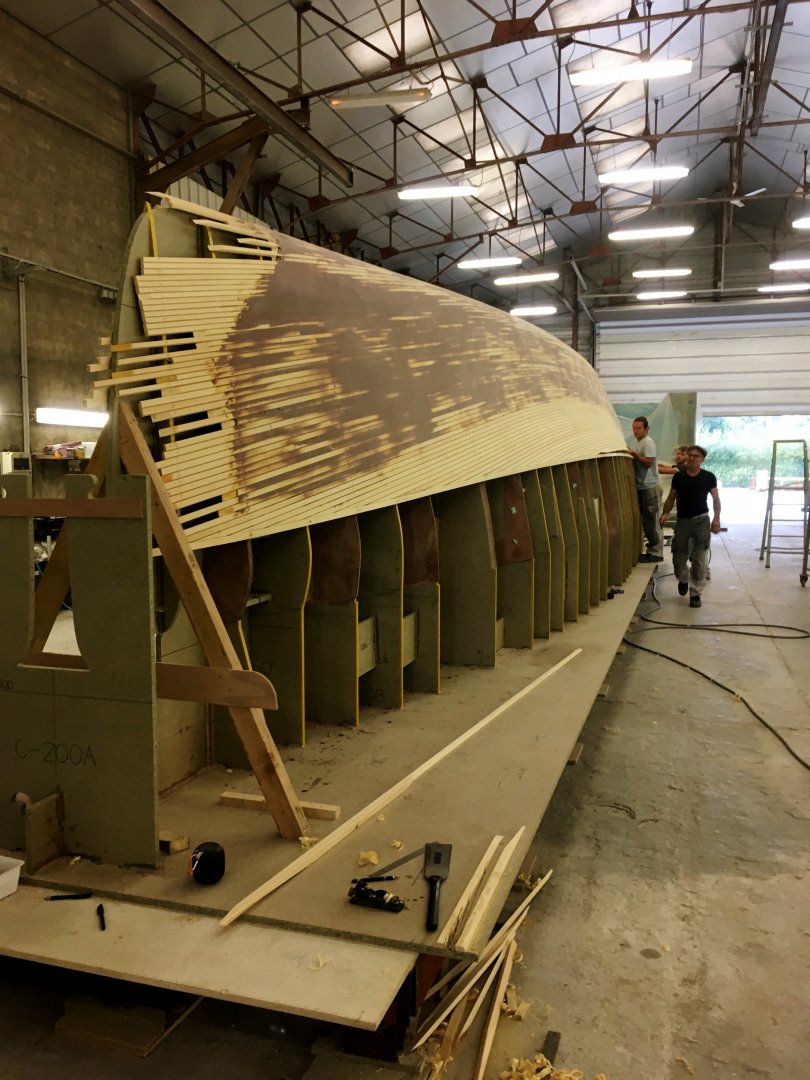

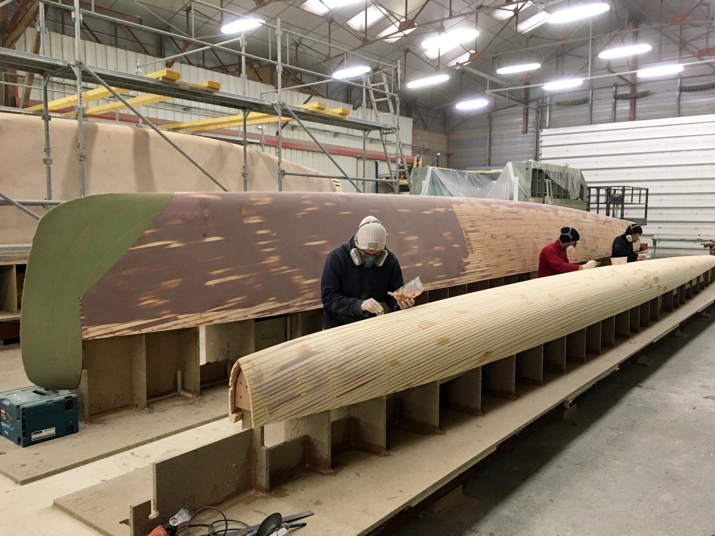

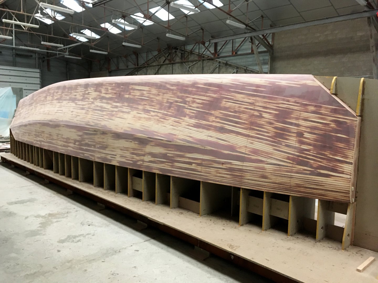

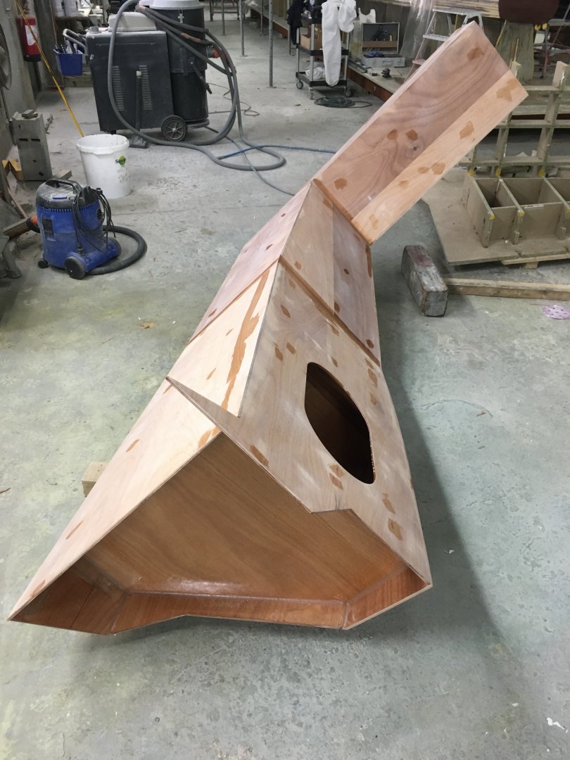

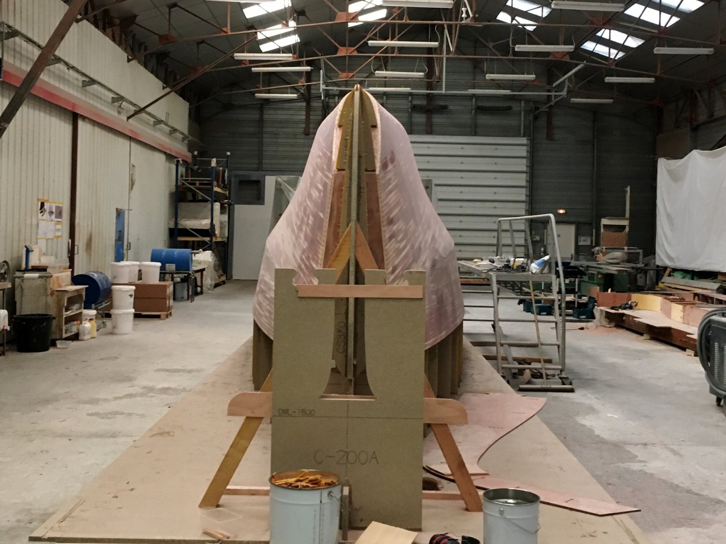

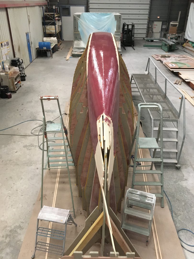

    Pose de l'enduit sur la coque centrale, pose des lattes sur les gabarits des flotteurs, constructions des bras et des caissons du cockpit.

    It is always interesting to watch a boat progress from an idea to a reality,please keep the updates coming.I only have one observation to make and it isn't necessarily a criticism,The rounded outer hulls are likely to be very good for performance but if you are cruising and arrive at a marina where you have to board and leave the boat by a floating pontoon that you are moored to,it might be nice to have a rail perhaps 2cm square to prevent one's feet from sliding off the hull.Having one's wife fall off the boat may not make for a happy ship.
