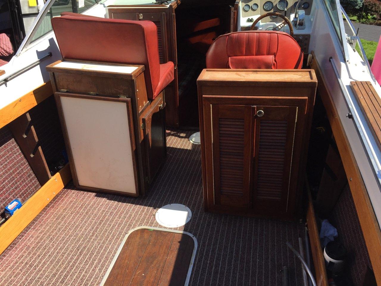

    I can't find the stupid fill for the gas tank on a 79 MT 24' 240 VCC. The 2 circular floor ports in the picture both expose electrical or tube fittings to the gas tank. It isn't inside the rectangular floor hatch either. But I'll be damned if I can find the fill cap. Anyone have an answer?

    Look outside the cockpit on the side decks.

    Gasoline fills are not inside the boat, diesel sometimes are.
    Look inside the hatches, maybe get sight of which way the fill tube runs?

    It is most likely on the side decks, or on the top of the transom. This is so any spill will not enter the boat. Of course it then goes over board into the water, creating a spill, which is illegal, and you will have to pay for clean up and may also be fined. But anyway that's where the fills on a boat that size usually are located. Make sure though that you do not mistake a water tank fill for a fuel fill. Water tank fills are also usually on the side decks. The fills are normally labeled, but it might only be a small symbol in the cap. see Attwood Marine http://www.attwoodmarine.com/store/product/plastic-deck-fills

    Ike,
    Thanks for the reply and suggestion. I found it on the side like you mentioned. It was under the folded down antenna, so was a little hard to see (that's my story and I'm sticking to it :)
