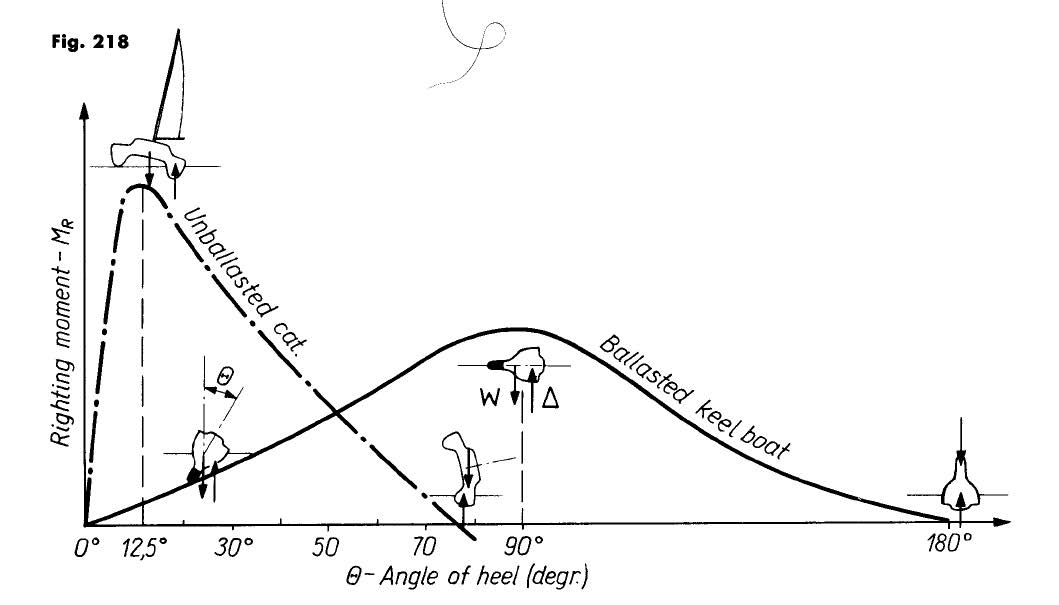

    I asked GB if he is a qualified naval architect to “draw a line” in the sand, simply to ascertain whether “we” are debating with someone with just opinions and “thoughts” or someone with real technical knowledge on stability; obviously the former. We can all opine, but understanding the mechanisms behind such opines clarifies what is what and if one is obfuscating and subverting opine as fact.
    Teddy has already given you the answer. But without more data on the Kiwi 35, I could only guess. Once that line is drawn in the sand, the naysayers will pop up criticising without providing any proof of their own (just as in the endless Brent Swain debates).
    Seaworthiness is terribly complex and cannot be reduced to simply the Righting Moment of a statical stability curve. It is a start but there is far more to it as already noted by MikeJohns and Daiquiri, and I am certainly no expert in seaworthiness, as it is not even defined legally, owing to its complexity. But some simple facts can provide very clear indications even before going setting sail on whether a boat is suitable for certain conditions or not.
    So, lets first address the righting moment. The righting moment is to counter the heeling moment Mh. The stability curve of any hull shall be like that below:
    If, for now, ignore the ballast curve line, you can see that there is a maximum and then falls away to a minimum back to zero and then below this line. The maximum is very important. If you have a hull that has a low freeboard, as in the case of a wide shallow draft boat, the angle at which the gunwales/deck edge becomes immersed is very low. This defines the where the maximum angle shall be.
    Please bear in mind we are looking at stability only for now, nothing else.

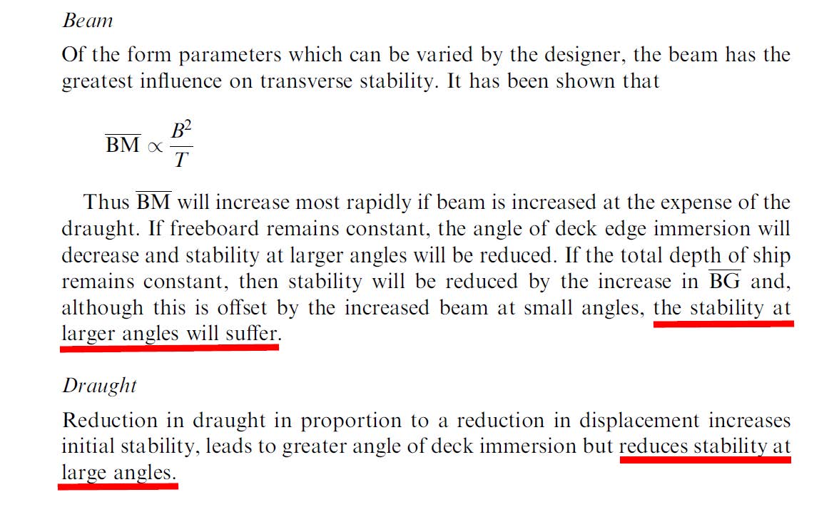

    So, with a wide flat bottom boat the GZ curve will have a maximum angle that is much lower than one with a high freeboard and/or deeper draft. The beam provides additional stability, so it is advantages to have a wide beam. But, if, as I noted earlier, if this is at the expense of draft, the increase in stability is only at small angles, at larger angles it is seriously compromised.
    So what does this mean? Once the boat heels past the max angle, the ability to self right, becomes more difficult. It is the angle of limiting stability. Beyond this angle you must reduce the moments acting on the boat. How do you do that?...you can reduce the heeling moment by reducing the amount of sail area.
    So, if we add deep keel and ballast, what does this do?...again looking at the curves it aids stability. It affects the shape of the curve. It does not alter the angle of deck immersion! Also note that it is a curve with a keel that has volume and hence also adds to the restoring moment, it is not a “dagger board” with a blob of weight, which is subtly different.
    Next we have the dynamic stability of the boat in relation to the wind and its stability on performance. The resistance of any boat is a function of its weight. And if we know that the ability to sail fast must be the ability of the hull to counter a high heeling force (Fh) at the same time as a low angle of heel. This is can be easily described by the ability to carry sail area as a function of its weight. This where it starts to get interesting and terribly complex too.
    Most ballasted boats have a high percentage of ballast to total displacement. But the right arm (RA) of any ballasted boat is zero at zero angle of heel. The increase in RA is slow and gradual with increasing heel. To counter a large Fh, a ballasted boat needs the RA. But at low angles there is insufficient RA, so either reduce the Fh (sail) or increase the RA, heel of the boat. The paradox is that for a ballasted keel boat the maximum RA is at 90degrees (see below). But does this produce fast sailing??..clearly not!
    For a multihull it is different, since the RA is a function of the hull spacing, ie the beam..which is considerably greater than a monohull, again as noted here:
    So, how does a ballasted boat increase the RA…you have a the crew become “live ballast”. So if you can move the crew further outboard, this applies another moment to restore the boat, and can increase the ability to carry sail at lower angles and maintain speed.
    And then we have the boat itself and it natural periods of rolling. This is all a function of the hull shape (roll stability) and the moment of inertia of the boat. The moment of inertia is simply the mass of an item times the distance from the centre of rotation of motion. How close was the period of free rolling (natural period) of the hull to that of the waves? The angle of heel can become very large and can exceed the boats limiting angle of stability and cause a capsize.
    You can change the moment of inertia of a boat by standing up or getting the crew to sit out on the sides, well, this coincides with getting more RA. You can also increase dampening by use of rudders/dagger board. ..if a heavy dagger board this also pushes the mass further away to increase the moment of inertia. But this can also make the motion too stiff, and will thus have a period of motion faster (lower period) than when unchanged by moving crew etc. This could in turn, in short sharp steeps seas move the period of roll to that of the encountering waves, which is dangerous, this is called resonance.
    If the crew experiences excessive rolling due to resonance, they can try 3 options:
    1...change the period motion of the aerodynamic heeling forces., in other words reduce the amount of sail.
    2..change the period of rolling..ie moving crew about
    3..oppose the motion, add dampening and move crew from side to side to oppose to reduce the amplitude.
    The above is just a summary of many contributing and sometimes conflicting aspects that goes into a boats ability to sail and be seaworthy.
    So, going back to the K35.
    The shallow draft and low freeboard would produce a low max angle in the stability curve. The ‘wings’ would provide a temporary reprieve and increase in angle, but then a massive drop off in RA once beyond this angle. To aid and counter this ballast is used, in the lead bulb. But the ability to sail fast needs additional live ballast to increase the RA at lower angles of heel. The increase in RA using ‘live ballast’ would increase moment of inertia and alter the period of motion. The weight of the crew accounts for some 35% of the weight..which is high, ie easy to alter/change m0tions compared to a heavy boat.
    To maintain speed means to carry more sail….oh, it is a race!...to reduce the sail area means the speed would lose a significant amount of speed as all the elements that are finely tuned to increase the RA are lost.
    If the sail area was not reduced sufficiently it is not inconceivable to see how the crew at the sides coupled with a high Fh (gust of wind) pushed the boats wing into the water to submerge it which in turn cascades into a sudden and massive loss of RA. (Traditional ballasted “slow” boats have a more gradual deterioration of stability by comparison and hence time to do something about it). With crew either suddenly moving to the centreline (noting something serious was about to occur) or indeed if one or 2 crew fell overboard this compounds the loss of RA. The hull shape at increasing angles has little reserve of buoyancy, which would be reflected in a poor stability curve after max angle is reached. The AVS may be fine but the right moment, RA x buoyancy would be poor (compared to before the limiting angle)…which is the dynamic stability. Then you have as already noted, the now expose wing on the weather side being pushed by the wind and rolling the boat further still and the submerge wing digging in and driving the hull down from hydrodynamic forces (which are greater) making a recovery next to impossible, from within the boat. The result...capsize..at an angle lower than one wish for in such conditions. The amount of "recovery" must be related to the sea conditions as this influences the dynamic stability and hence the safety and ergo seaworthiness.
    Seaworthiness is terribly complex it brings together many aspects of the design and behaviour under many and various conditions, all are different too.
    Just by casual inspection and knowing some “simple naval architecture” when looking at race rules such as here: http://www.rorc.org/special-regulations/safety-and-stability-indices-ssi.html
    It is clear that K35 would be, at very best a category 3, which would only allow the boat to race at or near populated coast. In other words, the seaworthiness is not considered suitable for "offshore" racing.
