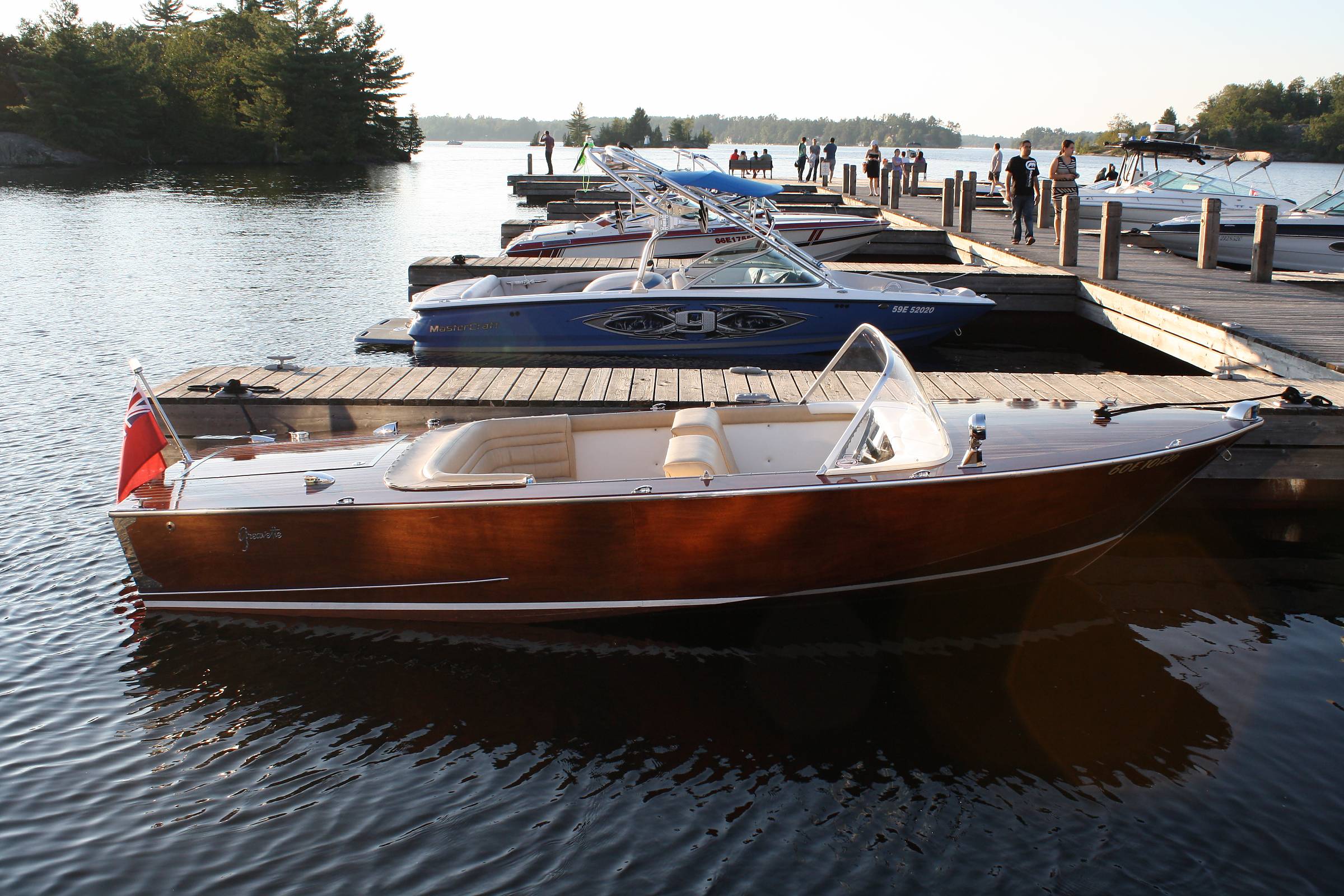

    That's correct Woobs, it's the end result that counts. On a hull like that, I'd be inclined to select a baseline that has the keel with some slope to it. This will permit the aft sections to separate a bit, so you can see what's going on. In other words, it's very likely that as the boat sits static in the water, the transom is lower than the rest of the boat, with an aft slope to the boat's centerline. This would be an ideal way to present the lines, to avoid any muddiness (multiple lines converging) in the aft sections.
    This is a classic example of what I'm trying to describe. The whole of the aft sections are convoluted and very difficult to visualize, because the merge together on the bottom. This is because the centerline of the boat parallels the base line.

    PAR. I think You're "bang-on". If I level the keel that way, I expect my boat will look similar to your drawing :)
    (pictured again so you don't have to flip pages)
    I appreciate ALL opinions / comments. Thank-you.
