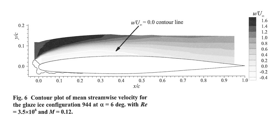

    Let's not complicate things by discussing rotors, windmills, flapping wings or other unsteady flows. I haven't been able to find measured flowfield data for simple cases, possibly because it's expensive to test and usually not considered necessary because the computations are usually pretty good.
    There are some papers with results for airfoils with simulated ice on the leading edges. These complicate the situation by having large separated areas behind the ice, but they clearly show higher speeds going above the ice. Unfortunately they don't show the measured flows without the ice or the flow below the airfoil. (I've attached a pdf of the paper this figure came from.)
