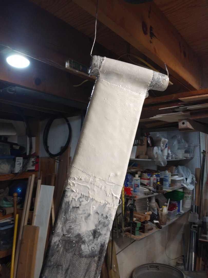

    8-17-23 Been a couple of busy weeks. Took in the Travers City and Hessel Boat shows. Some progress made on the interior where strut will pierce the hull. 20230810_151116.jpg
    I decieded to make a form to compress all the layers of fiber glass and carbon fiber materials when all glued up. Each side of the single bearing smaller strut has eight plus layers of cloth and carbon fiber glued in place. Five additional layers rap around the top of the bearing and mixed in with the layers forming the foil shaped leg. 20230808_135548.jpg
    This form got me close to shape with a small amount of sanding. 20230808_135605.jpg 20230808_153524.jpg 20230809_102236.jpg 20230809_103952.jpg 20230809_111600.jpg
    Let it cure and here is what it looks like. 20230810_132115.jpg 20230810_132126.jpg
    This end photo has a couple of spots that look hollow but that is just at this very end. The part of the leg closest to the bearing and about 8 inches long is solid. Tell what you think so far. I'd really like to hear any ideas before I glue up the bigger main strut. It will have twelve layers per side of the foil shaped leg. Thanks

    Put some thickened epoxy in the holes. Next time use a big friggin fillet at the intersection of dovel and spine.

    9-12-23 Struts are made and fitted into the boat loosely so they can be guided by the shaft. Really happy with how this has worked out. They look really good and seem really strong. I put three layers of fiber glass cloth on for the final layers. This was then fared and given three more coats of epoxy with white pigment. Placed the holes in the bottom of the boat this past Monday and assembled things including the struts. Looks great! 20230802_150030.jpg 20230802_151818.jpg 20230819_183151.jpg 20230910_150730.jpg
