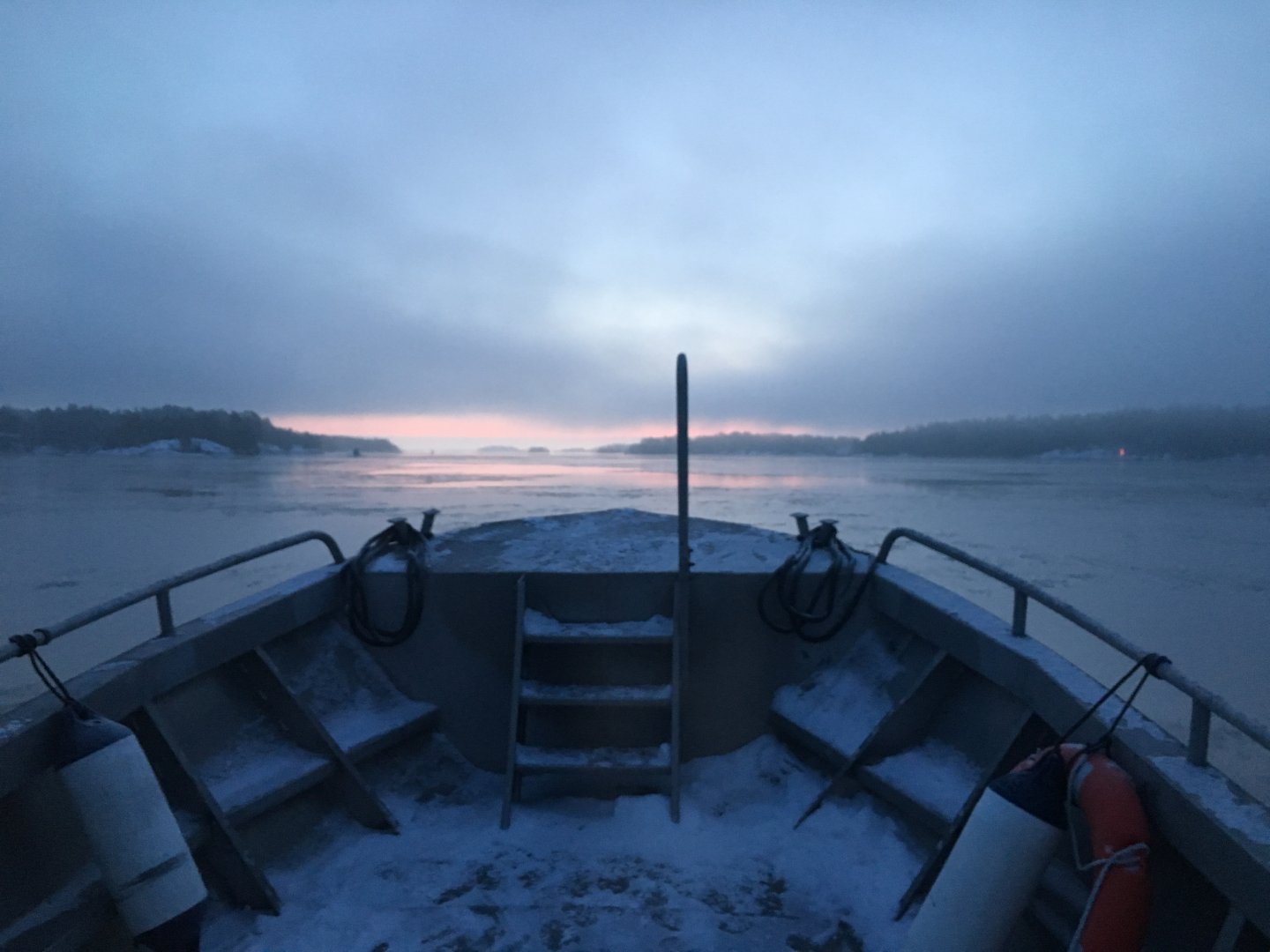

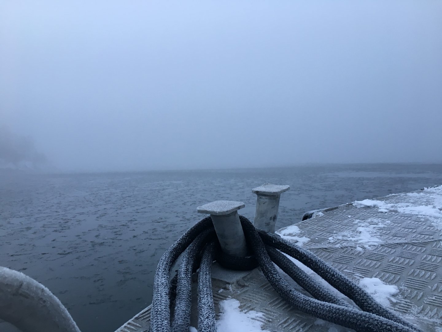

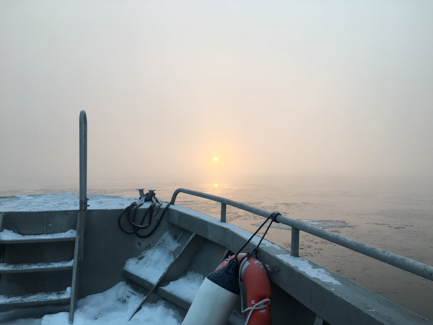

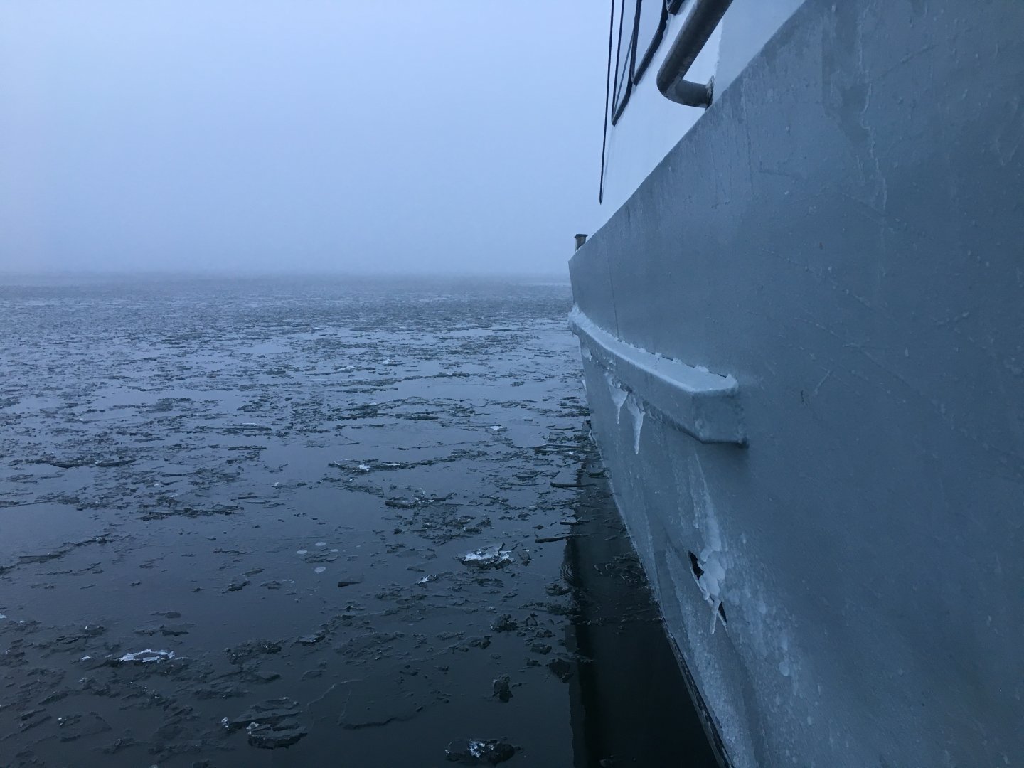

  12. Magnus W
    Joined: Nov 2017
    Posts: 151
    Likes: 13, Points: 18
    Location: Sweden
    Magnus W Senior Member
    It's quite typical for the kind of winter weather this boat's facing (although still and sunny today which is surely not always the case). Ice that comes and goes, sometimes open water, sometimes pack ice and never knowing from one day, or even turn, to another what you might run into.
