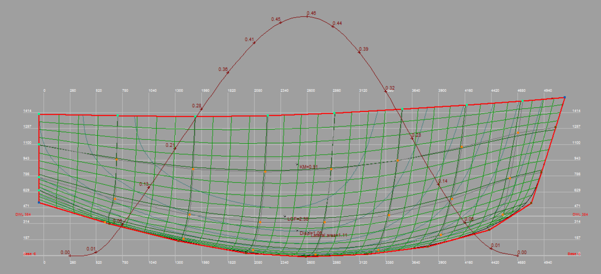

    Hi everyone, this is my first post, and I have little clue as to what I am talking
    about.
    I installed Freeship, statred a new sketch, made my boat
    5.2 meters long.
    1.762 meters wide
    Draft: 400mm
    and hit ok.
    The result was a sketch that I do not understand.
    I get the length width draft and height,
    bur I do not understand the brown curve with the measurements
    that move around when I for example stretch the hull back and forth.
    I also do not understand the greenish curves and their meaning.
    I have attached the sketch in pdf format.
    Perhaps someone can explain what I do not understand.
    EDIT: I have also attached the resulting Design Hydrostatics
    calculation if anyone cares to comment on the feasibility of this
    design, the boat is for a small lake to fish from, I think it is quite
    stable, and the cg and cb look good to me, but I really need opinions
    as I have never had anything to do with boats other than to weld them.
    I have looked on line and my horizontal centre of buoyancy is above my horizontal centre of gravity,
    is this a good thing or a bad thing, one site says its good for stability.
    I look forward to your replays
    Thank you kindly
    Regards, john

    Yes, your question makes sense but simply fact to make it suggests that your skills are so scarce that probably can not understand the answer.
    Any way, the brown curve represents the area of the submerged portion of each frame.
    I do not see any green curve. There are some blue curves representing the longitudinal sections of the ship.

    I'm not sure what's going on either..
    I think your green curves may be buttocks & your brown curve is of areas.

    Thank you for your assumptions.
    There is equal amounts of Green and Blue with a little Red in that colour,
    R64-G128-B128.
    As regards describing the Brown curve with the values also marked in Brown
    it goes way up over the boat and thus how can it be submerged.
    Regards, john

    The curve of areas is not bounded by the hull lines.
    It looks like your LCG might be a bit forward. Most boats it is about 52% to 58% of the DLWL aft of the FP (forward perpendicular - Usually station 0 at the bow.)
    If this is your first 'design' you are doing quite well but you might want to get a book to help you understand what you are doing, the terminology, etc.

    Greenerpastures, You're welcome. I see you know a lot about colors (not enough to design boats). As mentioned above, a good book would help you to know what you're doing. My advice is that you study the basics of naval architecture before you start designing boats.
    I do not know what you think is submerged. Of course the brown curve is not.
    And yes, center of buoyancy should be above center of gravity.

    Welcome to the forum.
    This is the "typical" result with basic parameters punched into free design packages, for a round bilge yacht.
    The colored lines represent slices taken at default settings, through the hull. These are longitudinally, vertically and horizontally oriented. These settings can be changed, but more importantly, you need to understand a whole lot more about what's going on, than you currently do. Do yourself a big favor and open a few books on yacht design and plow through, until you have a basic grasp on the processes, then you can move onto actually modeling something with software.
    Simply put, drawing some pretty pictures (that boat isn't even remotely pretty IMO) with free software doesn't mean it's a boat, nor very well suited to your needs, or even if it'll attempt to float upright on launch day. It's just a software package doing what you've asked it to do, without regard to what is appropriate, necessary, desired or needed as an end result, that you'll take farther from shore than you can swim back to.
