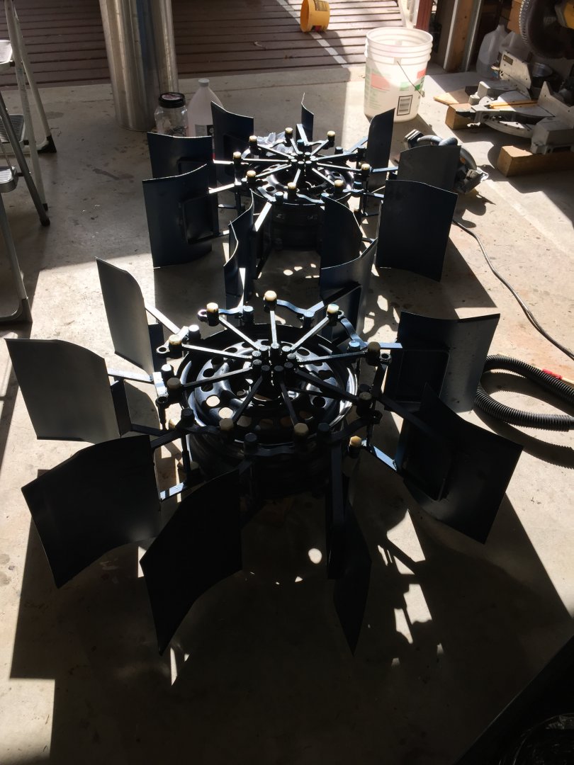

I have been educated in paddlewheel propulsion, and am willing to assist you in design details if you like, once you decide on the basic direction you would like to take: Steam or Internal Combustion power plant, fast or slow, traditional silent or viscous radical fast. Have a look at the Beckersville Steam Engineering Co. website.
Photo of articulating paddlewheels built for my sidewheeler.

I will continue to digest the info that has been brought forward so far. A steerable sternwheel is something I hadn't thought of. Maybe for good reason. We'll see. The other configurations I'll have to look into. Thanks. Ron
A steerable paddlewheel sounds like a terrible idea! I’m picturing an articulating paddle wheel at the stern which would require a substantial keel under the hull, usually a bad idea on a shallow draft barge type hull.
Maximum maneuverability means spreading the wheels as far apart as is practical.
Moving side wheels towards mid ships should cause it to turn on a dime, and possibly operate without any rudders.

Complexity can be used to some degree of advantage, such as feathering paddle wheels. The website below has a lot of paddle wheel stuff.
Paddleducks - Feathering paddlewheel. http://www.paddleducks.co.uk/smf/index.php?PHPSESSID=d01994555ac3a4699413187745c8911a;action=gallery;sa=view;id=4144
