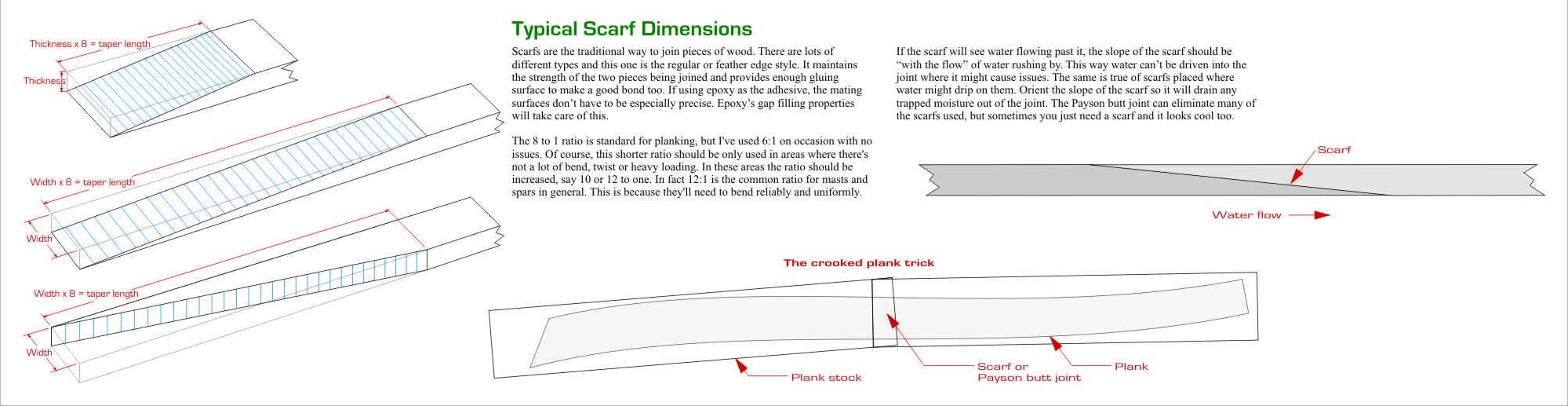

    Ok. This is as good of place to ask this as any. It's kind of directed at PAR because I'm using a drawing of his as illustration.
    I've always worked with scarfs on the premise that scarf ratio was based on the the slope of the cut. Run over rise. In this attachment, the scarf length is based on the width of the board, regardless of orientation. Scarfed across the minor dimension, this makes sense. Scarfed across the greater dimension, the ratio is increased to a greater ratio. The amount of joining surface is much greater in the second scenario. I think that the first illustration on the left side of the attachment is correct. I the middle illustration is not an 8 to 1. I think that the bottom illustration is also correct.
    I only bring this up because I have been thinking about scarf joints and the most efficient use of material. Scarfing across the major dimension, top and middle, will net the shortest scarf while maintaining the appropriate slope. Scarfing across the minor will net a longer joint, lower illustration, while maintaining the desired slope, but use more material. An 8 to 1 scarf is 7 degrees (ish) regardless of board orientation.
    The question: Is there a difference in joint strength depending on whether the scarf is cut across the major on minor dimension of the board.

    All three drawings are correct and it depends on what you want. On deadwood assemblies you'll use the width, which is usually shorter than the height. Using the height on these would make scarfs too long. On a mast, it's more common to use stave thickness (generally 12:1), again to keep scarf lengths reasonable. This drawing is just to show how to arrange the scarf ratio, but is dependant on the application. The drawing wasn't precisely scaled, but is pretty close. This drawing is one of several that go with all my plan sets, as generic instructions and information. As a rule a scarf is used to provide sufficient glue on the faying surfaces, but with modern adhesives you can get by with less. I'll have a look at the original drawing and see how far off it might be on the middle sketch.

    You need to get back to me too, cause I can't see any justification for calling the top and the middle scarfs both 8/1.
    I can understand wanting to change the ratio for a given task, but the middle illustration would give an different angle of the tapered portion of the board dependent up the arbitrary choice of width of board.
    Is there something more than describing a selected angle on the taper involved in your definition? 8/1 slope to me describes 7.12 degrees. Making the middle one an 8/1 would change it to much less than 7.12 degrees.

    This is the same artwork with the 8:1 ratio shown. I was right, it was slightly off, but in this resolution, very difficult to see. The difference for illustration purposes was good enough. Note the lower two images use the width, while the top image uses the thickness to work the ratio. Any of the dimensions can be employed in a scarf.
