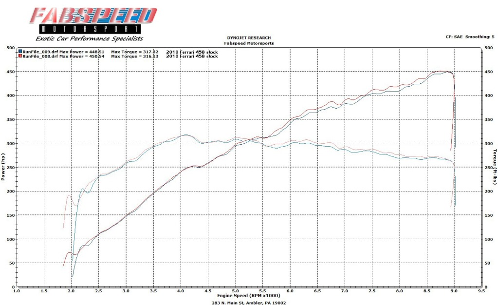

    Here is a riddle for you. Look at the video below and compare it to the power and torque chart. If it is the torque that makes the car move (in a way that power numbers are less relevant) then shouldn't the Ferrari accelerate the fastest at the revs where peak torque is produced?
    It seems that the driver does shift at 9k rpm and it stays nicely between 7k and 9k rpm, near the peak power. I have seen this argument of torque numbers ruling power on many discussions but it is false. Just think about it a bit.

    No. The car will accelerate fastest where the most power is produced, and power is torque X rpm.

    Naturally you are right. That is exactly my point. You can have two tractor pulling a plough one with 400 Nm torque @ 1000 rpm and one with 400Nm @ 2000rpm. The latter will have double the hp and double the pull.
    Let me clarify if it wasn't clear: "shouldn't the Ferrari accelerate the fastest at the revs where peak torque is produced If the claims* quoted in BertKu's post were true?"
