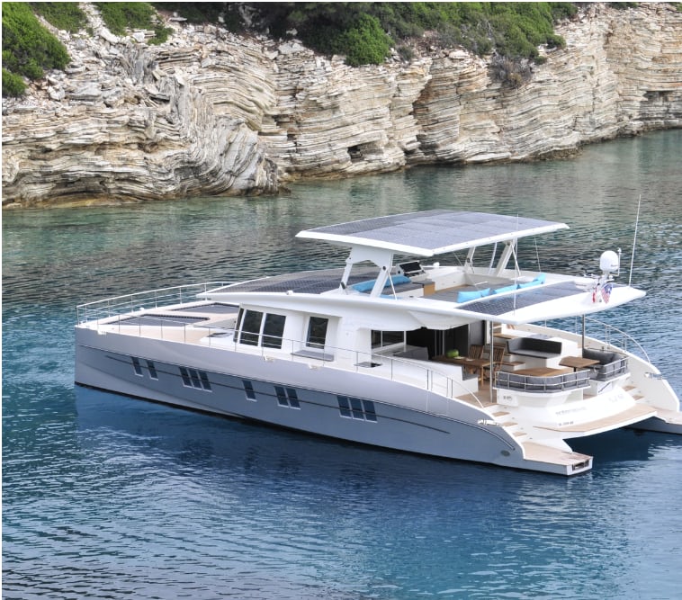

  12. JonathanCole
    Joined: May 2005
    Posts: 442
    Likes: 8, Points: 18, Legacy Rep: 58
    Location: Hawaii
    JonathanCole imagineer
    How about this one?
    http://newatlas.com/solarwave-64-catamaran/47205/?li_source=LI&li_medium=default-widget
    Reportedly can cruise a 6-7 knots on sun alone with no range limitation.
    I find it interesting to see how much negativity there is on this thread about solar boats. Planet Solar was not trying to set a speed record, it was trying to promote solar energy, stopping off in many ports around the world for extended periods. And according to calculations we have made, Planet solar went way beyond the sweet spot of maximizing solar power collection to total windage and hull resistance. The design shown at the link above is much closer.
    I think that for some reason the TROLL phenomenon is very much attracted to BoatDesign.net Also the reason that many former contributors are now absent.

  15. DennisRB
    Joined: Sep 2004
    Posts: 1,268
    Likes: 25, Points: 48, Legacy Rep: 228
    Location: Brisbane
    DennisRB Senior Member
    Way to go insulting anyone who expects realistic claims based on evidence and simple energy balance instead of wish thinking. If you read this thread you will see the planetsolar cat which cost something like 24 million was able to do an average speed of around 4k downwind around the world. If it had to go the other way it would probably still be out there. This was a 31m boat had no luxuries and had a gigantic array that was even bigger than the boats footprint. This is a record breaking solar yacht.
    Based on this, how can you preemptively call someone a troll who would question the validity of the performance claims from Solarwave for thier 64 footer. 6 to 7 average knots for a boat with a relatively small surface area of panels and packed full of luxury amenities. Are we trolls to be critical of the claim this has almost twice the performance of the no expense spared planetsolar while also fitting a floating condo inside?
