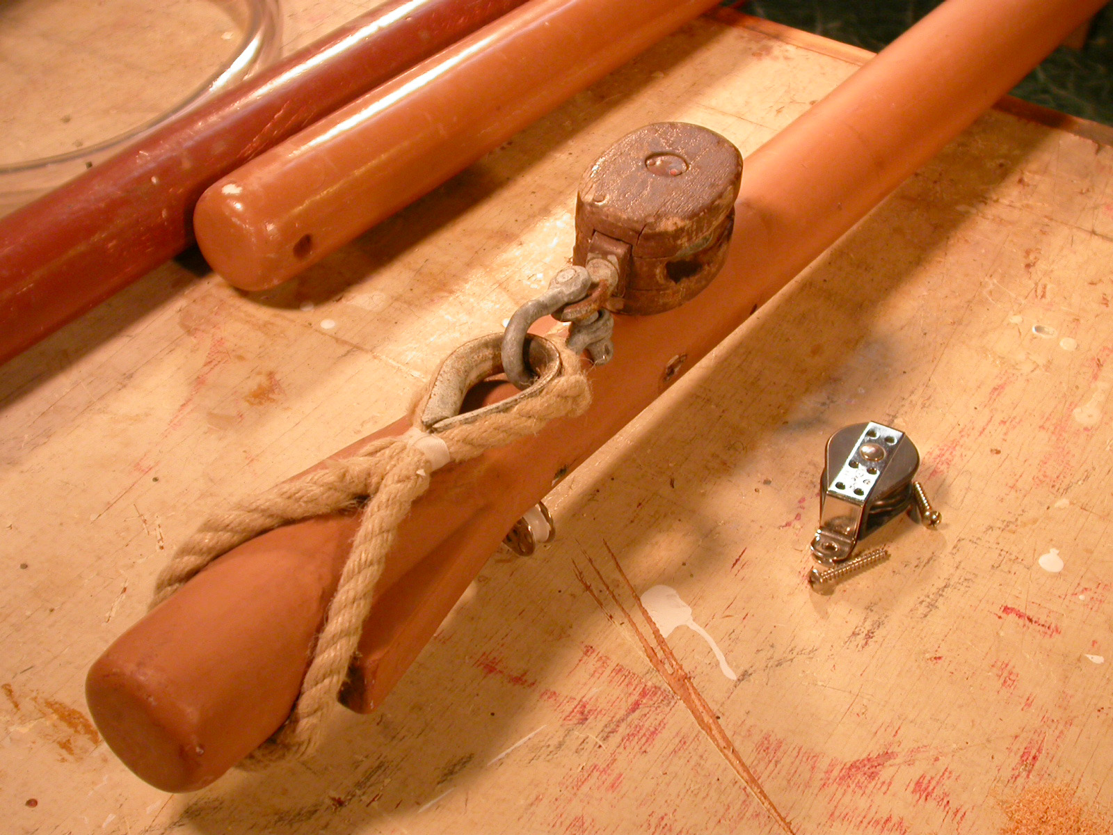

    proper name for these 'mast connection'?
    What name might be proper for these 'blocks' that would attach to the mast tube to keep a 'loop' of rigging rope/wire from sliding down the mast ??
    cheek blocks?.....

    ..a couple of other photos I ran across of something similar to what I am speaking of...

    Brian
    They have more than one name that I've heard but we always referred to them as a "thumb". A cheek, a bolster and of course the general term for the landing of a "soft eye" is "the hounds".
