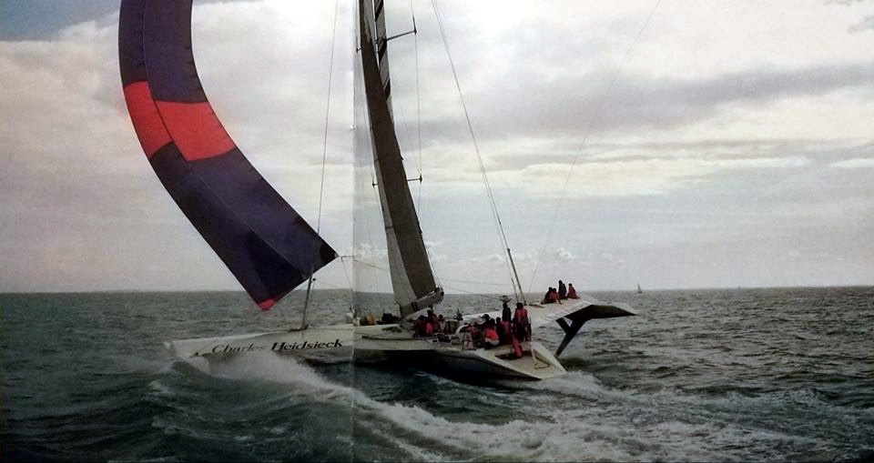

    Doug in his delusional fantasy land ... as per usual. Has been corrected before but strangely never seems to penetrate - so posting a 40 odd year old image of a pioneering design. There are others but this will suffice.

    Wrong again, Gary: Charles Heidsieck had a fixed, non adjustable foil on the main hull and unlike Fire Arrow, Maserati, Gitana 17, Macif jr, Macif and Banque Pop could NOT develop downforce -a key element of the mainfoil in the Fire Arrow Foil System and used on every single boat I just mentioned!!! Further,Heidsieck had NO rudder T-foils and was incapable of foiling. It didn't use UptiP ama foils as does every single boat that uses the basic Fire Arrow Foil System mentioned above.
    Why you continue to post a picture of a boat that was a design/build failure(way too heavy!) and could not foil remains a mystery to me!!

    From "Foilers!" on Charles Heidsieck:
    "But while he had to be light, he was heavy. Expected to weigh 13.2 tons, it was 5 more when it was launched and had to approach 20 tons in operation. Whose fault is it ? Some spoke of poor management of construction, others of insufficiently precise plans ..."
