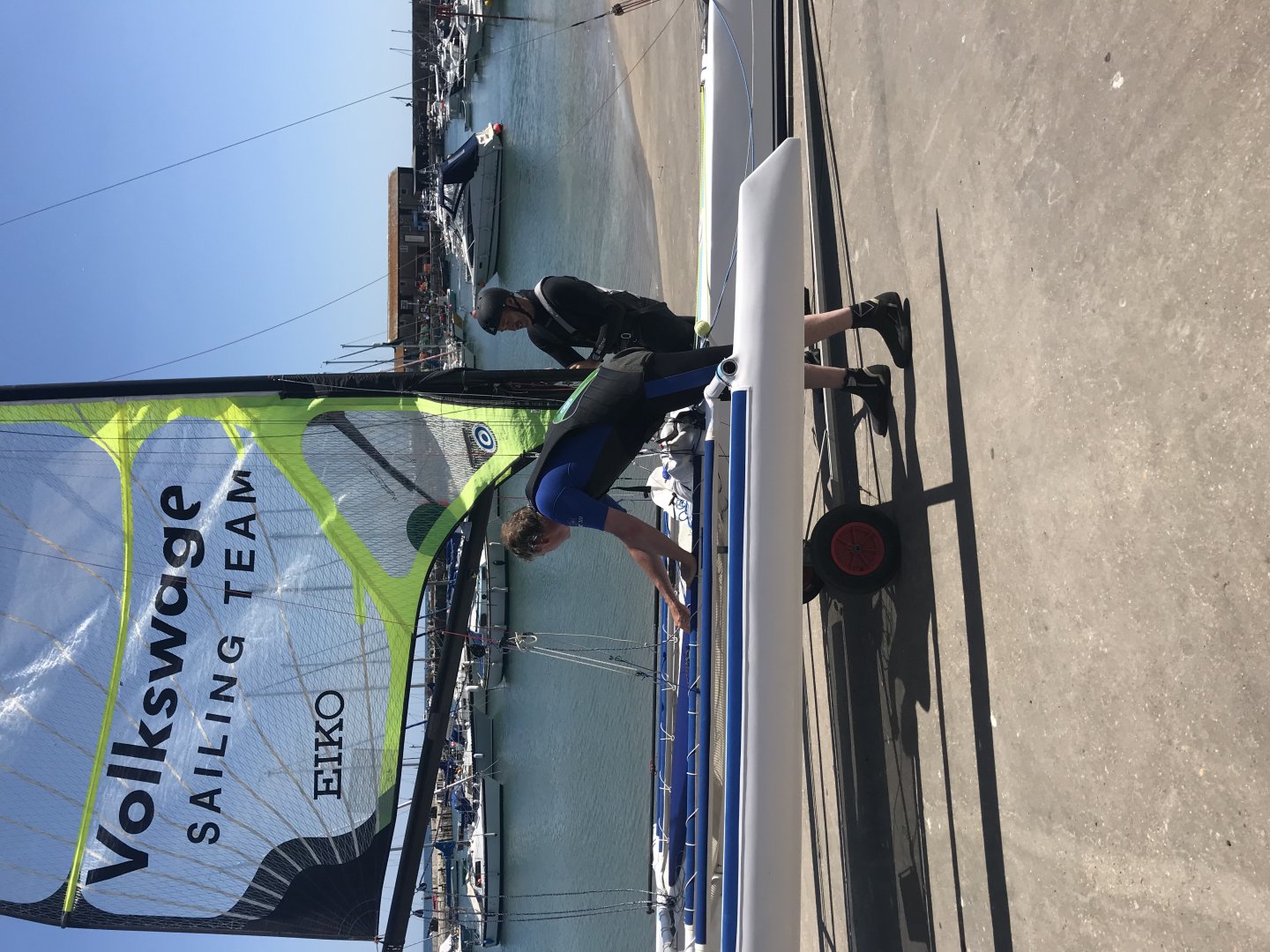

    BE3197A1-CE53-4172-938F-023A6A684211.jpeg C94D49DE-F519-407D-BA84-2DF37FCC53E6.jpeg I managed to sail my design a couple of weeks ago in a good f3-f4 of breeze. I’m only running a rudder lifting foil for the early tests and the results are impressive. No figures as I’m not datalogging at the moment.
    It points well and the modified 49er rig allows for very precise trim by controlling the leech tension on the main sheet.
    Across wind on a beam or above we are both wiring and dumping power as too much drives the bows down, but because I designed in a lot of forward bouyancy she simply adopts that attitude and continues to sail predictably. With the front main foil fitted it’s going to go totally bananas as we will be able to use all the power and keep accelerating.
    On a broad reach there’s no need for a kite, single wiring with main and jib sheeted in it demonstrated that it’s an apparent wind sailing machine - very impressed and again very controllable. Again with the front foil on I believe we will be twin wiring on 2 sails.
    On a run with the kite up we were single wiring and going very deep, again no lee or weather helm but were covering the bay at such a rate it was over far to soon. So that’s the good stuff...
    The bad stuff is I need to change the sheeting position to allow the use of only one tiller extension as I had a lot of problem with the redundant tiller locking off the helm on the bridle. One of my trampolines came lose and I need to fit a different kite halyard cleat and another block on the self tacking jib. The 49er rigging procedure is terrible, I hate it and would dearly love to fit a carbon F17 mast and main but it’s too much money for now.

    Are you talking about a single lifting foil in each ama or a single lifting foil on the main hull forward?

    Lurch723 Junior Member
    Rudder foil is a Cucifix foil that I can adjust on the fly from my tiller extension, the main lifting foil which I have yet to fit isdeigned to put the boat into a skimming or just bourne mode. One of my questions I wanted the answer to was what was the smallest surface area I could plane on and I believe this boat did just that, it also wave pierced beautifully and just kept going, ignoring waves and not slowing.

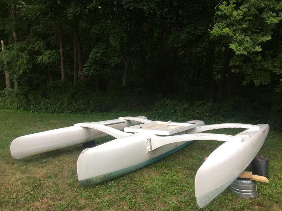

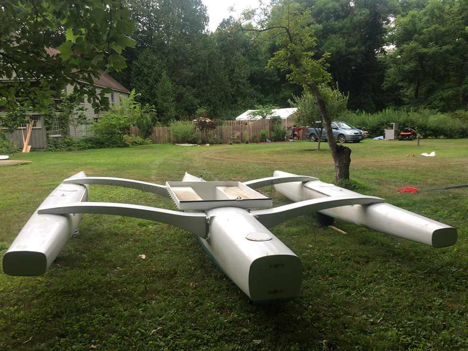

  15. Corley
    Joined: Oct 2009
    Posts: 3,781
    Corley epoxy coated
    It came up on Facebook in the Small Trimarans group. One of the guys there Gregg has recently purchased the boat and is going to restore her.
