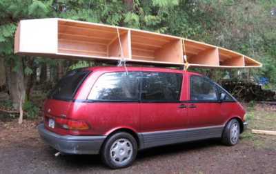

    The Skoota has dxf files for most parts.
    However I would advise against CNC routering anything apart from the bulkheads and initial cuddy "box" because you want all the parts to fit and thus be watertight.
    Generally boatbuilders tolerance is about 2mm (say 1/16in). The CNC machine will cut exactly, so you could potentially have 2mm gaps between the cut parts when you assemble them. Making a 20ft hull to a 1/16in accuracy is pretty impressive even for a professional.
    Of course you can do it by "stitch and glue" and allow the epoxy and tape to fill any gaps. But one problem with that is that the panels then get very hard to man handle. One reason for having ply sheets at 8ft x 4ft is that they are man handle-able. Imagine moving a piece 20ft x 4ft x 1/4in by yourself. I find stitch and glue slower and more expensive than timber framing when making easy joints. I only use it for double bevelled joints.
    As you are a beginner boatbuilder expecting precut hull side panels to fit exactly would seem too ambitious. Better to make the boat to fit the parts already made. That's what I do, but then I am not a boatbuilder.
    The Skoota design is all flat panels, no double curves at all. You can build it all in parts and join it together at the end. We built ours in a 16ft x 18ft garage (which had household "stuff" in it as well). First we built the cuddy, then each hull separately, as they fitted in at an angle. We were able to assemble the whole boat, just, in the garage, the hulls stuck out but by then they were watertight.
    You could start with the cuddy, basically a simple box. If after building it you decide that it is too much for you, or that time is running short you can get a local boatbuilder to make the hulls. In fact that is what we did with our second hull. To save time we got someone 150 miles away to build it for us. He delivered it on the top of his car (!) - not bad for a 20ft hull! See photo here and in the 2010 year review on my site
    I like to build my own boats because then I can iron out all the bugs and more important I know how its built. I don't just supply plans and expect builders to do the experimenting for me.
    Although we used our Skoota 20 for a couple of years cruising in the PNW (longest trip was to Princess Louisa inlet, see videos here https://www.youtube.com/user/WoodsDesigns/videos ) we never really finished it. Hence the grey primer paint and no windows. That was because we had presold it to someone in Belize who wanted a "part finished" look to reduce the import duty.
    He came to pick up the boat with his flat bed trailer on a Tuesday afternoon. We fitted the trailer supports to his trailer on the Wednesday, loaded it that evening and he left first thing Thursday morning. A week later we heard he was at the dock in Florida ready to ship it to Belize.
