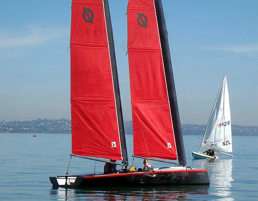

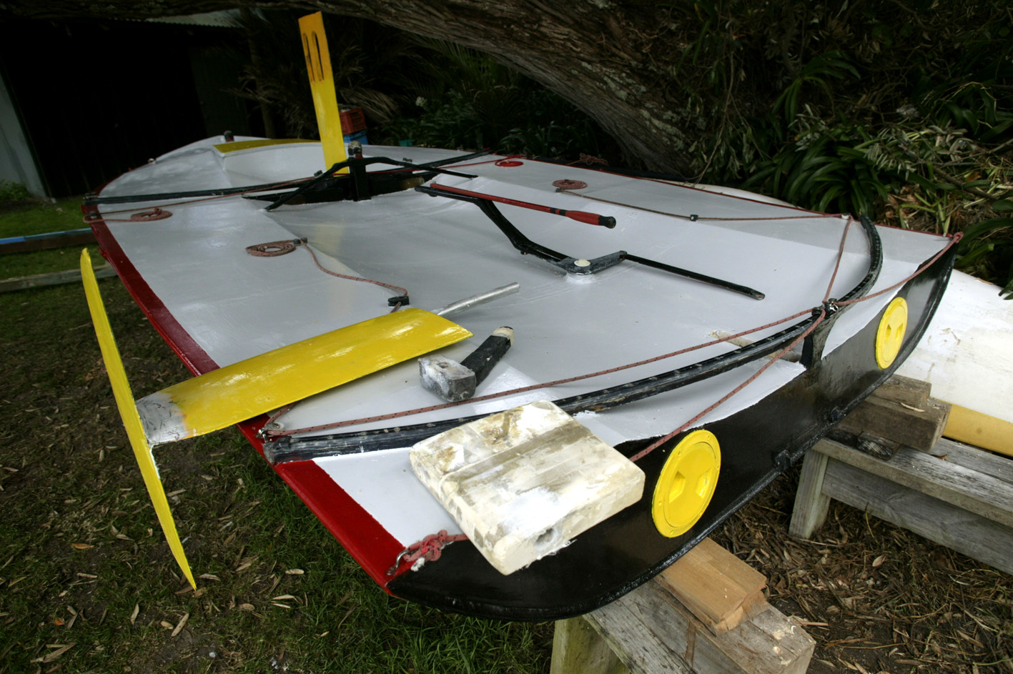

    This is my Cox's Bay Skimmer 5.5 x 2.25 metres with T rudder and T daggerboard and rotating small chord wing masts. You could build a larger version. Boat is fast, goes to windward very skimmerbuildy.jpg skimmer smallchortmasts.jpg well and lifts off on reaches.

    @Gary Baigent : Wow amazing achievement! Beautiful design.
    Do you have video of the sailboat?
