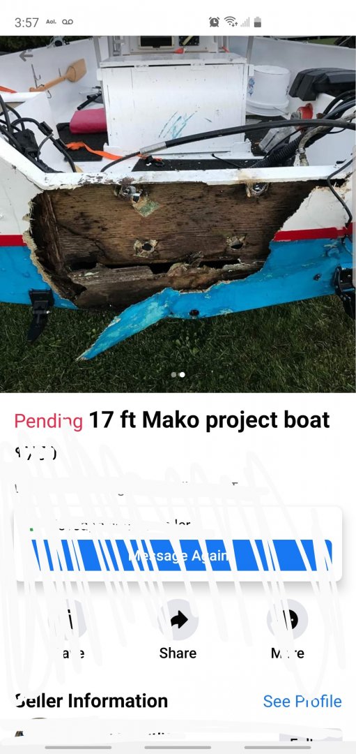

    I was wondering if this is possible to repair. The engine fell off when the last owner hit a pot hole and it looks like it took alot of fiber glass with it. Is it possible to fix? Or maybe completely replace with a wooden transom. I would like it to support a 150hp Yamaha vmax. Or will this area never be able to support an engine the same way again? Does it compromise the structural integrity of the boat?

    It is possible to repair, but it is a matter of whether it is worthwhile, it really needs a close inspection by some experienced hand who can assess the situation. Did the motor leg hit something ?

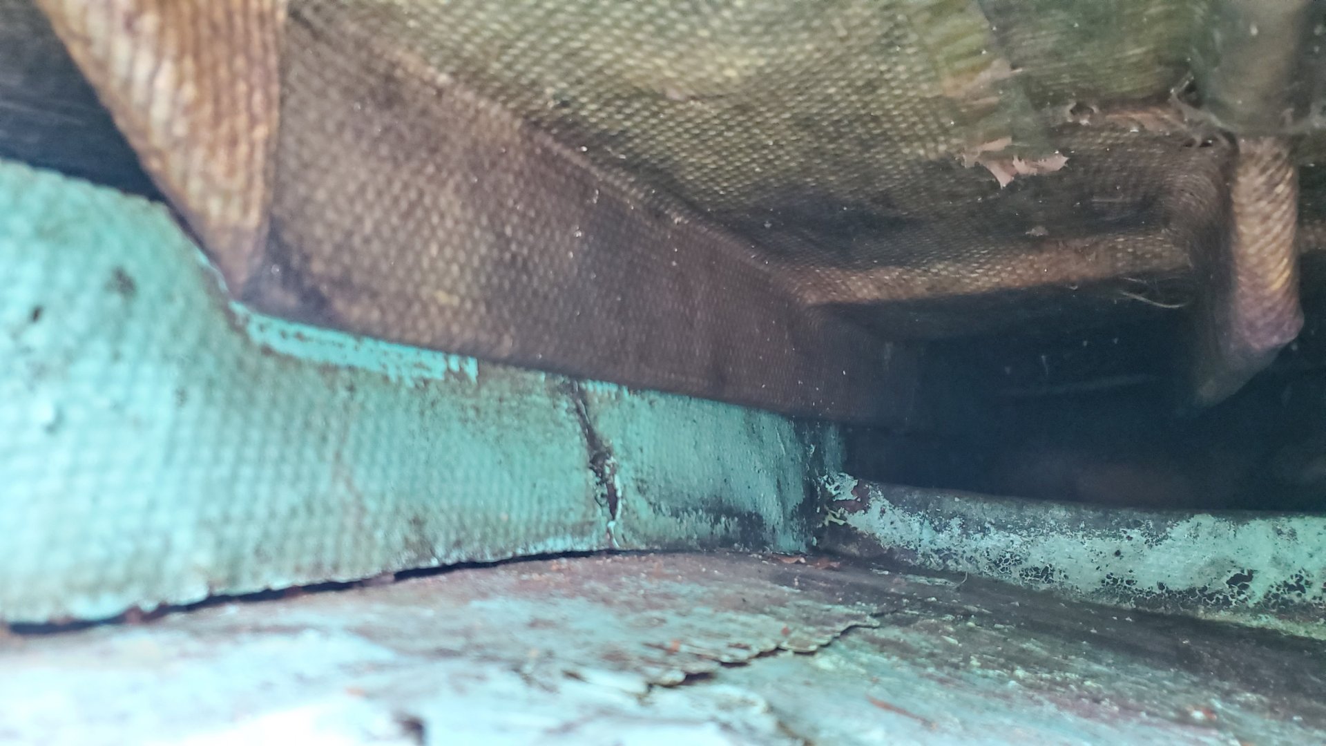

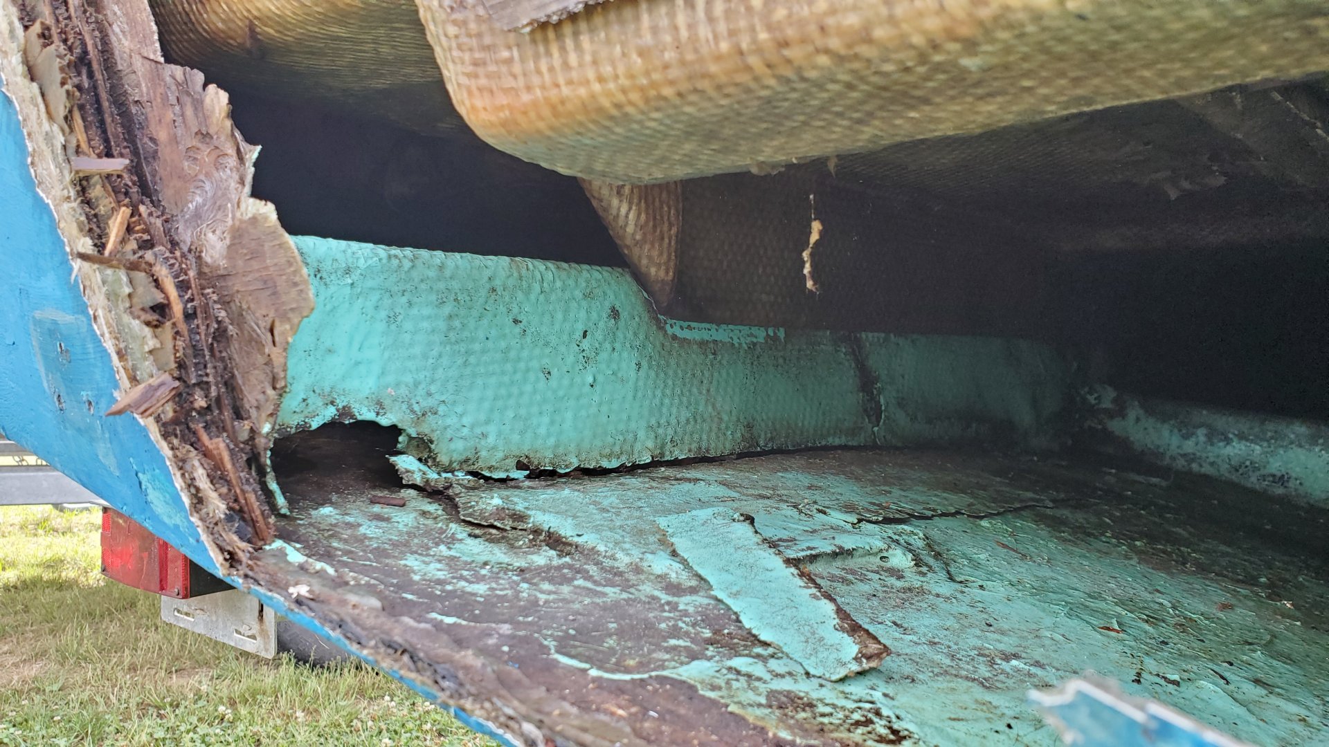

    A closer and clearer look
  9. Mak1999
    Joined: Jun 2020
    Posts: 14
    Likes: 0, Points: 1
    Location: North east
    Mak1999 Junior Member

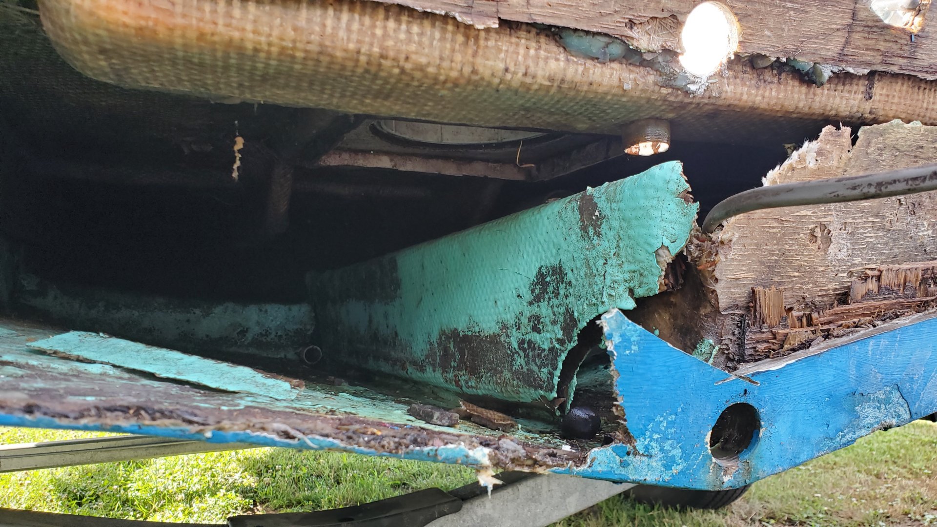

    There seems to be some separation but I'm hoping to fix it, even if it comes down to some studs and bolts.

    Anything made from fiberglass can be fixed, whether it's worth fixing is a different story.
    Normally if the transom is rotten so is all the other wood in the boat, which means you need to totally gut it.
    The job will take at a minimum several months, as a DIY project it frequently stretches to years.
    And budget several thousand $$$$ for matetials.
    After that it's another outlay of cash for a motor, typically many thousands again for something that works.
    Fixing an old rotten boat is not a cheap or fast way to get on the water.
    So if this looks like a project you be committed to finishing, then yes, go for it.

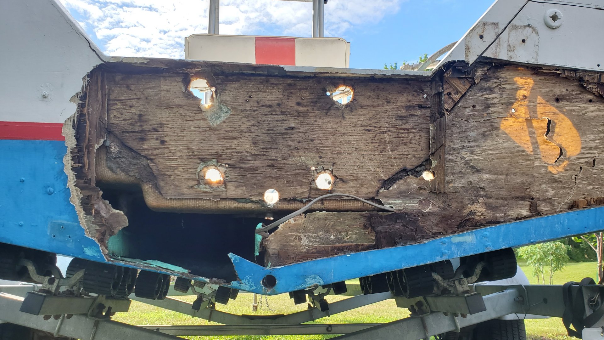

    The transom failed because the wooden core was rotted. It is not a particularly difficult repair.

    I'm just concerned about the fiberglass tub which has broken. I have been watching alot of videos and the exact process seems to vary boat to boat but basically when rebuilding the transom the remove the plywood covered in fiberglass but leave the inside layer of fiberglass intact. Plus it looks like some of the "streamers" I think they're called are delaminating from the hull slightly and they have a plywood core which has gotten a little water in there soooo.

    Usually the transom is repaired from the inside. Matching the outside gelcoat and finish is very hard. However, since the fiberglass on the outside is damaged, it makes the structural repair easier. As far as finish, it is a cosmetic issue only.

    There would have been a stress concentration at the bottom of the hull/transom interface at incident. On the hull bottom this would manifest as gc cracking. Otoh, the transom could have been so rotted that it sheared without the stresses, but I doubt zero. This means you will also need to repair the hull bottom there to do things properly.
    More globally, that boat probably has so many issues with other rot that it requires a full gutjob. The going rate for that boat at that age can never be exceeded by all your labor and material and engine and trailer inputs. So, it is economically unwise unless you don't value your time much or the boat when completed has a high value. Look online for that boat and you'll get some idea of market value of a 'good' boat.
