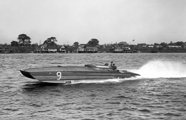

    Here's another. This is one of Marcus Lee's boats.
    Note the shape of the wake in the still image. It doesn't start to spread until more than a length after the boat has passed.
    bajansailor likes this.

    Yup.
    Markus was experimenting with nontripping chines. This boat's are very narrow forward, but 0° to the horizon, and grow wider and twist upwards as they go aft. They do the job: the boat rolls nicely in a turn, and doesn't trip. But it blows air out sideways sometimes, just at the keel/water point of contact.

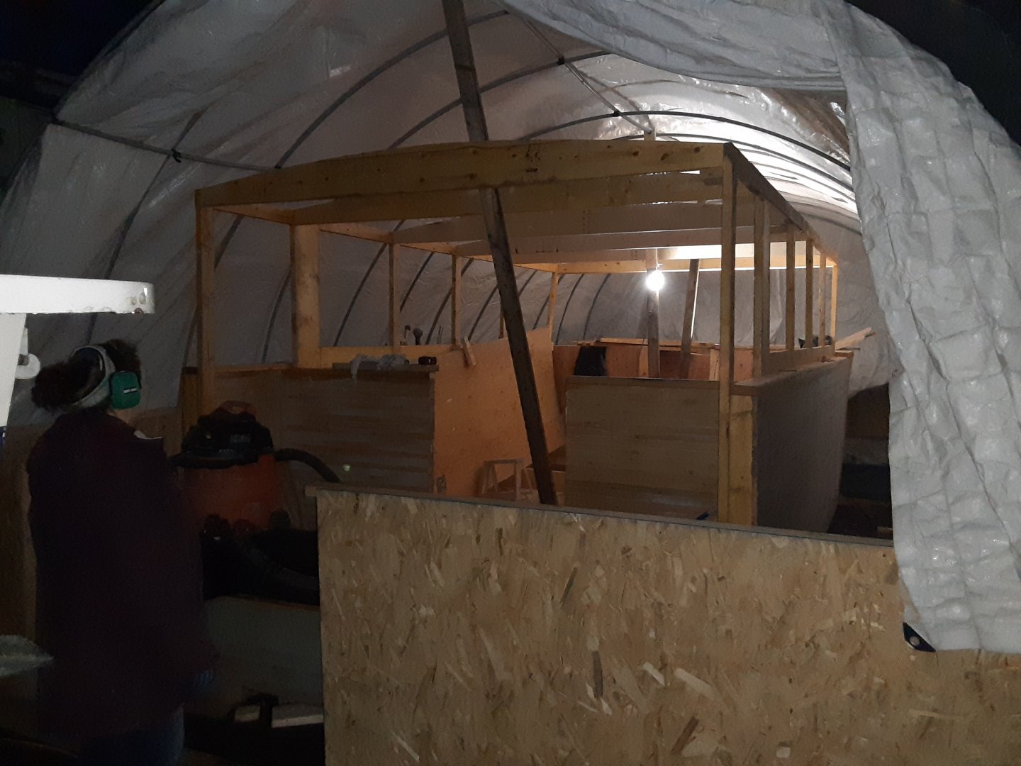

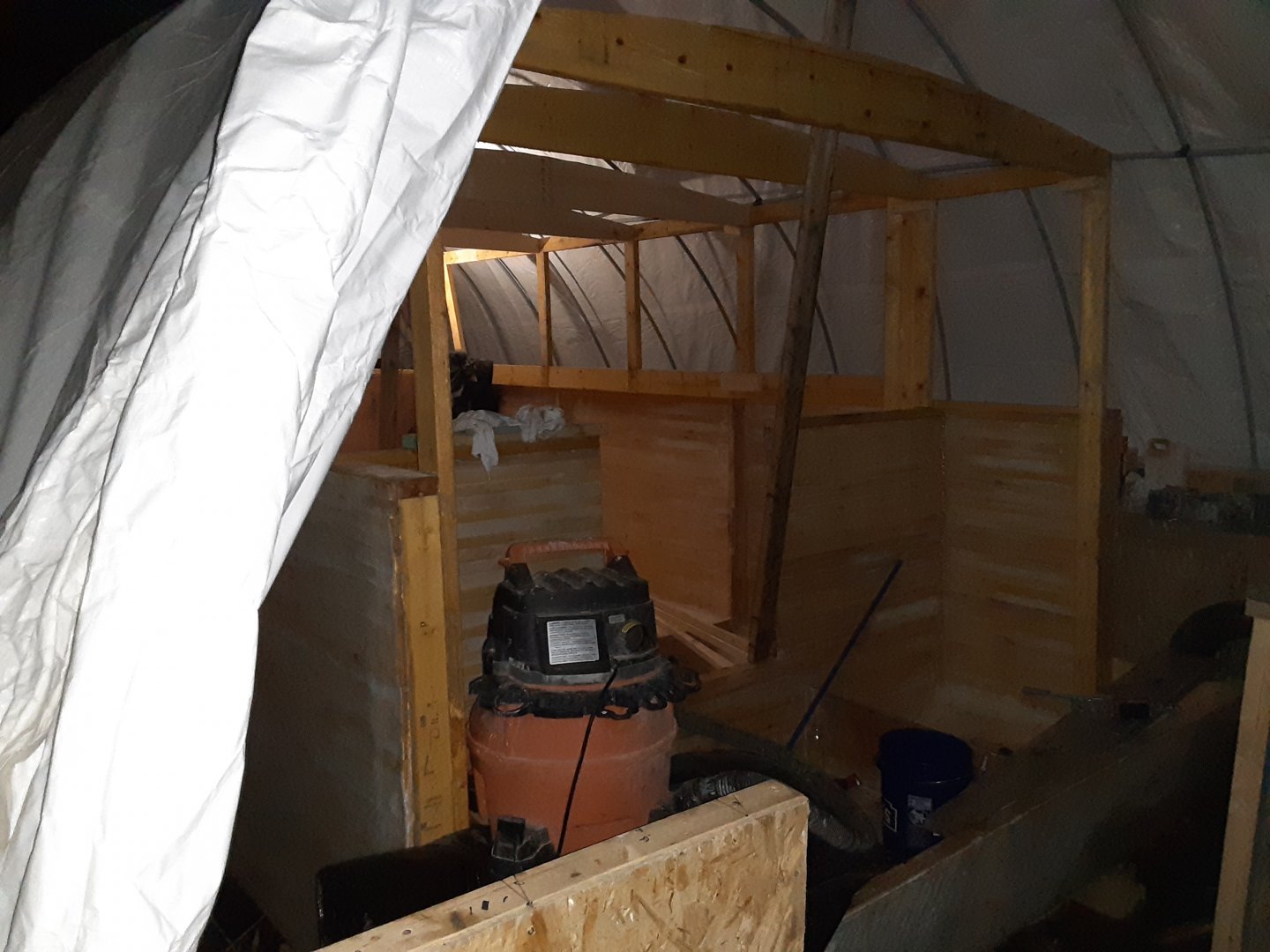

    DogCavalry Senior Member
    20210206_184326.jpg 20210206_184124.jpg 20210206_184056.jpg 20210206_183441.jpg 20210206_181404.jpg
    Today's
    Stofferaus and Air Flite like this.
