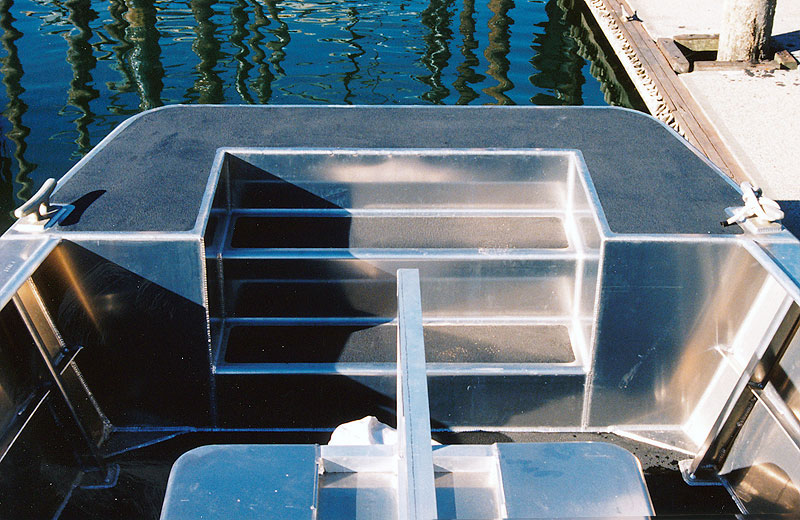

    The massive enclosure forward? The hull is so oddly shaped those last 3 feet I just relegated it to storage.
    Okay, I'll skip the stairs. I can always add them. I was inspired by this. 25odyessy_bowstairsXL.jpg
    Stofferaus likes this.

    I just think a bench is nicer. But it is your boat.
    I mean the massive cabin space. What is the goal of the space? Do not be offended too easily here. The adjective is just to offer perspectives. It is your boat; not mine.
