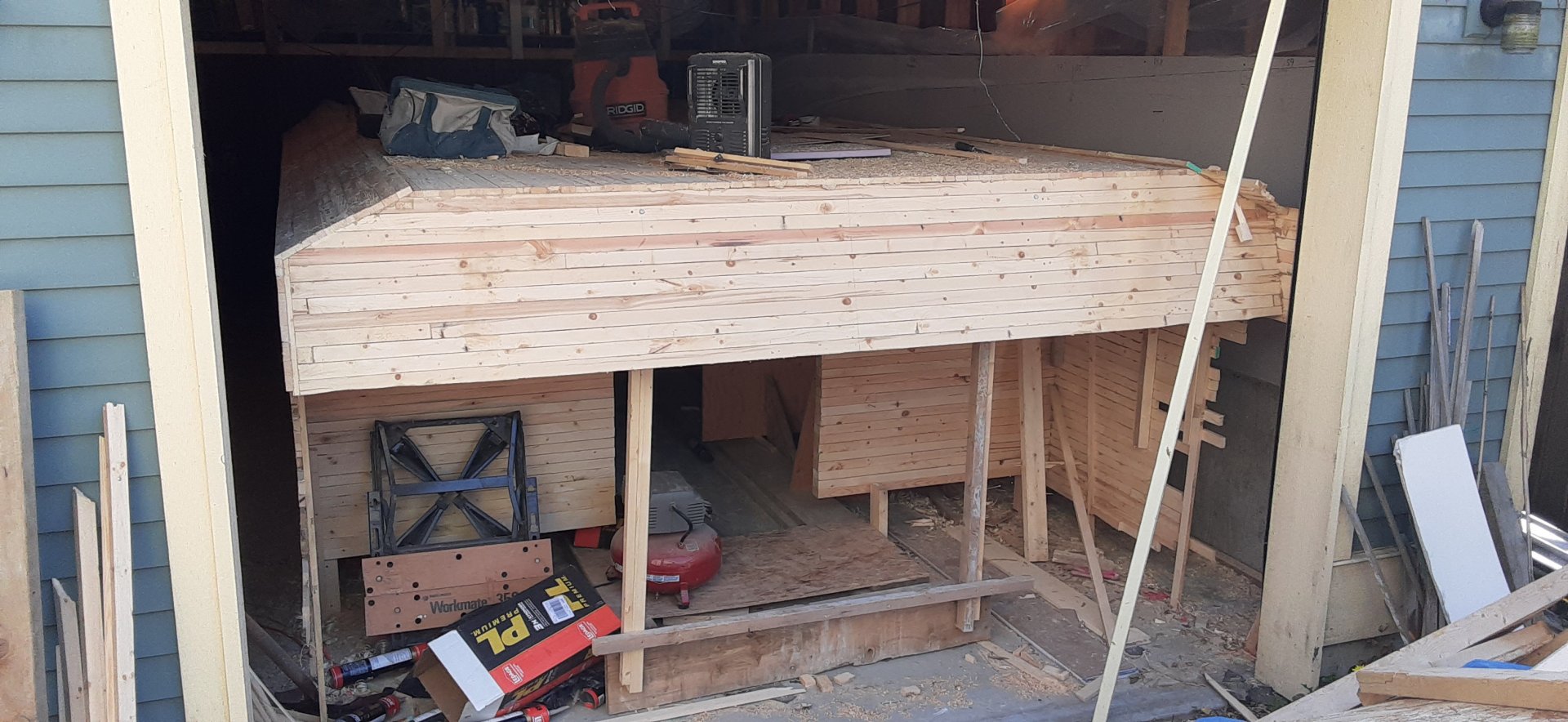

    There's no where to stand to take a decent picture. But this hull shape is immensely satisfying. Jes' sayin'

    How about outside in the rain!
    (The picture I mean.)
    If you can get up high enough to show the bow lines...

    Nope. I took that picture with the phone actually touching the wall behind it. There isn't any further back. Here's one from outside.
    And another showing me about to take the picture of the curve of the bow.

    That certainly is a tight fit for sure!
    Dare I ask if you have formulated a plan yet for getting her out of the shed?
    Will you turn her 'right side up' and then wheel her back in, or will she then live under a temporary shelter elsewhere, or.....?
  11. DogCavalry
    Joined: Sep 2019
    Posts: 3,637
    Likes: 1,821, Points: 113
    Location: Vancouver bc
    DogCavalry Senior Member
    Well, I have a friend who is a professional crane operator. He was going to pull it out and flip it for me. But with COVID-19 all his work has stopped so he's moved back to Prince George for now.
    So my current thinking is I'll rent a bobcat with forks for a day, drag it out and flip it myself. A little anxiety provoking, but doable. I have a forklift ticket, and about 50 hours in a bobcat.
    Once its turned right side up, I may move it to a boatyard. Typical rent around here for a spot where you're allowed to work on it is $300 a month. Or I may push it back in for a while. Depends on finances etc.
    Just to add to the fun, the garage door opening is 10'¼". The boat is 10'. An ⅛" on either side should be lots, right?
