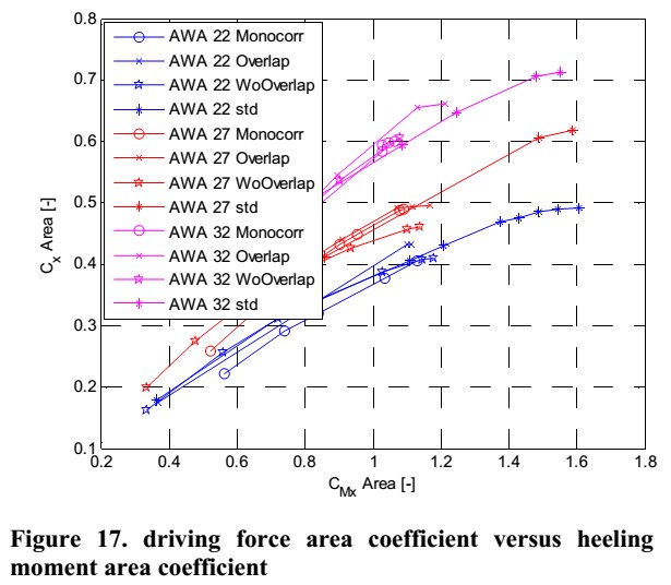

    I was looking at those plots of drive force vs. heeling moment, in particular the most representative one (Fig. 17, pg.97):
    It shows that measurements (assumed numerically reliable) indicate that the A-mast with overlapping sails does seem to have some advantage over a traditional sloop, but we are talking about 5-10% difference at most.
    For example, at 32° AWA and Cx_area=0.6, the CMx_area=1.1 for classic sloop and 1.0 for A-mast setup. That is 9% difference. Same values and same percentage difference for 22° AWA and for Cx_area=0.4.
    For smaller values of Cx, the difference even gets much smaller, according to that graph.

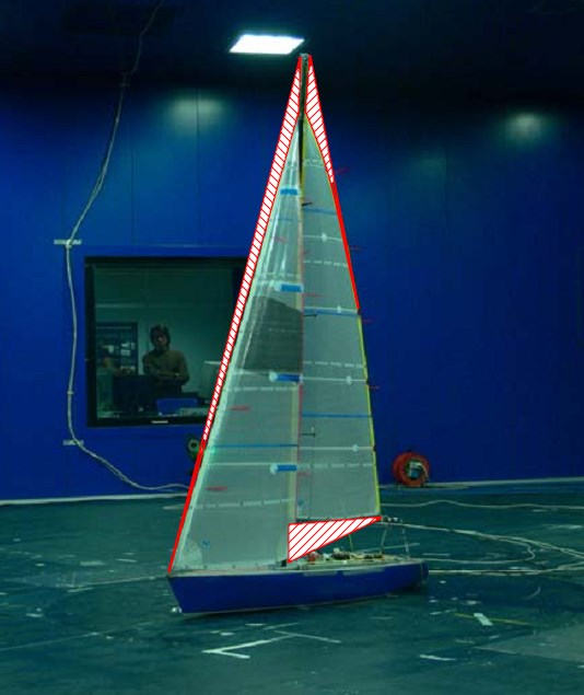

    Next, I have noticed these two particulars in the scale models tested:
    which imo show apples (on the left side) vs. oranges (on the right side).
    That portion of naked mast at the head of the sloop rig seems to have pretty important dimensions. Considering that:
    - it is situated in the area where the AWS is highest, and with the highest AWA along the mast length (due to wind shear);
    - a naked quasi-circular mast will give mostly drag, and drag is proportional to AWS squared;
    makes me conclude that this small portion of naked mast might be one of factors responsible for the higher heeling moment measured on the sloop rig.
    Another factor is highlighted at the mast base, where the sloop rig is missing a part of the area which was included in the A-mast wing, thus decreasing its drive force.
    In order to have a more fair comparison (if the goal of the comparison was to demonstrate that the rear A-mast is aerodynamically better than the classic mast) the sloop rig should have been made in this way:
    where the shaded area shows the sail area which was "forgotten".
    Either that, or the A-mast sail should have been shaped with the same form and area of the sloop rig.
    Apart that, remains the problem of the weight of the stern-mounted A-mast. By shifting the rig weight aft (will it weight the same or, imo more likely, more?), one ends up with the boat CoG shifted towards aft. That can be beneficial for sailboats designed for speed, but only if the new rig brings no weight penalty. Otherwise, any aerodynamic advantage will be at least partly eaten by the increased hydrodynamic resistance due to non-optimum CoG position (in case of small and weight-sensitive boats) and/or higher displacement.
    So, the question is - have these factors been taken into account for the VPP analysis mentioned in the paper? It has not been explained by the authors.
    And finally, I really do not see how the A-mast rig delivers the claimed advantage of "simpler sail handling while reefing and dropping the sails", and how is the "elimination of the boom and of the mainsail sheet track" advantageous in terms of sail trimming and optimization. I am probably missing some info about the handling of this type of sails.
