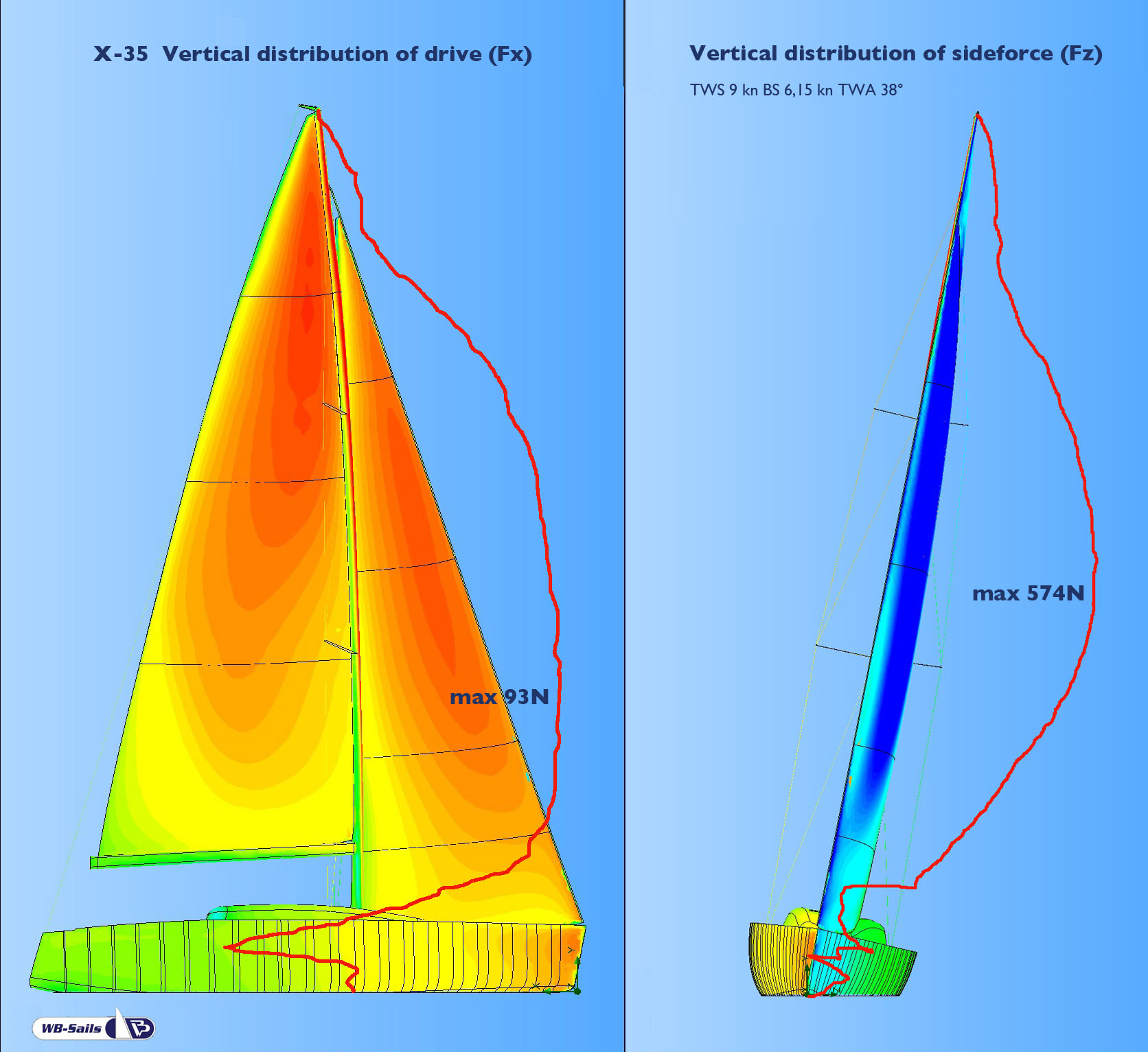

    Since the thread was active, I thought I'd add a result we recently plotted - the distribution of the driving force (Fx) and the heeling force (Fz) in the vertical direction, up along the mast.
    Although the side force distribution is very similar, this is not the lift distribution - both lift & drag distribution in the vertical direction can of course be deduced from here, considering the apparent wind angle 23,5 deg.

    Thanks Mikko, nice picture!
    Does it include vertical gradient of TWS?
    What are the total drive and lateral forces?
    Interesting to see the low contribution of the bottom part of jib and top part of mainsail.
  15. Jamie Kennedy
    Joined: Jun 2015
    Posts: 541
    Jamie Kennedy Senior Member
    I found that interesting also. Still very important to the rest of the sail, but I guess it makes sense when sailing not do dwell too much on the top and bottom other than as end plate. This summer I think I will focus more on the middle two quarters of the sail, for shape etc.
