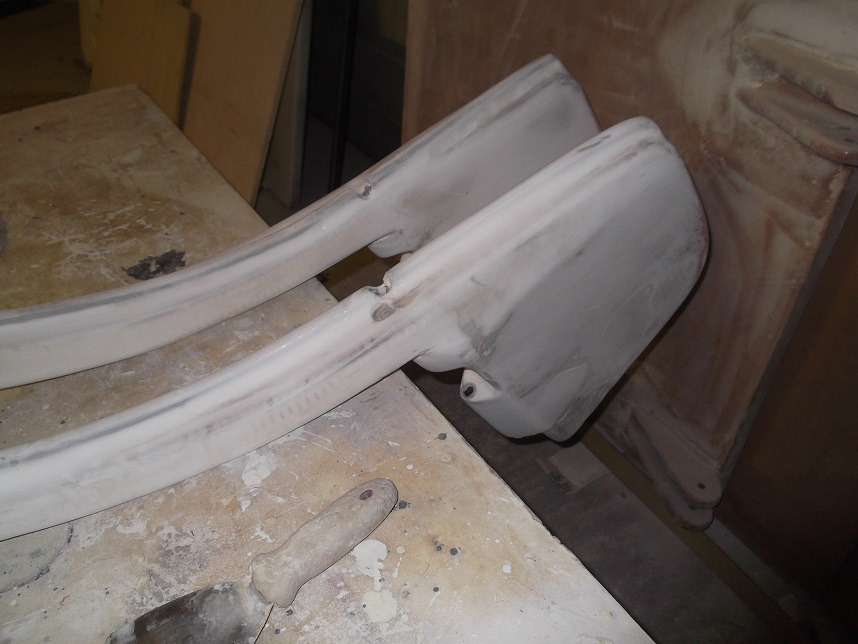

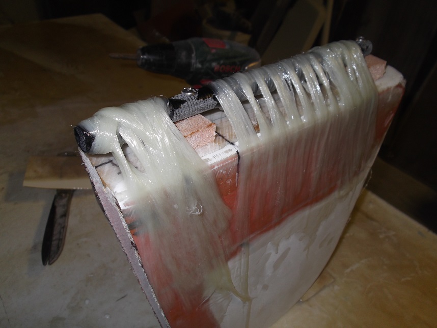

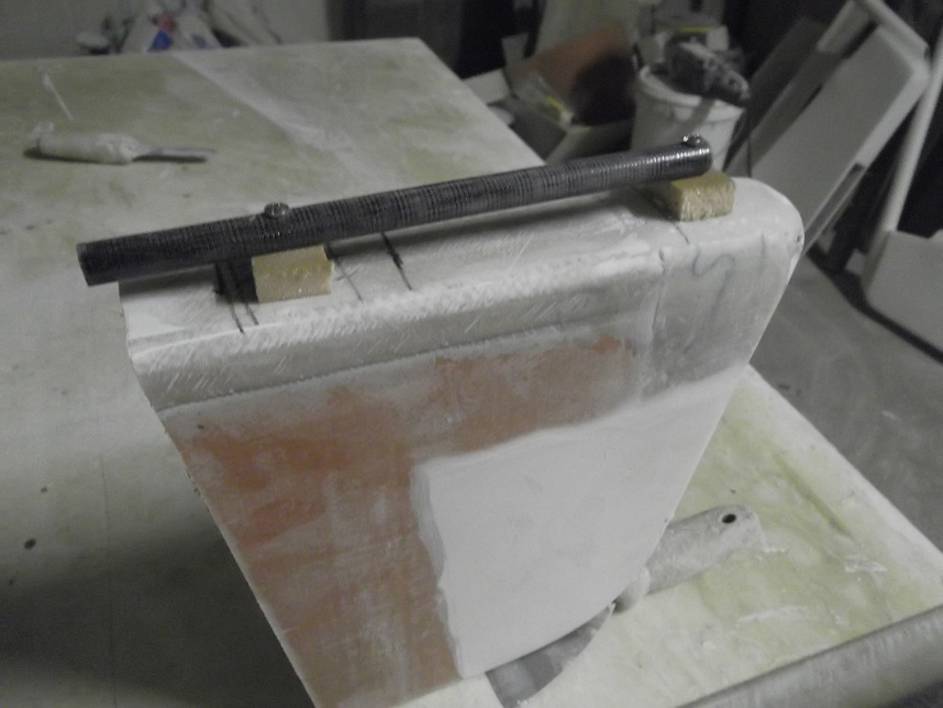

  5. catsketcher
    Joined: Mar 2006
    Posts: 1,306
    catsketcher Senior Member
    Gday Pax
    Composite gudgeons are funny beasts. It is easiest to make them by wrapping uni thread from one side of the rudder box to the other but I think that is the wrong way. There is little strength to stop the gudgeon splitting like yours did.
    I had the same thing happen to my small cat when the rudder box got hit by a sailboard. Looking at it again I realised it was easy to split.
    On subsequent boxes I wrapped each thread around the composite tube, looping it around the tube each time it went around the front of the box. It looked messy but is very strong and you then fill it with filler and a cover of a piece of fabric.
    Then the unis are spread over the side of the box.
    Good luck with the repair
    Phil
  6. catsketcher
    Joined: Mar 2006
    Posts: 1,306
    Here are some photos of the stitching holding the composite rudder tube on
  7. catsketcher
    Joined: Mar 2006
    Posts: 1,306
    And one of the rudder boxes after fairing
