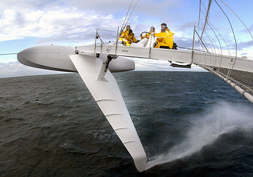

    Finally, impede the propagation of the air stream downwards along the span. It is done by placing one or more fences (plates) along the span of the foil.
    A single fence is used when the water surface is at a known fixed height. This is not your case, since wave motion can be significant in between the two demi-hulls of the cat, so you actually don't know at what point along the span will the foil pierce the water surface at a given moment.
    For that reason, a series of fences is IMO a better option. The first one should be placed some 10 cm below the still water line, and a couple of additional ones should be added down to the lowest expected water level along the centerboard span. Since the ventilation propagates along the suction side of the foil, it is sufficient to place them on the outer side of each of yor centerboards. In this way, there will be no mechanical interferences between centerboards.
    As an example of multiple anti-ventilation fences, see the hydrofoil of Hydroptere:
    This is IMO probably the most effective and simplest thing you can do to minimize the ventilation on your centerboard. In this CFD work you can visually appreciate the difference in ventilation levels between a clean foil and the one one with a series of fences: https://bib.irb.hr/datoteka/837663.Sorta2016-ventilation.pdf

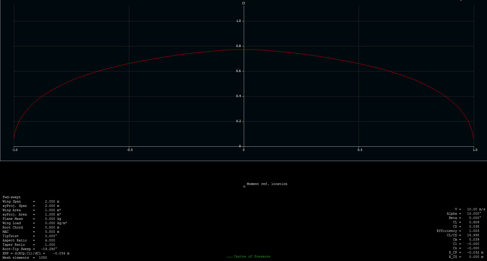

    IMO, you are correct that raking the board should have been added to the list. The reason why I didn't do it is that I don't have experimentally or field-proven data to support that claim.
    But it is a known fact from the general aerodynamics that back-swept wings have a reduced aerodynamic loading in the root area and increased loading near the wing tips. Conversely, the fwd-swept wings have increased loading at the root but reduced loading towards the tips. See these examples - same wing area, airfoils and spanwise chord distribution, different rakes:
    1) Straight wing lift distribution:
    2) Back-swept wing lift distribution:
    3) Fwd-swept wing lift distribution:
    4) Comparison of lift distributions for the above three cases:
    Both back-raking and fwd-raking chould be useful in preventing the ventilation.
    In other words, considering that centreboard root is the part which pierces the water surface, the above considerations mean that:
    1) back-raking gives a lower hydrodynamic loading near the water surface, which might delay the onset of the ventilation
    2) fwd-raking increases the loading near the water surface but decreases it towards the tips, which might help preventing the propagation of the ventilation.

    Why did hydroptere team place the fences only at the forward half of the foil? My guess is it comes from both CFD analysis and sea trials.
    Each fence is a wetted surface which increases the drag, so the number and extension of fences had to be kept to the minimum. Evidently, they have set their goals and have determined that the forward part of the foil is the most important one for the onset of ventilation, and for fulfillment of their design goals. :)

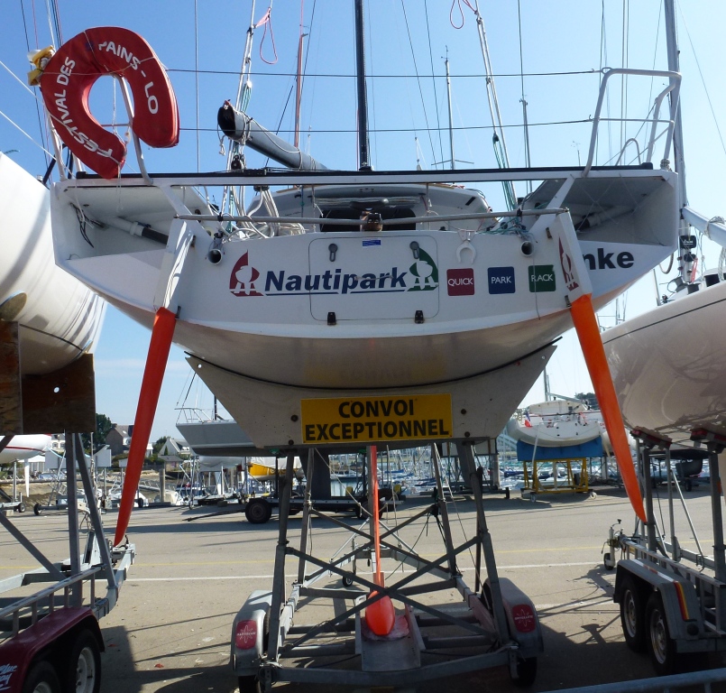

    I made dozens of rudders, as I was involved in racing. The cheapest and simplest are simply in laminated wood, covered with glass and a bit of carbon fiber. The good all around profile is the good ole symmetric NACA somewhere around 10%.
    For very hard racing on sport cats hyperlaminar profiles with max thickness around 35%, and sometimes turbulators but they are delicate to use, and ask for a total respect of the profile while making them.
    Plenty of small boats use successfully the TH rudder. Almost all the small French designs of the 50 and 60ties in hard chine plywood used the TH problem without problem. Easy to make, easy to maintain, cheap and efficient.
    All the racing dinghies and sport catamarans use it.
    The Mini Transat boats monos 6.5m, the best are able of 18 knots, and maintain average speeds of more than 7 knots during days while crossing the Atlantic, use TH rudders. The application of the Occam rasor and the TH concept seem to be efficient...:D
    Keeping it simple is the best way. It's just a small sport boat, so cost is an important factor. One TH rudder will be probably the solution.
    The kick up type like on the sport catamarans will be the most versatile solution for experimenting on profiles, compensation, angles, fences etc.
