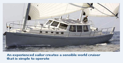

    We saw this one whilst sailing the Whitsundays
    Wylie 66
