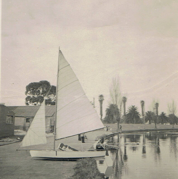

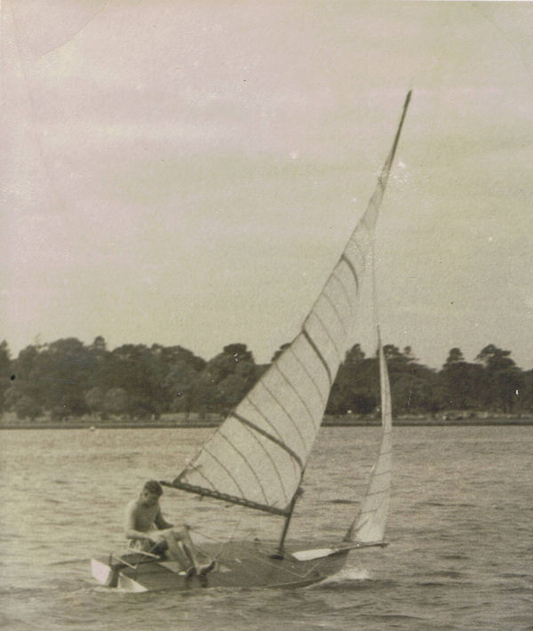

  10. Martin B.
    Joined: Aug 2013
    Posts: 29
    Likes: 2, Points: 3, Legacy Rep: 21
    Location: Mandurah, Western Australia
    Martin B. Junior Member
    Likewise, a little late on contributing to the VJ post but here is one I sailed on Albert Park Lake, Victoria; cotton sails with split bamboo battens (guaranteed to twist your sail out of shape), rectangular birdbath cockpit just about big enough for my 14 year old feet; paddle tied to bowsprit to assist one getting back to the YC as the lake was heavily choked with weed; very modern (?) durallium (aluminium) centre plate - previously they were galv steel !
    The rudder shape was typical of the class at that time.
    These pics were taken in 1954 on the day of the Aust Grand Prix on the normal roads around Albert Park Lake long before the current F1 Grand Prix Circuit was built.
    Hope your rebuilds went well and you are enjoying your VJs !
