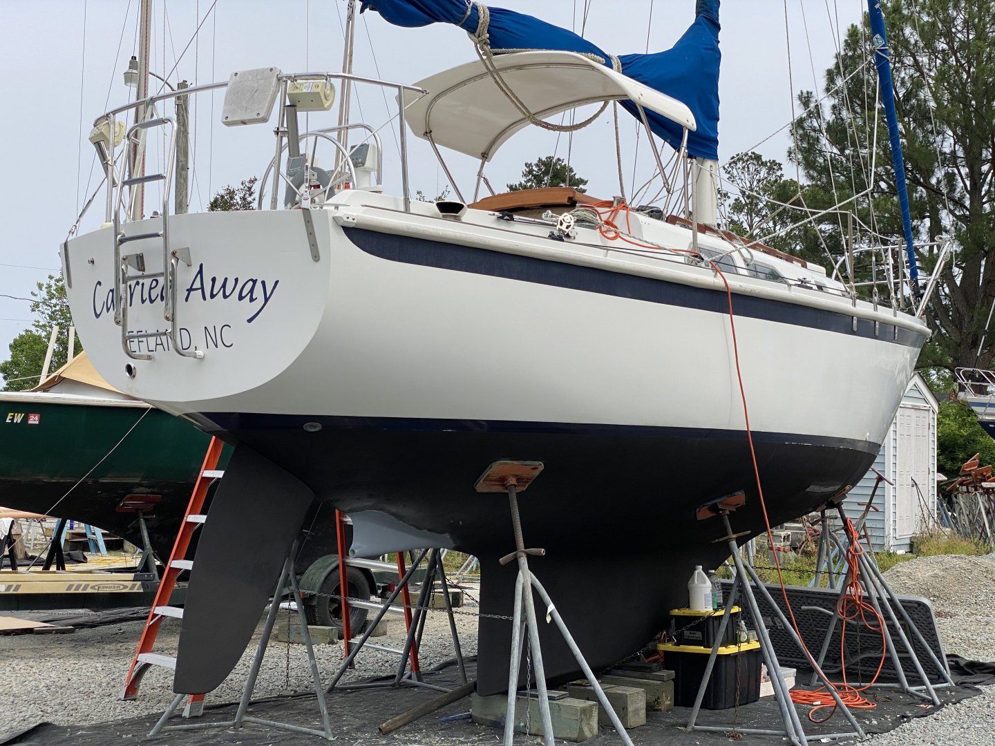

    The uniform barrier paint brings out all the flaws! But as a wise man once said, it's all turbulence back there anyway. Here is the the final profile with the rest of the boat in view. I'll be back down in another week to finish bottom paint, install cutlass, shaft, seal and connect it all up.

    @bajansailor I accommodated for both having a flexible coupling, and if that failed, being able to remove it and couple the shaft directly to the transmission. The later option leaves .5" clearance, and with the flexible coupling it adds another inch to 1.5". I opted for the bullet style zinc attached to a modified prop nut at the end of the shaft, and not the football style shaft zinc.
    This project has been a communal effort - your advice at the forefront. I also must give credit to the boat builder/surveryor who is rebuilding that double-ender in the background of one of the photos I posted, who suggested I use a sandwich core construction to the skeg. It is rock solid! And thank you!

    Make sure you have holes facing forward for water to run into the cutlass bearing. It needs it for lubrication and cooling.
