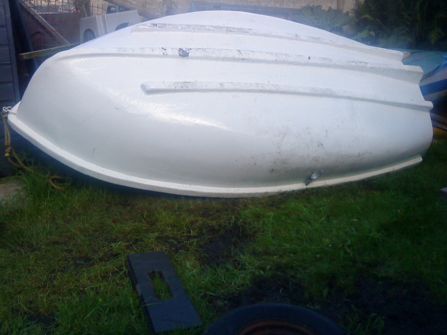

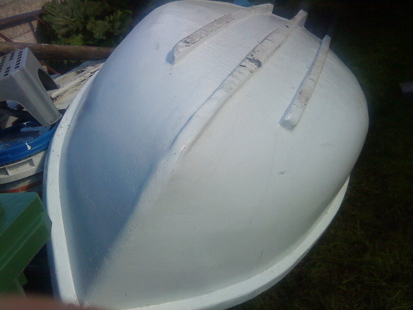

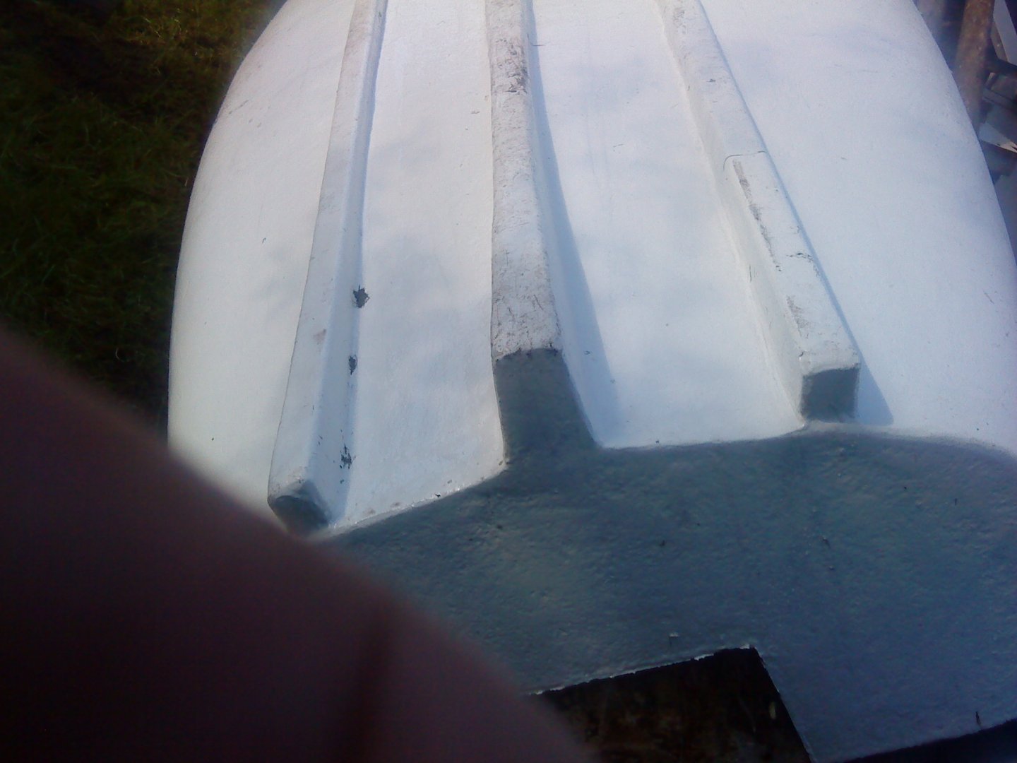

    Thanks for the suggestion,I can get hold of double glazing pvc strips that would be perfect.(window reveal strips)
    I am trying to avoid timber to keep the weight down.It's not exactly a warship,haha,but it's a tough little manoverable and stable boat.
    It rows effortlessly,and will turn easily in it's own length,and with a 6hp outboard on it it semi planes.
    I already have speedboat on my drive (Broom) so I need to get the rowing boat off the trailer and down a passage to store them both.
    I seem to have mislaid my pics of it on the pc somewhere,and it's got a deflated 9ft rubber dinghy on it covered with a sheet at the moment.
