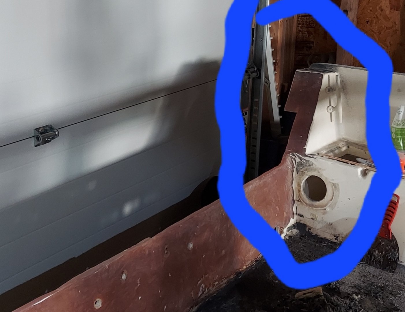

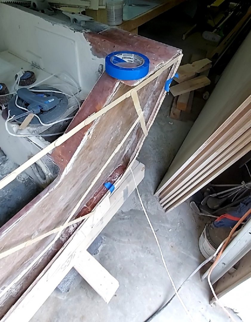

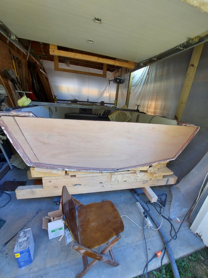

Can you explain the transom pictures a bit better?
Why is the transom thicker on the area behind the fish boxes?
can you take a top down picture for me?
I am a bit worried we are making a mistake here building back to the fish boxes. The engine loads need to transfer into the hull.
The fish boxes can act as gussets which is a good thing, but not if the transom is not contiguous across the back.
