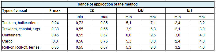

    Thank you. Do you know the limitations of this Holtrop method, meaning what are the boundaries of the hull parameters beyond which the calculations will become inaccurate? I thought I should make a check in my software to warn the user if his hull is outside what Holtrop was meant for. But I have not been able to find, definitively, what these boundaries are.

  7. laukejas

    Damn... I didn't expect that these ranges will be so narrow. Take Cp for example. 0.55 is the minimum..? Half of the sailboats/dinghies I ever studied had Cp lower than that. It appears that the Holtrop method is nowhere as universal as I thought. I guess I'm back to square one, searching for a better method :(

    It is clear that this method does not work, nobody had said, for sailboats / dinghies. Neither does it work, for example, for multihulls or gliders. As I said at the beginning, there is no valid method for the generality of hulls. There is no better or worse method than another, there is the right method for each type of floating object. Sorry.
