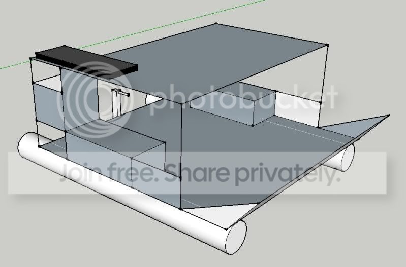

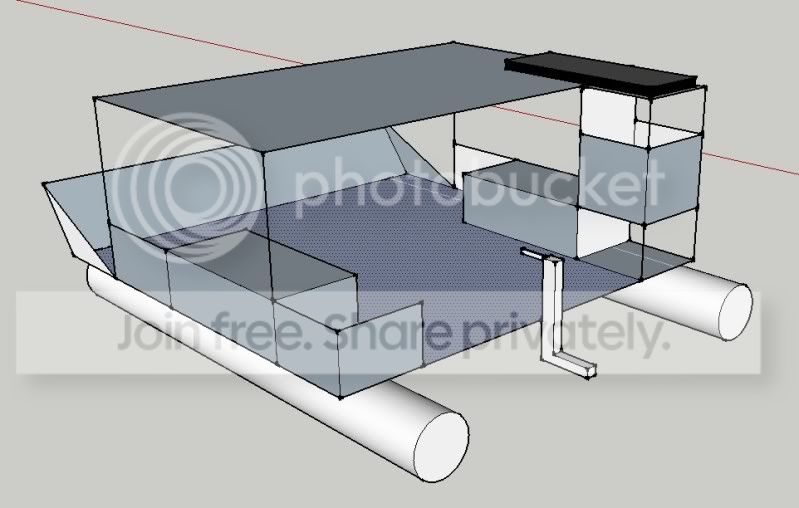

    I am in the planning phase of my trip right now, I was hoping some folks here could help me out with a question.
    I am trying to figure out what size motor to get. There is of course the issue to contend with anything over 10HP makes things more complicated with rules and also costs more.
    I was thinking 12 x 16 foot or 16 by 16 foot.
    For the larger raft dry weight is 630 lbs (including 30 gallons gas) without gear.
    I still don't have a finalized raft design, but here is a work in progress so far.

    Boy, Google Sketchup does rock, don't it? (Least, i guess that's what you used)
    :p
  4. ryan112ryan
    Joined: Sep 2009
    Posts: 2
    Location: Charlotte, NC
    ryan112ryan New Member
    Sure is! It is really amazing and so easy to learn. I was able to hash this boat design in under 15 minutes.

    Your Google design looks like a good start, a y2k rough draft - it will all come together for you - keep at it, do it!
    I don't know what rules you refer too, but a 25 hp minimum (and don't pass the inlet) seems logical for the formidable current (we did it with a 40hp).
    Some of the rules are basic enough to make good sense.
    bacshortly.com
    Its an awesome trip (whether you make the inlets or not)...

    We had a 9.9 hp on our raft, but as you can see we were on the small side. The 9.9 does allow you to slip in under the registration rules but it was barely adequate for the current down south. That required careful navigation and planning because there was no going back. The current was deceptively powerful and we had to plan way ahead for things...I would think that with something as large as you propose that 25hp or better would be a good idea. The important thing is that you must be able to maneuver. We had the option of rowing if the power failed but that was only good for going left or right, obviously there was no way to row upstream. But regardless of the size of engine you choose, there is no substitute for careful navigation and paying attention. Depend on common sense to keep you safe, not your engine.
