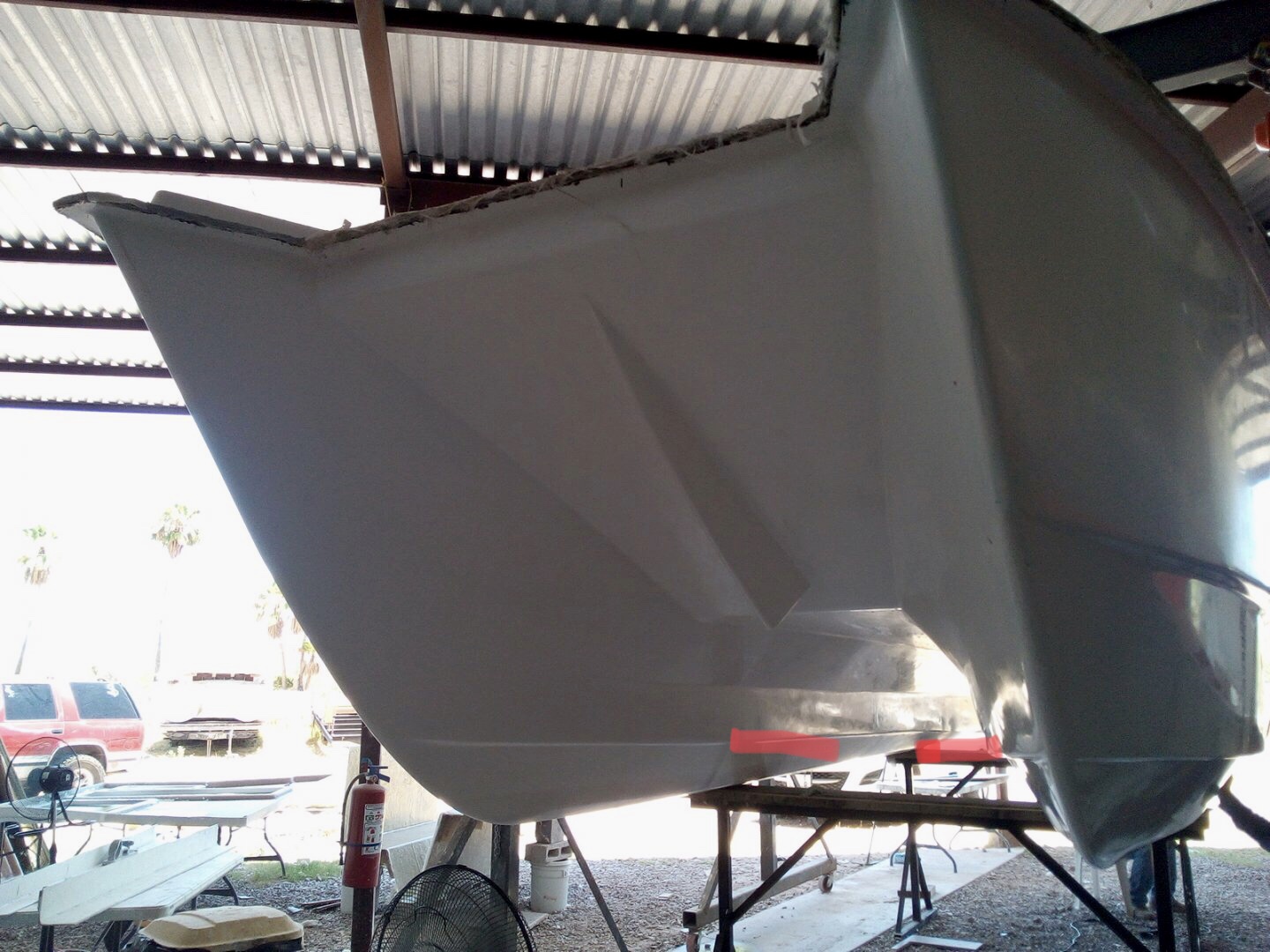

  10. kapnD
    Joined: Jan 2003
    Posts: 1,563
    Likes: 571, Points: 113, Legacy Rep: 40
    Location: hawaii, usa
    kapnD Senior Member
    “Too rough for fishing” is a nebulous term!
    Fishing time and ideal weather conditions often do not always fall in perfect alignment, and many fishermen are prone to brave bad conditions in order to catch fish. The boat needs to be capable.
    How about some assist foils?
    Or how about slicing the bottom off at the chine/spray rail thing and sectioning in a 6-8” flat panel ?
    The possibility of modifications like this really points up the beauty of FRP !
    Some stability calculations would help determine just how much height is needed to float the boat higher for more bridge clearance.
  11. kapnD
    Joined: Jan 2003
    Posts: 1,563
    kapnD Senior Member
    6A576C89-10DC-43A6-969B-B0C98CC5F296.jpeg The red marks indicate the location of the forward foils.
    Not a very good markup, but maybe you can get the idea.
    Same at the stern, or possibly one foil spanning between the hulls.
  12. Bullshipper
    Joined: May 2008
    Posts: 159
    Likes: 7, Points: 18, Legacy Rep: 21
    Location: Mexico
    Bullshipper Bullshipper
    Thanks for sticking with me on this.
    I looked at some technical stuff on the center foil and rear fins and thought about it as fixing a heavy hull is probably the foils best application. The Hysucat foil cats and RIBS well designed but are also being built very light with their 25 footer CC coming in rigged around 4700 lbs, and their sponson design and highly canted motors are also a lot more stable at speed with a wider tunnel bottom than mine. And all their videos are on glassy water, and I have found that the foils tend to hold the bows down in large following seas producing bow steer
    So stability concerns me and throwing more money at a bad hull are not prudent at this point, as she will underperform the competition because she will still be overweight with or w/o foils.
    I calculated last night that I can reduce the 8120 lb rigged hull to 6050 using my existing molds if I go to 1.5+.75 oz mat+2 mm coremat+1710+3610 for the sides and one more 3610 for the bottom versus using the extra heavy rovings available here in Mexico, where I also applied way too many layers of this thick knotty roving. The thick roving also sucks a lot more resin to wet out and the 1710, so I have made the decision to strip this one, make another hull to assemble again, but weigh the materials prior to application.
    I have owned 4 cats and this is by far the best of the bunch in conditions to 3 feet, but I do not want to compromise the design after 3 years plugging away during retirement. It will take me less than 4 months to build the new one, and labor is inexpensive where I am.
    Thanks again for your valuable input.
