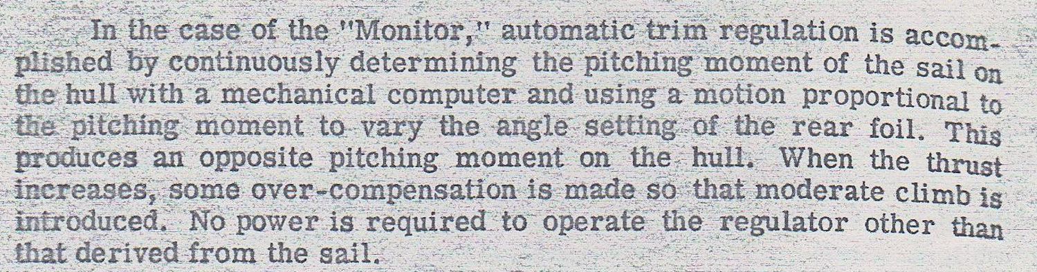

    Quite an amazing guy. It is hard to believe the speeds they hit back then -with wood cotton and steel for materials! I was also amazed to read that the foils were "computer" controlled. I can't imagine any way that could be digital so there must be a reasonably simple analog computer able to handle the task. And all it's inputs are forces! Analog 'computers' all have mechanical equivalents.
  5. Doug Halsey
    Joined: Feb 2007
    Posts: 508
    Location: California, USA
    Doug Halsey Senior Member
    I second your amazement & would also like to know more about his "computer."
    Some hints are given in a paper written by him, available at :
    https://babel.hathitrust.org/cgi/pt?id=uc1.$b672020;view=1up;seq=251
    I've excerpted one paragraph below (Click to enlarge).
    Since this research was sponsored by the U.S. Navy, it's possible that some more diligent Googling might turn up more details.

  14. Skyak
    Joined: Jul 2012
    Posts: 1,203
    Location: United States
    Skyak Senior Member
    This patent document does a pretty good job of detailing the flight control "computer". All the stays and even the main sheet forces are applied to a space frame that is linked to the hydrofoils angle of attack. It appears to be nothing more than an elaborate spring and damper, but there is one add I still don't understand -it looks like a propeller on a drum (don't know what's inside) on a four bar mechanism. I want to know if wind power is being used for 'active control' or if the entire Monitor flight system is just force/deflection. Clearly the steady state can be worked out to force deflection, but I wonder about dynamic responses or running into nonlinear responses.
  15. Doug Halsey
    Joined: Feb 2007
    Posts: 508
    Are you referring to the last figure (Fig.14, Sheet 10)?
    If so, the text says " Fig. 14 is a fragmentary schematic view illustrating the manner of incorporating the incidence adjustment in a boat driven by an air propeller." So, it doesn't apply to Monitor itself.
    I'm not a mechanical expert by any stretch of the imagination, but I'm pretty sure that the system is just force/deflection.
