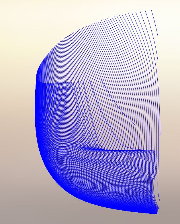

    I think you're doing well. It's totally normal, if the hull is not smoothed, you should see lumps like the one you have on the left-hand frame.
  2. Proflooney
    Joined: Nov 2016
    Posts: 66
    Location: Moline
    Proflooney Junior Member
    Ok I got the station curves all in they are pretty screwed up so gonna take a while to get them figured out
  3. Heimfried
    Joined: Apr 2015
    Posts: 576
    Likes: 153, Points: 43, Legacy Rep: 37
    Location: Berlin, Germany
    Heimfried Senior Member
    The lines you show in #15 don't look like lines of a boat hull at all. And the indicated axes of coordinates (y,z) are not used in the common way.
    May be you should take a bit more time to compare the drawings of the boat and the offset table to understand the relation better.
    Edit: I didn't see TANSL's post #16. He is much more experienced than I am.

  5. TANSL
    Joined: Sep 2011
    Posts: 8,002
    Location: Spain
    TANSL Senior Member
    The pictures in post # 17 may well be the cross sections of a ship, although there are many shortcomings and probably not well located in space. But I think the OP is laying the correct groundwork to start a "fairing" job, which will certainly not be easy.
    Mr Efficiency, no need to call Houston, a simple loftman will be a much better help.

    The y,z coordinates of station 7 fed in a web tool to create cubic splines are showing a fair curve, not a curled one.

    Yes those lines look a bit lumpy. I would be inclined to take any sketches/photographs of the hull and loft it from scratch. From there you can optimize the curves, run your stability & resistance checks on it, etc. until you achieve the performance you like.

    yes I was just entering the curve tables from the offsets and those are the lines. I havent had time to check all the lines and the views above were taken in perspective some curves are fine while others very lumpy. plus I dont like the way they sit I want to do up the hull but since im so new at boats I wanted to try with the offsets table first

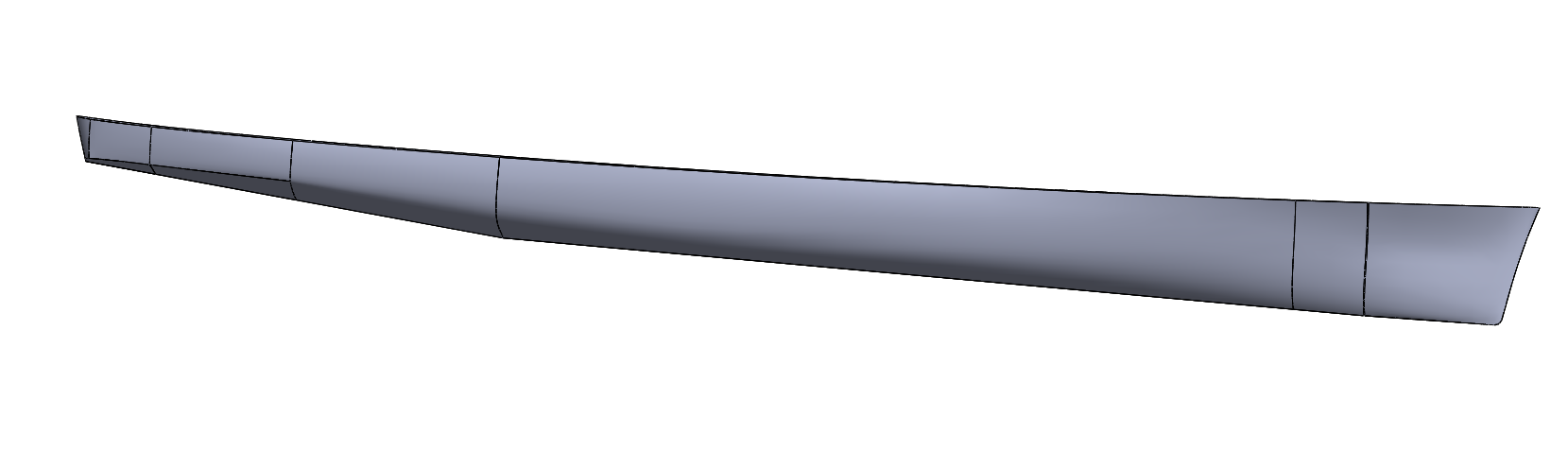

    Now here was my Fletcher Hull using the Offsets I also did the SS United States with offsets. so normally I been doing good learning how to use them but this little boat seems FUBAR. I even tried delftship but that prog doesnt like me at all rofl. I figured this would be easy to do and I could make a boat out of it by spring to take grandkids radio control boating but right now doesnt look like it.

    Here is what I did last night before generating the curve txt files.
    I too the data from the original and reorganized the table to be more like I am used to seeing.
    Now Solidworks needs the coordinates set up the Following way to generate the curves Properly:
    Station Waterline Offset
    I just need to put a space between each and stack them for each station and each station needs to be a separate txt file. to the right of the table I have them set up as individual stations and I just copy and paste the data into notepad.
    I am just thinking the offset table data is way out of whack and when they laid down the hull and fixed any errors it didnt get adjusted in the offset table

    Ok I just finished tracing all the lines from the lines drawing sheet and saved them to DXF format after enlarging them to full scale. Now I will try to pull them into Delftship and see if I can figure out how to adjust everything to match without getting some crumpled paper again
