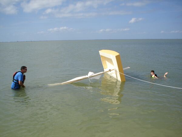

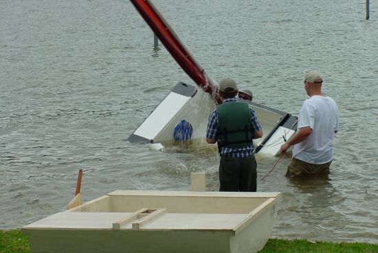

    Yes, but I'm thinking wooden hinged doors to keep water from sloshing in. I don't think they would need to be water tight but maybe a bit of weatherstripping wouldn't hurt.
    I have to say this really puzzled me when I read it. Then I realized that you haven't been sitting around thinking about building a PDR so you might not be looking at some of the things. Here's a picture of a boat with side tanks being righted:
    Looks good. It floats high and you don't get water inside when you flip it back up. Unfortunately those side tanks are 7" each. And, I don't really want to reduce the cockpit to 34" wide. Now, here's a boat with end tanks:
    Yeah, that looks like it is half full of water. I was thinking that if I extended the tanks at an angle down the sides I could reduce that somewhat. I actually think I can cut that in half. You can also see that without the access hole cover he would probably be getting water in the tanks.
