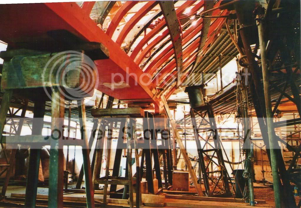

    here is a yacht we restored, 1931, teak on rock elm, Camper & Nicholson, 45 tons
