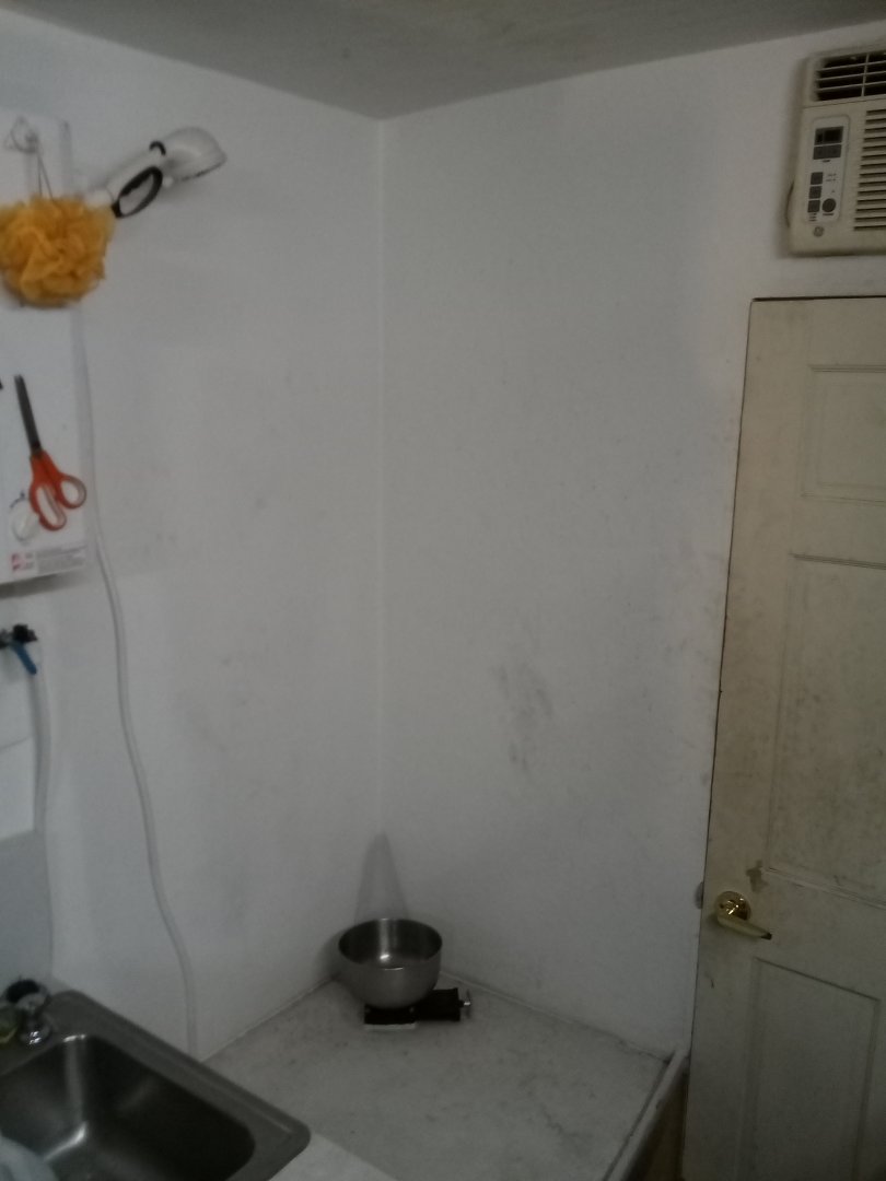

  6. Jgfmobile
    Joined: Mar 2021
    Posts: 20
    Likes: 0, Points: 11
    Location: Florida
    Jgfmobile Junior Member
    By the way, it showers really good, no curtain at all!
    --- note the 'bondo with glass' making up a nice drain in the corner there!
    The VE is insane compared to the PE. VE sticks so hard its crazy, and its super stiff and strong. I have some on the outside of a cracked plastic motorcycle gas cap ... It still sticks!
    This method of painting over the poly worked fine, but just because i cured it for so long and so hot. Before that it was sticky, but once cured you can tell,because it scratchy with your fingernails.
    I also razor attacked and hammered every spot on the tank. It needs to sound like a tank!
    So far , so good!

  8. Jgfmobile
    Joined: Mar 2021
    Posts: 20
    Location: Florida
    The bendy thing is a tank rinser. It has holes in it. Its PEX. Its sealed in with through hull sealant or whatever its called .... The below water level silicone like stuff.
    I made the drain into the 3 inch with about 3 layers of matte and VE. Its strong as hell. It wasnt too hard. Just be sure to let it melt the matte first, and then its easy to manage.
