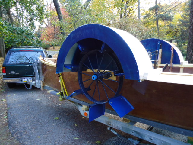

    A few suggestions:
    12 floats is OK, and I would use a slightly smaller wheel diameter, such that the inside diameter of the floats are not submerged. 12 floats you currently have is OK
    Your engine gearing is too slow, design for about 70-75 RPM of your wheel, based on about 44 inches outside diameter. If your boat weight is less than one ton (2240 lbs), then you can get about 5 knots with plenty of power to spare using your IC engine. Floats should be cupped for ideal drag through the water (this is desired), and typical lunch trays, cut in half, are close to ideal here. I have found typical centrifugal clutches slip and overheat when using a typical HF IC engine, and a belt clutch with an Idler engagement is recommended here, Plenty of snow blowers use this setup, go to Home Depot and have a look.
    During the era of USA sidewheelers (1840 - 1920), virtually all of them used a single cylinder steam engine, and the engines had to be stopped and started with the engine NOT at top dead center and NOT at bottom dead center. Virtually all of them had both wheels on a single shaft, perhaps one in a thousand used independently driven paddle wheels. Yes, with independent wheel control you could turn on a dime, but they just were not built that way. As to disc wheels with the floats mounted between, I guess that would work OK, but again, they were just not built that way, so during the nearly 100 years of evolution for the sidewheel propulsion, disc type wheels evidently provided no significant advantage.
    The Margaret S uses 14 floats, 8 inches deep x 12 inches wide on a 44 inch outside diameter wheel, 28 inch inside diameter.
    For better propulsion efficiency, the floats should have a somewhat cupped shape, to increase their "Coefficient of drag" when forcing through the water. I used 12 x 16 fiberglass lunch trays, cut in half to make 8 x 12 floats, with the un-cupped edge at the outer radius. With this configuration, at about 70 RPM and 2 horsepower will get about 5 knots. This is pushing the real limit of "Hull Speed" for a displacement boat, and increasing beyond this limit is not practical.
    The paddle box covers are needed or you will be soaked real good, the first time I ran the Margaret S with none, I had about 500 pounds of water thrown into the boat while traveling about 100 yards.

    "floats should be cupped which way?"
    ANS: As the float passes into the water, the cupped shape increases drag, and the wheel propulsion is more efficient with increased drag.
    What drag are you trying to reduce?
    ANS: Not trying to reduce drag, higher drag coefficient is desired. More drag = More Force = Pushes Boat forward.
    When the float is in the water don't you want the max force produced?
    ANS: Yes want maximum force on float, with minimum slip. This is accomplished with high drag coefficient.
    Which drag are you talking about?
    ANS: As the float travels in the water it is traveling rearward faster than the boat hull is moving forward. Thus there is relative velocity of float moving through the water, forcing the water rearward, with resulting force on float in the forward direction.
    The attached picture shows the lunch tray orientation, cupped trays have higher drag coefficient = more thrust
    This picture shows wheel with only 7 floats, later doubled up on these (14 floats on each wheel) for better propulsion.

    "You won't get speed with a small high speed wheel, unless you have power to spare. Extravagant amounts of extra power."
    This is true, however the hull we are discussing will be limited by displacement speeds, about 5 knots, and that will require only about 2 horsepower to reach hull speed. From that perspective, the 6 horsepower HF IC engine does have "Extravagant amounts of extra power".
    "If you want you to go as fast as possible with little power, bigger wheels."
    This is also true, as bigger wheels will enter and leave the water more closely approximating the horizontal motion, which is the more ideal vector for propulsion. However big diameter wheels lead to more windage problems, larger paddle boxes, and significantly more wheel/paddlebox construction difficulty. Based on these considerations, IMHO the boat being discussed here should settle on wheels with about 44 inch outside diameter, maybe a little less. In boats everything involves compromises, and settling on the "best" compromise(s) is always up for discussion.
