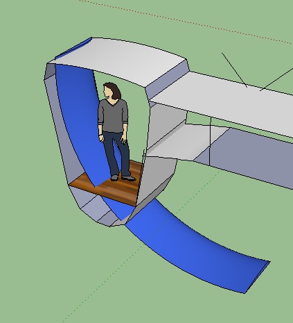

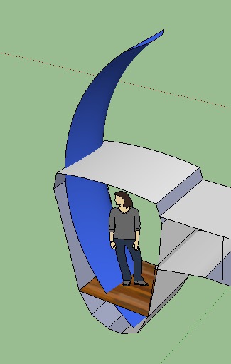

  5. groper
    Joined: Jun 2011
    Posts: 2,467
    Location: australia
    groper Senior Member
    Otherwise - the approach taken by Biekers design of Fujin- to simply leave all pitch damping for the rudders and solve those engineering problems. Then, the main foils can revert back to combined lift and leeway, why not move to uptip foils instead of C foils? This render shows uptip foils exiting just above the static waterline - in this way they are free from marine growth problems both in the trunk and on the boards once retracted, are vertical, dont impinge too negatively on the interior space, and damage survivability is better if exiting above static waterline. When the boat is pressed, they would exit slightly below waterline. They could be positioned such that they lift the boat with a slight bow up trim if the CoG of the boat and rig forces are accurately accounted for, ideally with rake control of both the rudders and boards.

    You'll lose a bit with the free surface effect but as the support is straight and vertical, foil depth is not a problem.
    Solves a lot of the problems particularly with internal space but is not removable from the top.
    At some point you'll have to decide how much lift you want and at what speed. :)
    Skyak? noted earlier that if its only partial foiling the keel should be v-shaped to soften re-entry.

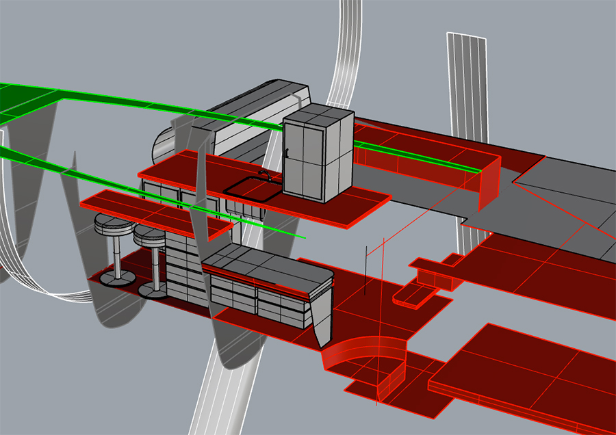

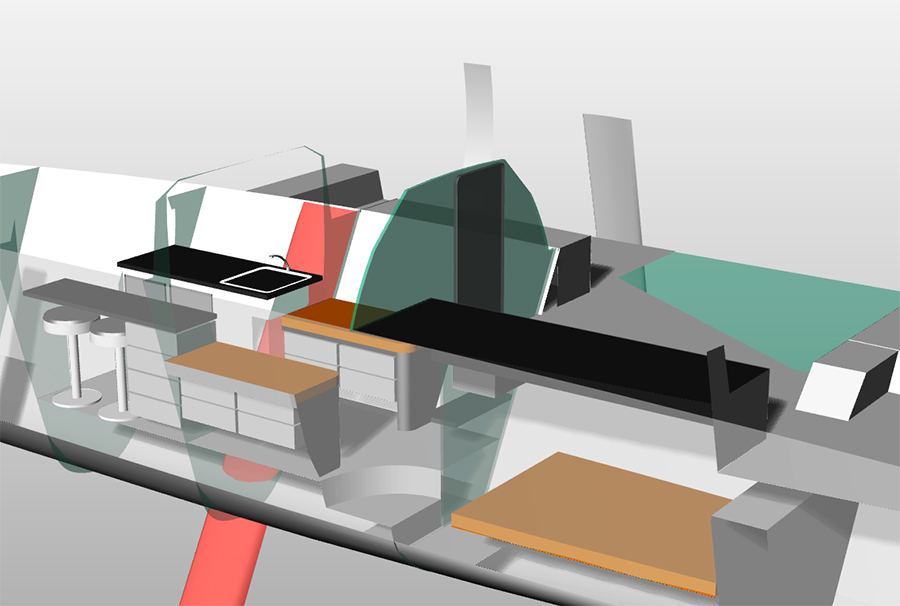

  7. jorgepease
    Joined: Feb 2012
    Posts: 1,614
    Location: Florida
    jorgepease Senior Member
    I don't know how to design this interior. We are so far apart in our visions lol ... just to show you, even with a reduced size custom fridge and freezer you have a little less than 2 feet of space in the galley. That would drive me crazy, it's driving me crazy just looking at it. :eek:
    I think if I was going to build a boat like this I would make it one level, put a bench for the aft bed, put a bench to set a hot plate and small sink. I would build a custom freezer fridge under this bench because a regular fridge won't fit. As it is, I had to move the foil tighter to the hull but you still need the cassette.
    The two entry benches would be really small 14" max or just get rid of them, who is going to use them anyway, you will be outside most of the time otherwise in bed. I would wall off a space forward for the head and add some open racks to store non perishable goods. That's it, keep it to bare minimum.

    for Jorgepease: First impression is to replace the inboard bench with a counter and the refrigerator top is placed at eye height over the counter.
    the inboard bevel in the coachroof seems rather large. Possible make the inboard bevel much smaller to provide a touch more internal space?
    Is there enough space inboard of the door for a wet locker?

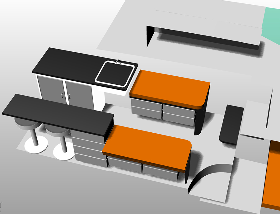

    can get rid of that bevel completely actually, it does no good. Is this what you mean about fridge, put it on counter? I think a custom cooler box, can be up like this, 15_19.jpg would be best for this boat. Get the most storage space possible out of it rather than rectangles.
  11. groper
    Joined: Jun 2011
    Posts: 2,467
    Location: australia
    Yes - fridge and freezer up on the counter top imboard side is where i had them in my concept. They sell pigeon pair units like this in the big department stores for approx $350aud each here. Custom fridge units are way too $$$!
    You need to keep roof line tall enough to fit them like that- my original coach roof had just enough space for them...
    First thing closest stairs can be simple seating - no need for benches there... fold down bunk perhaps?

    how asymmetrical is the hull at hip height - standing in the galley? Here is the SIG 45 for reference
  13. groper
    Joined: Jun 2011
    Posts: 2,467
    Location: australia
    About this assymetric...
    The raised floor level you can see is the galley section midship.
    The floor width hull skin to hull skin is 1.48m at this level.
    The height floor to ceiling in this area is 2.05m - plenty of room for benchtop fridge and freezer which are 850mm tall and sit on the 900mm bench height. No bending over to get things from the fridge!
