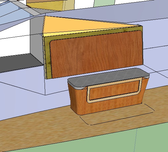

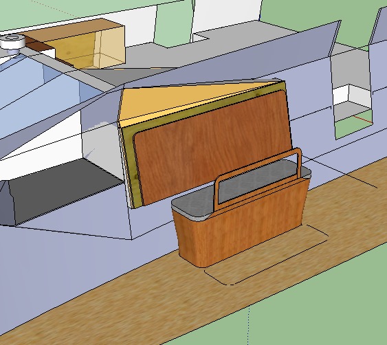

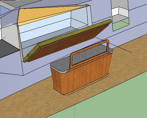

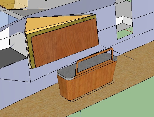

  7. UpOnStands
    Joined: Nov 2015
    Posts: 681
    Location: Sydney
    UpOnStands Senior Member
    this is one idea. 1.9m long by 70cm wide cuddy projects out over the bridgedeck and provides seating. On the inside, the other 70cm half of the double bed folds up against the hull and the table folds down. The bench seat provides support the bed and seating for the table. Yes the mattress is split.

    Is the base a seat with the backrest flipped/
    A Washing Machine for dishes or clothes. I always take my clothes into the shower with me :p lol. If you mean for dishes I agree, just a drawer size one is all that is needed.
    Yeah sq footage will be more for sure, also you don't have a BD or Roof, but on the hulls, yours are actually 2" taller at the bows and only about 10" narrower. With my costs for materials a little more than 50% less than yours, I should come out way under. I will try to get the materials list to be sure.
    By the way I got rid of the glass and the aft salon bulkhead making it much more open and added a simple structural support for the roof for the unstayed mast. I like it better! Will try to get renders tomorrow.
  11. UpOnStands
    Joined: Nov 2015
    Posts: 681
    Location: Sydney
    The bench is a freestanding object.
    The idea is that when the bench (base) is stowed the backrest is dropped down (flipped) so you can sit on the bench (facing outboard) without having to turn the bench around. Does that make sense?
